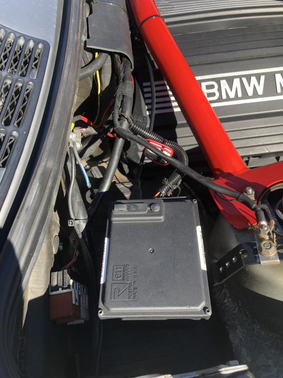

          Got around to installing my stereo.
          • Head Unit: Alpine UTE-73BT
          • Amplifier: MB Quart NA2-320.4
          • Speakers:
            • Tweeters: Dayton Audio ND25FN-4 1" Silk Dome Neodymium with 13 µF Capacitor as a 1st order High Pass Filter
            • Mids: Good ol' factory BMW premiums but plan to upgrade in the future
              • Had to rewire the front speakers as the touring had the grounds shared for the left front & rear and also for the right front and rear. So I ran a new pair of +&- to both front speakers and used the factory wiring for the rear speakers. That way each channel can be tuned individually and correctly
            • Subwoofer: Rockville RWS10CA Slim 1000 Watt 10" Self Powered​
          I'm really happy with it now, it sounds great, I'm always blown away at what a cheap sub can do for a factory stereo system.
          Click image for larger version  Name:	IMG_8592.jpg Views:	302 Size:	60.2 KB ID:	10071890
          Also printed & installed the cargo cover mounting brackets, yea they are purple right now, but I just wanted to see if they worked before changing the filament in the 3D printer. The file for the brackets can be found here: Touring Dog Net Blind Bracket Holder for BMW vehicles
          Click image for larger version  Name:	IMG_8593.jpg Views:	276 Size:	55.1 KB ID:	10071891 Click image for larger version  Name:	IMG_8589.jpg Views:	276 Size:	67.2 KB ID:	10071892 Click image for larger version  Name:	IMG_8591.jpg Views:	273 Size:	64.0 KB ID:	10071893 Click image for larger version  Name:	IMG_8590.jpg Views:	276 Size:	68.2 KB ID:	10071894

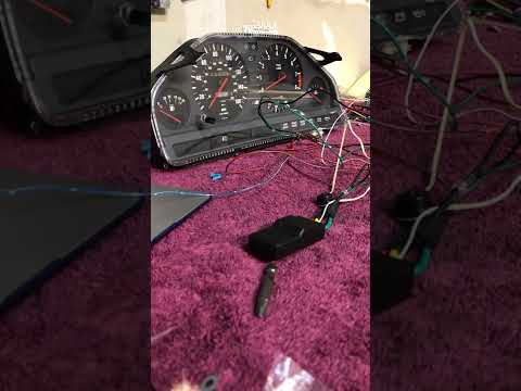

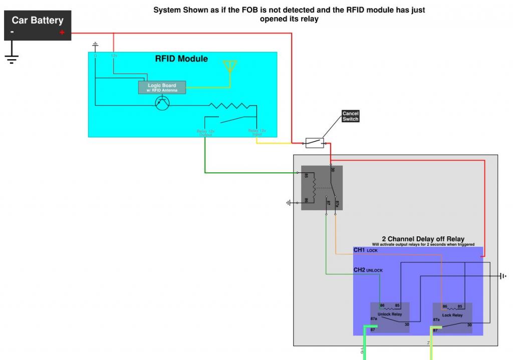

                Last night I installed the RFID module for my proximity unlock/lock project.
                Click image for larger version  Name:	IMG_8603.jpg Views:	0 Size:	52.8 KB ID:	10072005
                Here is a basic EWD of how the system will work.
                Click image for larger version  Name:	Auto Lock Unlock.jpg Views:	0 Size:	45.2 KB ID:	10072054
                Current Builds
                1989 S52 E30 Touring | The Grey Athletic Shoe
                1993 Toyota Landcruiser | The Trail Snail
                • Sledgehammer_01
                  • Aug 2022
                  • 66

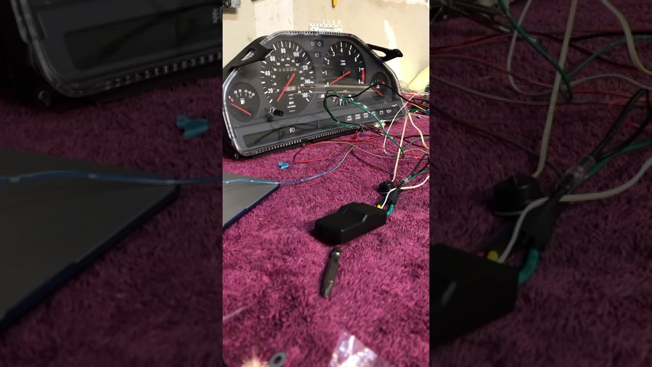

                  Well, the keyless entry and locking system is in and working.
                  and here's a couple of videos of it in action
                  https://youtube.com/shorts/dUBDhrDcU4I?feature=share

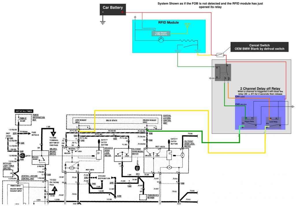

                    Some follow-up on the keyless entry & locking, it's so simple you could probably do this on most cars. And the RFID module can be used for so many things.
                    Links to what I used to make the keyless entry:
                    $27 | RFID Relay
                    $16 | 2 Channel Time Delay Relay Module
                    $11 | Small Project box (to house the 2-channel module)
                    $6 | SPDT (single pole double throw) 12v relay - I used a mini SRD-12VDC-SL-C because I had it sitting around, but you could use any common automotive 5 pin relay.
                    And here's the EWD:

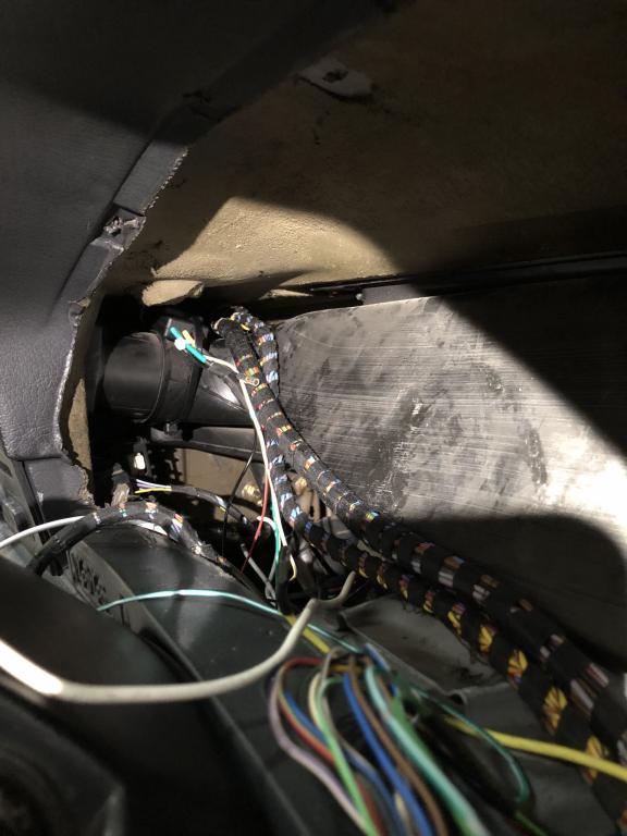

                          Tonight I installed the puddle lights and red LED interior door handle accents (took the idea from my audi). The puddle lights were actually pretty easy, they install inside the door all you have to do is knock out a plastic drain plug and voila you have the perfect-sized hole for the puddle light. My cell phone doesn't do it justice and Im too wiped out to break out the DSLR so this is the best I could do.
                          Also got the Rostra cruise control installed using a factory stalk.
