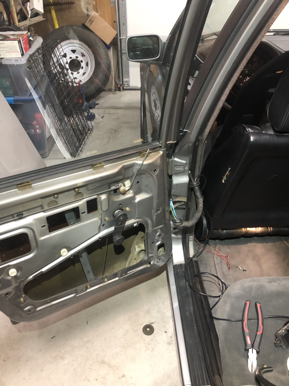

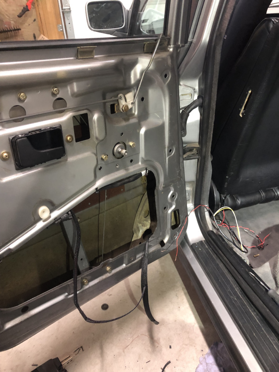

          Tonight I pulled a 4 pair wires through the rear doors wire pass, two of which got wired to the M/// puddle light and the other two for the door handle pocket red ambient LED (on when parking or headlights are on). Then one of the cargo cover mounts broke so I bought a 3d printer and printed a replacement... because that made the most sense... Lastly, I fixed the busted fuel sender unit in the tank, which was a lot less difficult than I thought it would be.

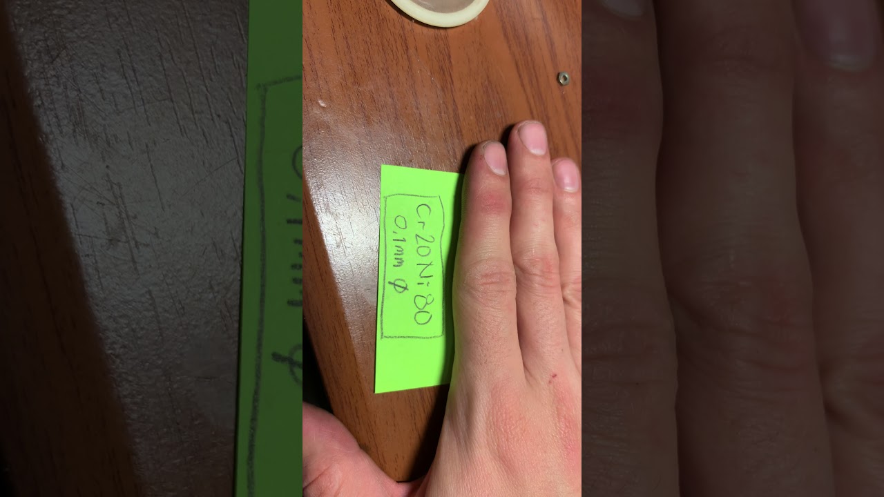

            Broken Wire
            Click image for larger version  Name:	IMG_8955.jpg Views:	4 Size:	174.0 KB ID:	10078923
            Ran a new wire with some Fielect Heating Element Coil Wire / Resistance Wire Cr20Ni80 0.1mm wire I got off Amazon for $7.86 and IT WORKS! Saved me 2-3 hundo
            Click image for larger version  Name:	IMG_8958.jpg Views:	4 Size:	120.0 KB ID:	10078921
            Click image for larger version  Name:	IMG_8957.jpg Views:	4 Size:	182.9 KB ID:	10078922

              That's a great fixin! So many broken level senders out there.

                Can you fire that level sender fix into a post in the DIY section or something? I know I'm going to need this next year and I'll struggle to find it again haha

                  I put off dealing with the level sensor because of how big of a job I anticipated it to be when in reality it was so easy and fast that I shouldn't have been worried.
                  Unfortunately, I didn't take enough photos for a DIY post, however there's an excellent youtube video detailing the entire process that I followed. If you know how to solder (or want to learn) its a pretty easy job, just order some 0.1mm Cr20Ni80 resistance wire from amazon watch the video and get goin!
                  One point to add to the video: I spun a loop in the end of the wire to hold it on the hook then ran it around the end post and pulled it back to the vice where I secured it so it was holding some tension while I soldered it on. After it was soldered I unspun the loose tail and clipped it off.

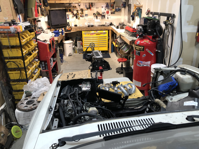

                      Bout to finish up this long block and stab it back into the car... I'm so ready to have this client's car out of my garage!

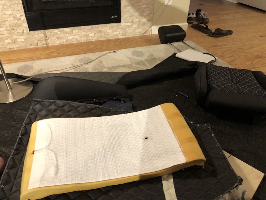

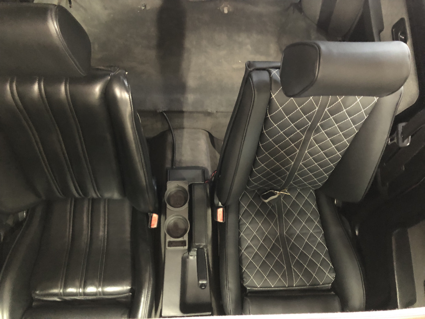

                        Since all of that was going so well and fast I figured I'd take on reskinning the driver's seat, adding heated seat elements, modeling & printing some footwell LED light shields.... 12hours later I accepted that things spiraled out of control, everything had to be perfect so all the parts got ultrasonically cleaned, the slide rails got repainted... etc etc..
                        BEFORE (its hard to see all the cracks in the seat base because I colored them in with sharpie.)
                        Click image for larger version  Name:	IMG_9108.jpg Views:	13 Size:	166.9 KB ID:	10081055
                        I steamed all the foam to bring it back to life then installed the heater elements
                        Click image for larger version  Name:	IMG_9109.jpg Views:	14 Size:	211.1 KB ID:	10081054
                        Took 12 hours for one seat, which included cleaning everything, repainting the sliders, ultrasonic washing the seat belt receiver (was sticking), steaming the foam, installing new gas struts, and wiring the heaters, switches, & footwell lights but it was worth it.
                        Click image for larger version  Name:	IMG_9114.jpg Views:	12 Size:	212.3 KB ID:	10081056
                        Click image for larger version  Name:	F0C5A064-F9B6-42F1-9C6D-807DBF3F3EBE.jpg Views:	13 Size:	238.9 KB ID:	10081058

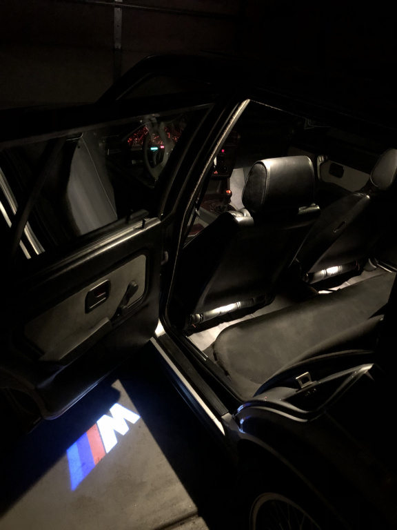

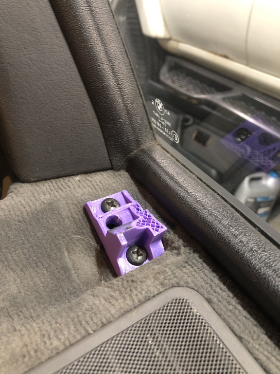

                          I wanted to add rear footwell courtesy lights and red ambient lights that come on when the parking or headlights are switched on. I used the old seats as a proof of concept by wiring in these LED's, just double side taping them to the bottom edge of the rear seat cover facing down towards the carpet, which worked well but from some aspects, you could see the LEDs. So I created a little shield to prevent the source of the light from being visible to anyone.
                          Here are the products I used:
                          Prewired RED Surface Mount 2835 LED
                          Prewired WARM WHITE Surface Mount 5050 LED
                          12v PWM Dimmer (for full brightness control over the Red Nighttime LED's)
                          WiFi Dome Light Timer, Dimmer, Fade Controller (for courtesy lights when doors open)
                          Prewired 6-Pin Wire connectors (connection from car to seat)
                          I'll need to bust out my DSLR to get proper night shots of the interior lighting now, but take my word that it's phenomenal. Little subtle modern touches like this make the car so much more of an enjoyable place to spend time while not ruining the purity of the car's heritage.
                          Click image for larger version  Name:	IMG_9110.jpg Views:	0 Size:	225.4 KB ID:	10081065
                          Using some black high quality superglue I attached the shield to the base of the seat back.
                          Click image for larger version  Name:	IMG_9111.jpg Views:	0 Size:	179.9 KB ID:	10081064
                          because of the way the white and red LEDs are controlled, they need their own independent + & - runs, so instead of custom-making my own paired wire I just repurposed a low-loss ethernet cable which (outside of being a pain in the ass to solder because of the tiny wire gauge) worked just fine. The gauge of the ethernet cable is just fine to handle the low amp draw of the LED's for this short of run.
                          Click image for larger version  Name:	IMG_9113.jpg Views:	0 Size:	235.9 KB ID:	10081066
                          Click image for larger version  Name:	IMG_9132.jpg Views:	0 Size:	149.8 KB ID:	10081063
                          Click image for larger version  Name:	IMG_9131.jpg Views:	0 Size:	102.4 KB ID:	10081062

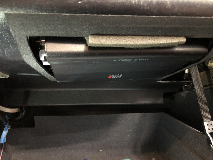

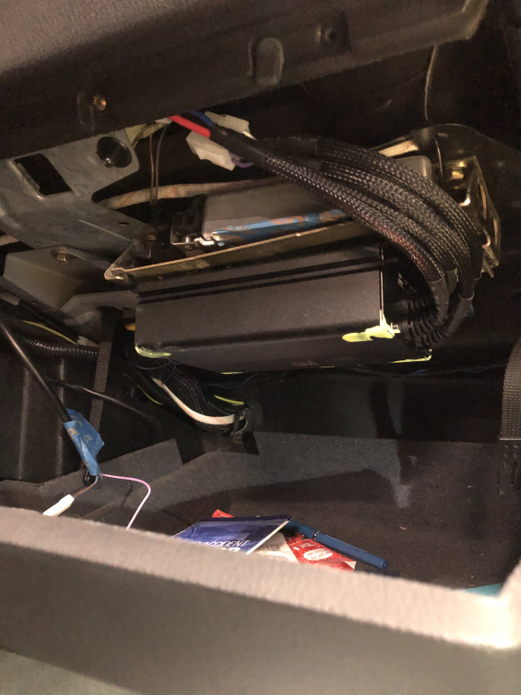

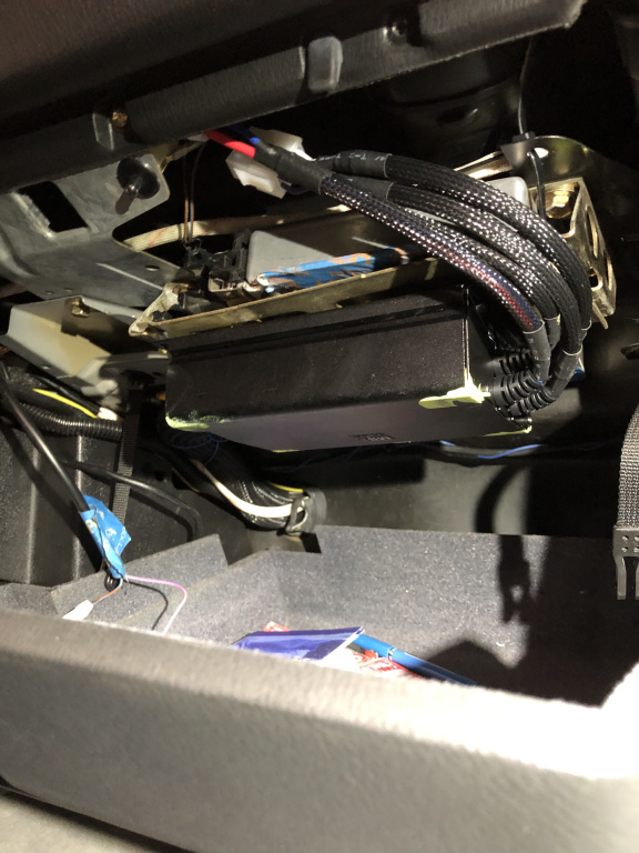

                            Found a good spot to mount the MB Quart amplifier, had to make a little room for it but its fine, the closer it is to the head unit the less wiring I need to run, meaning a cleaner install and simpler project car.

                              I hate project cars that look good on the surface but have a rats nest of wires under the dash and behind the carpet, it makes any troubleshooting problems super challenging and frustrating. I was guilty of this with my land cruiser early on until I had enough and cleaned it all up. Poor wiring is messy, hard to work on and has been the cause of many project cars going up in flames. I've learned that it should take more time to plan your aftermarket wiring than actually installing it.
                              These are the things I put on paper before I ever touch a wire.
                              • Location of devices needing wiring
                              • Locations of harnesses final terminations
                              • Loads of Devices (amps) to size wire correctly
                                • Also determines fuse sizing if needed
                              • # of wires in the loom
                              • Color of wires in the loom
                                • Note each color & what it is for (If I'm tapping into the cars wiring for 12v, ground, or some other signal, I color match my wire to the factory one I'm connecting to
                              • Sketch out the layout of the harness & wire runs noting locations where each color begins & ends
                                • Try and use the factory wiring harness runs where possible
                                • Also note locations of splices for common power or common ground
                              • Determine where to place connectors so any servicing doesn't involve cutting the harness to remove a component.
                              • Save the layout to the end of your Factory Electrical Troubleshooting Manual
                              I often prototype devies before committing to a final installation so I often run temporary wiring which is ultimately replaced with a complete harness. When the car is back from paint I plan on adding sound deadening so the carpet will come out and the final aux harness will go down under it, I also plan on adding pins to the factory fuse block for the aux devices fuse needs so it'll be as clean as it was when it left the factory.
                              The amount of time this all takes to build something that ultimately won't be noticed is immense, but knowing that it's all done to a OEM standard gives me a sense of ease and makes troubleshooting in the future much easier.
                              Just note that this isn't my final harness but it will be a section of it.
