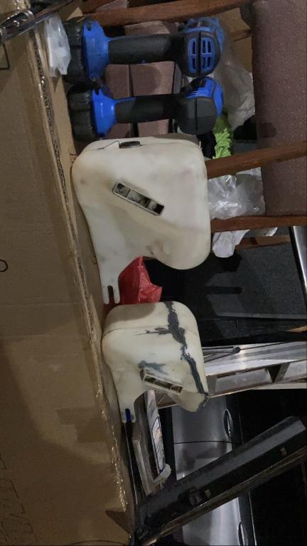

            By the way, JBWeld isn't ideal because it's not flexible enough. After cracking the seams once, I then tried Permatex Plastic Welder, and it seems good now. I then painted it black and put it back in the car after removing a little surface rust that was hiding on the car underneath it. I have a temporary aliexpress air filter on an aluminum pipe with the IAT sensor.

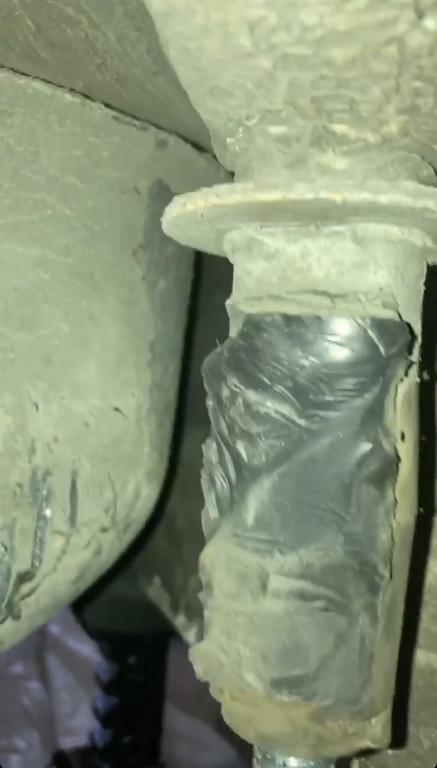

              My axle boots were starting to show wear with some miniature tears starting. I didn’t have new axles in the budget and wanted to be time-effective, so since the axles are working fine and haven’t been leaking any grease, I just put a thin layer of black RTV over the cracking areas of the boots.

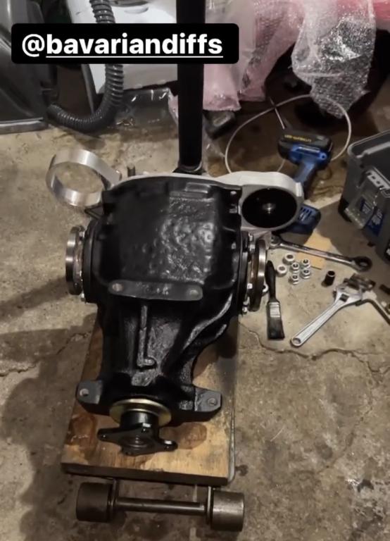

              I shortly after found a 3.25:1 LSD from an E28 535is semi-locally that had a car port collapse onto it and destroy the roof, so it was being parted out.
              ​Click image for larger version
              I sanded the rust off, painted it, swapped its rear cover and axle flanges for my E30's 3.73:1 open diff's, filled it with Redline 75W90, and everything went back into the car like a breeze. I learned to bleed the brakes for the first time after this using an old Gatorade bottle since the rear lines had to be disconnected. I did a transmission fluid flush with Royal Purple 75W90 just so I'd know when it was last changed, and I was ready to finally do some driving!

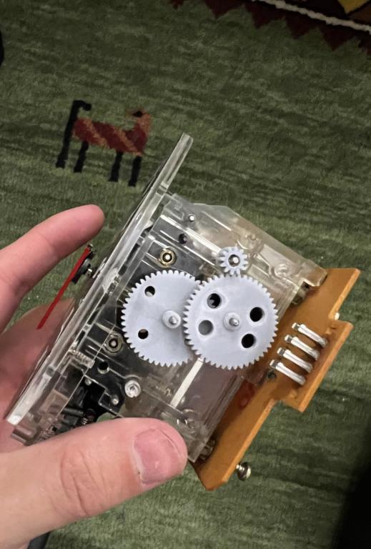

                    During this trip, my econometer stopped working, and 2 lights on the gauge cluster SI board​ stayed illuminated. I tried resetting it, but nothing changed. After a bit of research, I figured out that my SI board needed to be replaced. I remembered that the previous owner had the gauge cluster taken out during his ownership, so this wouldn't be the first time. I ordered a new SI board from Programa.

                              Getting back to Montreal in late April 2022, I put the Programa SI board into the gauge cluster, reinstalled it into the car, and voilà, no more unintended SI board lights, and a functioning econometer.
