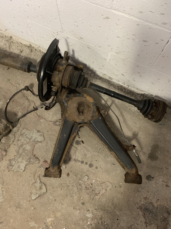

            Hoping it's in decent condition
            Cleans up nice, at least I didn't have to replace this!
            Stock struts, never going back in here... This is where I started to lean towards 5 lug conversion
            Subrame bushings
