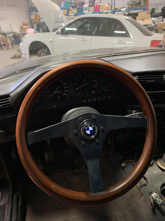

    Never showed one of my first mods, this Nardi I had in my possession for 7 years and never had the perfect car to fit it in until now!

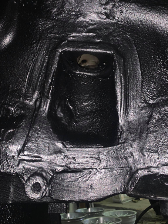

      Much cleaner

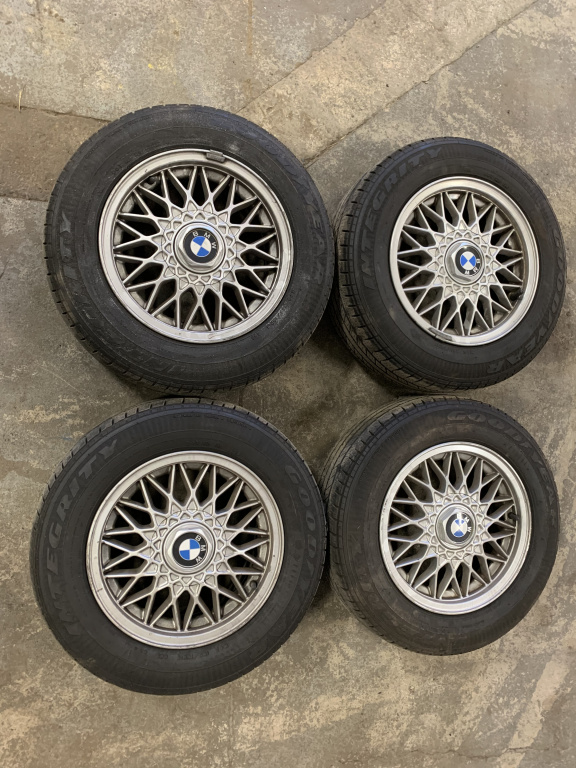

      Sold the OEM 14's as I now decided the 5 Lug Conversion was for sure happening

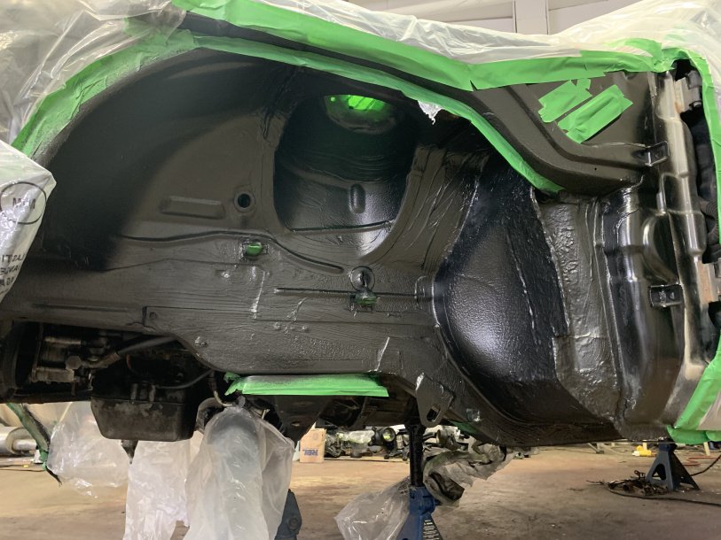

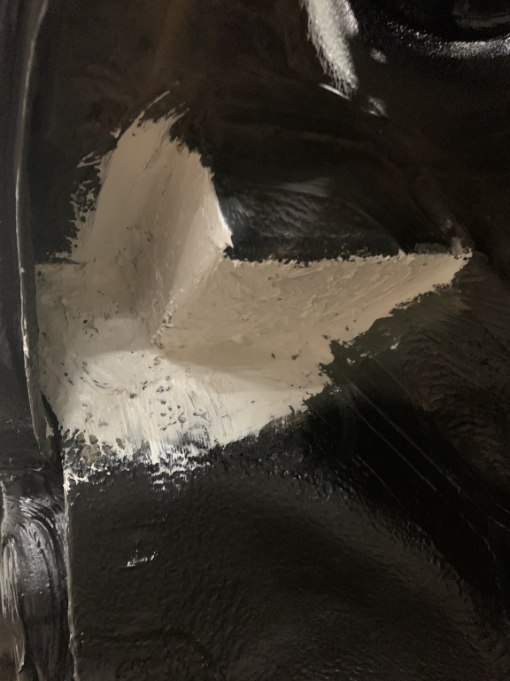

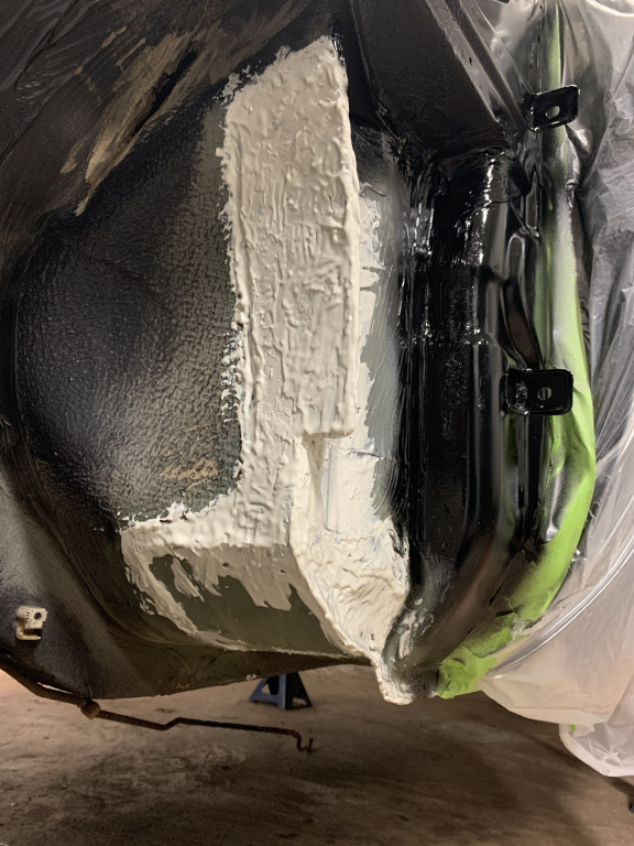

      Tried to get this factory texture with the seam sealer, im doing my best here okay!

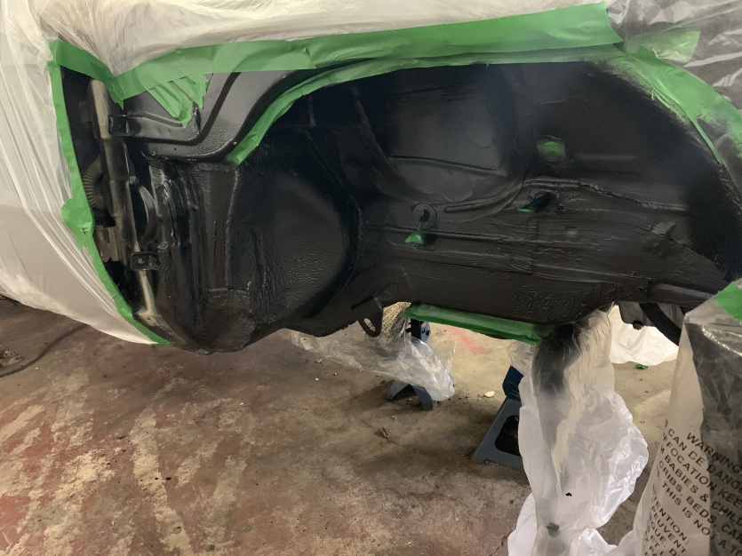

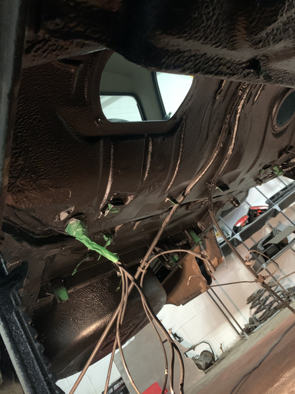

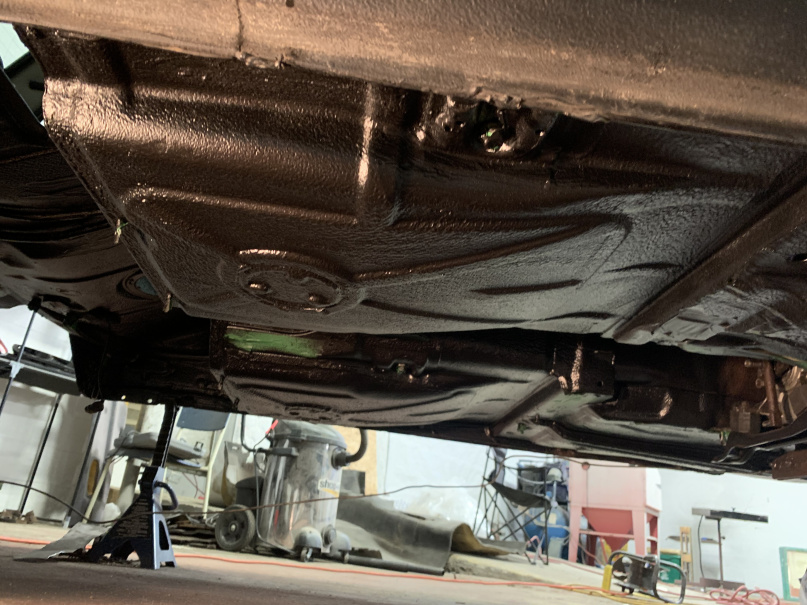

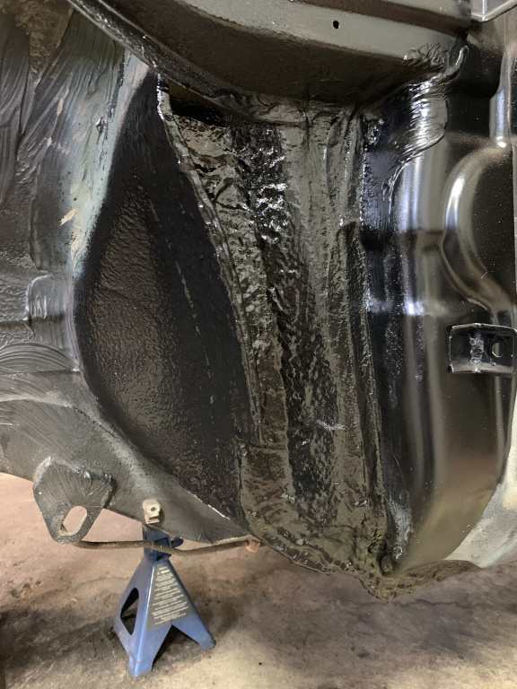

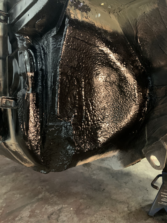

      Time for undercoating! Went with typical canned Gravel Guard, which I regret for certain reasons now
      Any place where the can was straight, as in the wheel wells, it came out perfect
      But when I had to flip the can on it's side to coat under the car/ tranny tunnel, it never dried properly and stayed sticky
      To this day I can't work on certain parts of the car without being coated in black sticky gravel guard
      again, we live and learn!​

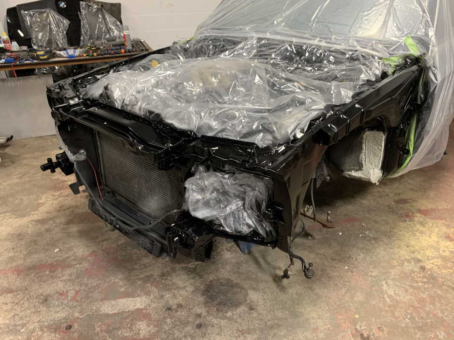

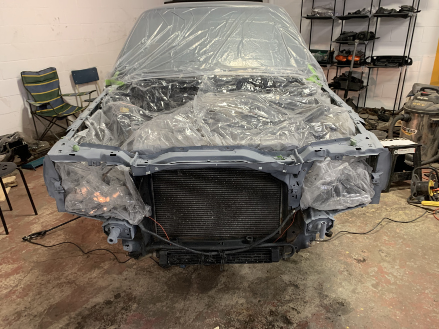

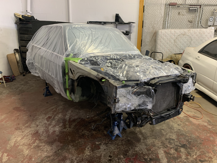

        Decided to put a coat of paint on the front end while everything was apart!
        Primed

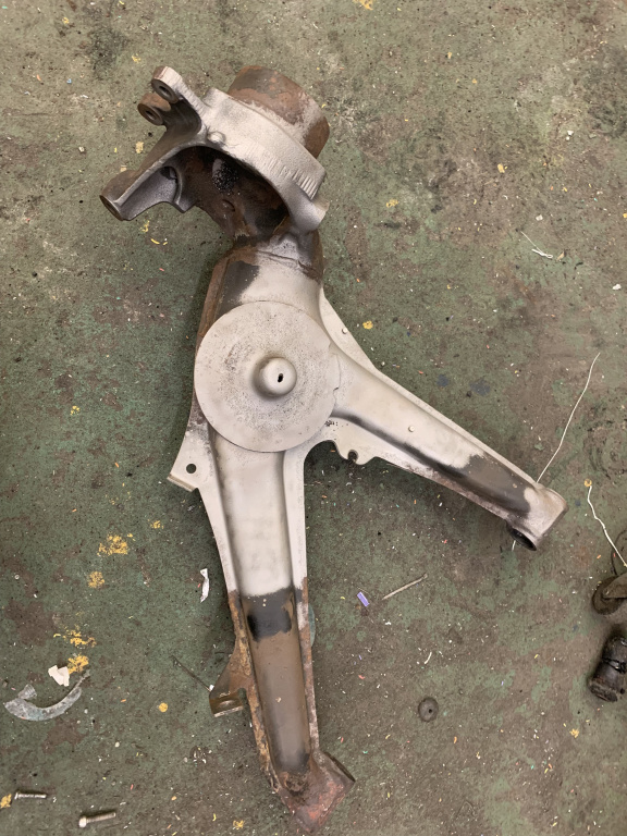

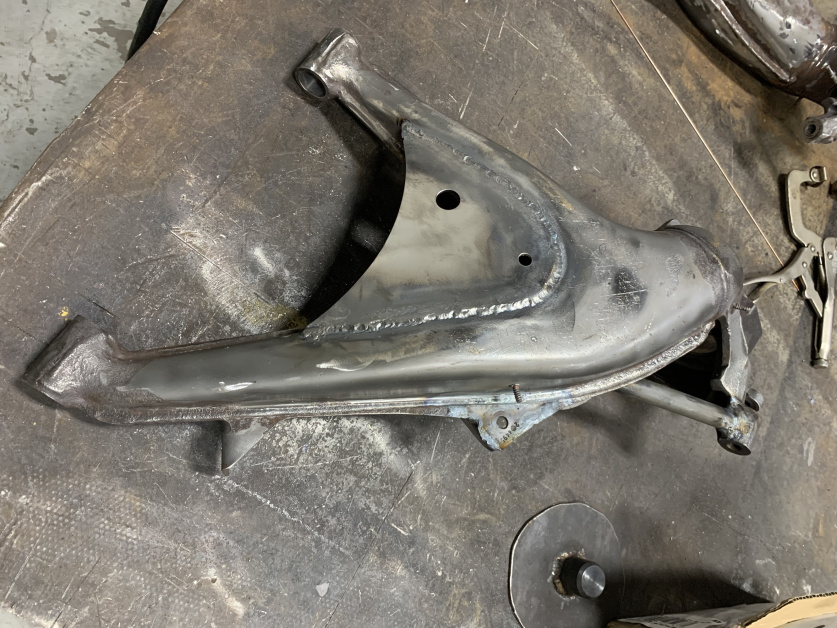

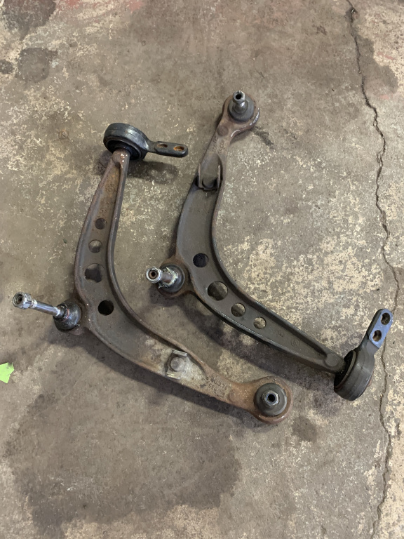

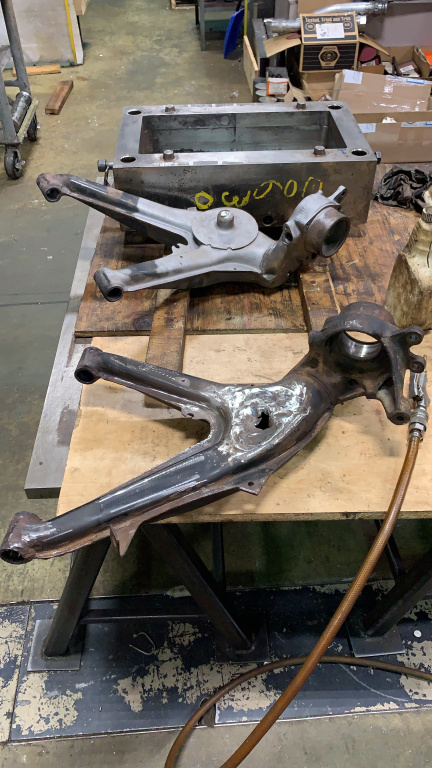

            OEM Front LCAs
            Had to address the missing seat for the spring!
            Luckily I had access to a sandblast machine as well!

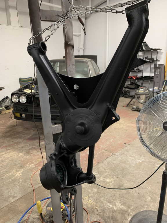

            Made a new seat on a lathe
            1989 BMW ​325i - M54B30

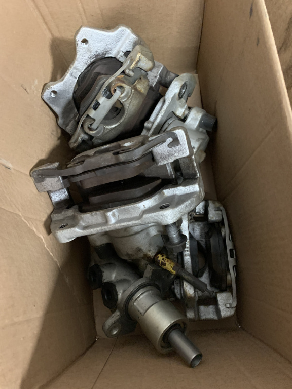

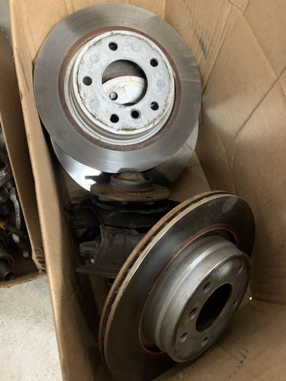

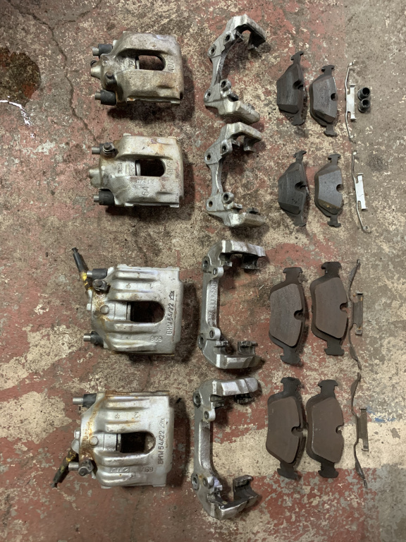

              Scored E36 Spindles, E46 Front and Rear brake setup used locally! Ready for the 5 lug conversion

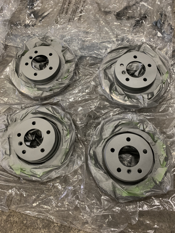

              Discs were in great condition so just gave them a quick respray!
              Decided it was a good idea to rebuild and refresh these, even if they were in excellent condition
              Swapped out my master cylinder for an E32 7 Series 25mm Master to prepare for the bigger brakes

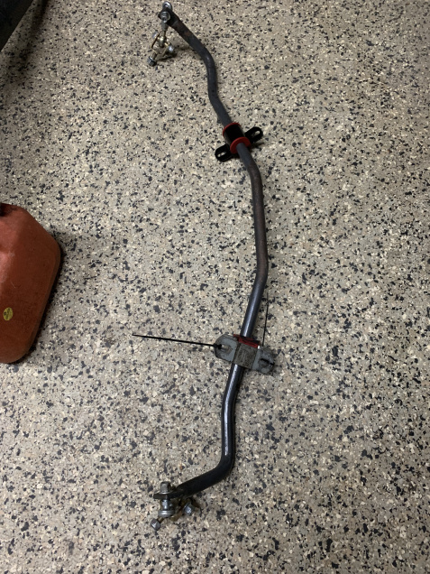

                Also scored a larger front swaybar with poly bushings and adjustable endlinks!

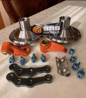

                Purchased the full 5 lug conversion kit by SRSConcept since I can pick these parts up in person!
                Also added the accelerator pedal bracket since mine was rusted out

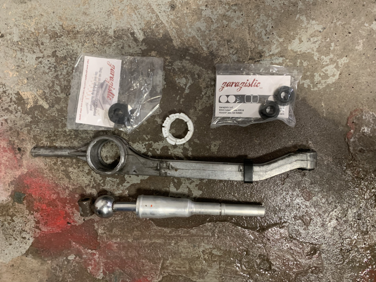

                Shifter got the full bushings upgrade kit by Garagistic

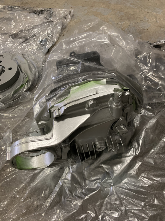

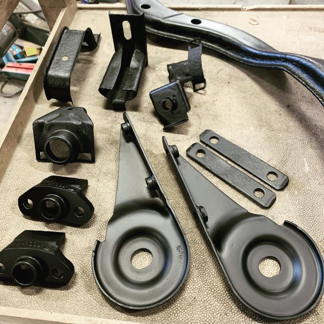

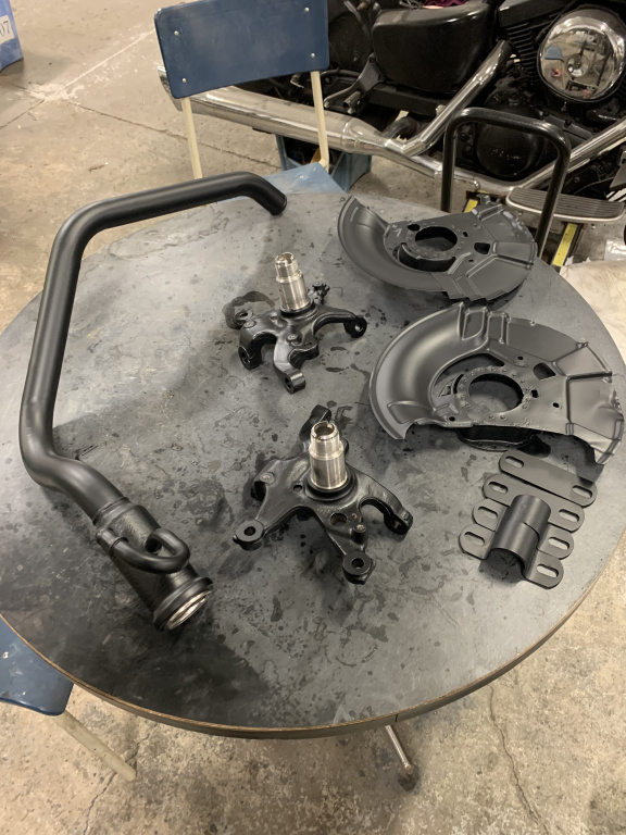

                I also had access to a powdercoat setup at the shop thanks to my buddy, so this is where it started getting interesting!
                I decided to powdercoat every single metal part I was going to put back on the car! So addictive when you don't have to pay for it!
                Brake backplates, Wiper arms, Seatbelt Rails, Swaybar Brackets all powercoated satin black

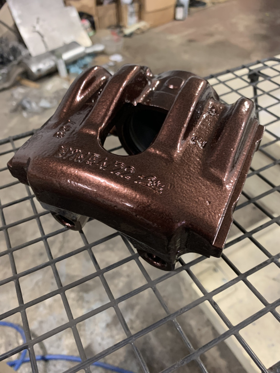

                  Calipers look amazing! accent colour is official

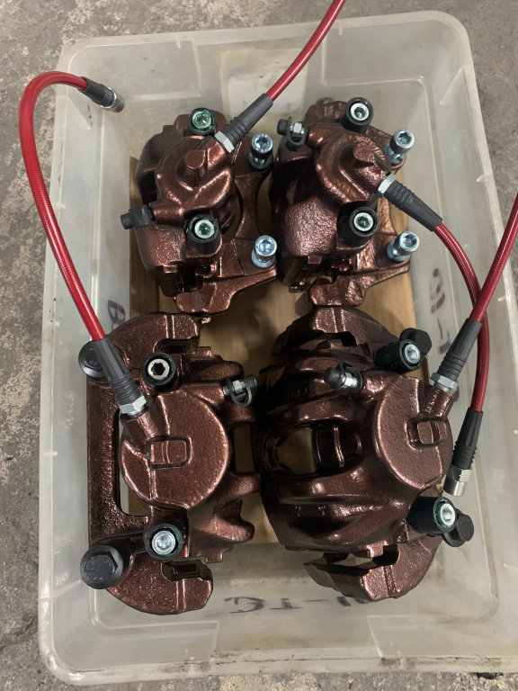

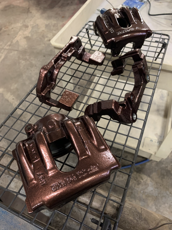

                    Rebuild kit for brakes + starting to stack what I need to finish this all up for spring time!
                    Brakes fully rebuilt with new pistons, seals, slider pins, Garagistic stainless hoses
                    First time doing this and it was seriously so easy! You don't know until you try!

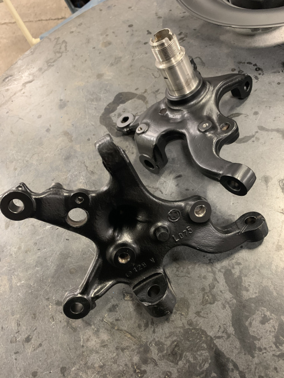

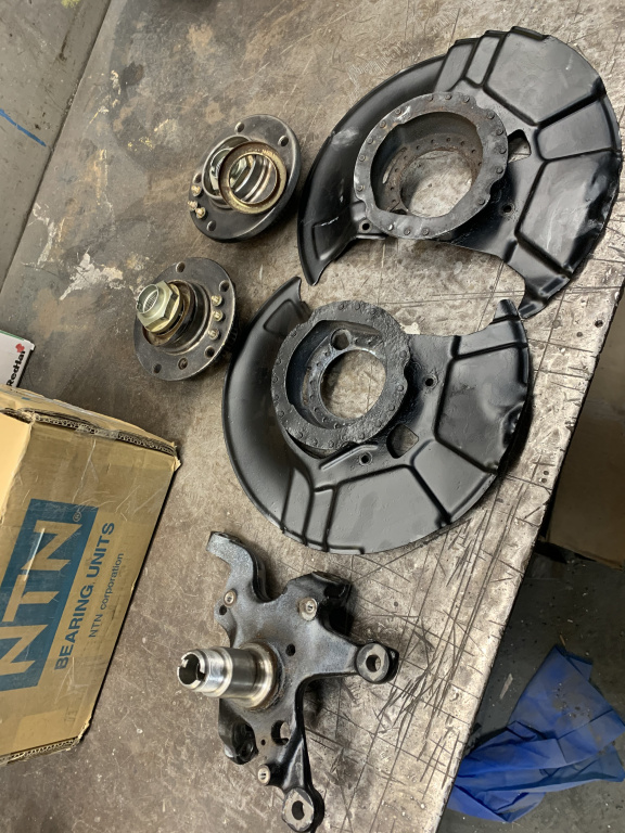

                      E36 Spindles Looking brand new!

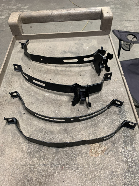

                      Fuel filler neck gets powercoat too because why not ?
                      Everything gets refreshed or replaced! One new hub/bearing, other one was in great condition! New Caps and bolts!
                      Assembled!

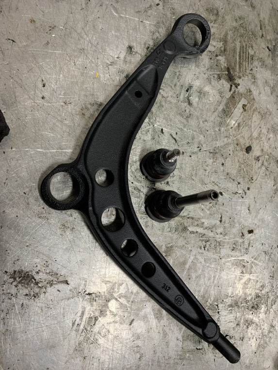

                      OEM LCAs powdercoated, new balljoints!

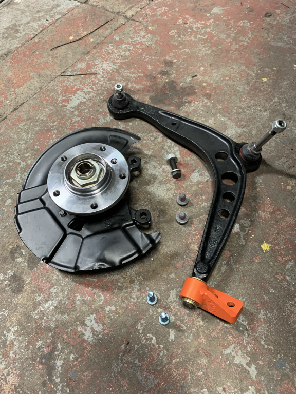

                        #41
                        Assembled with SRSConcept 5 Lug swap lollipop bushings which corrects caster when doing 5 lug swap!

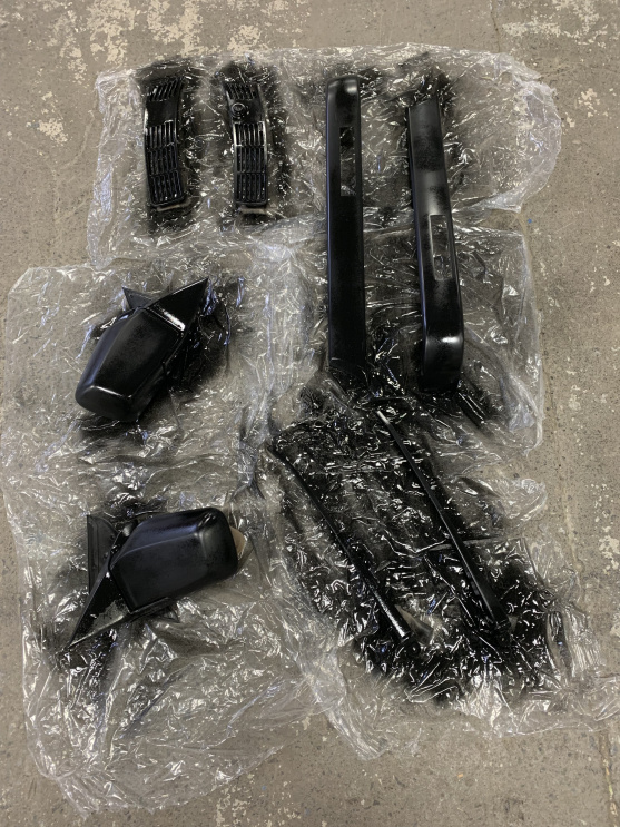

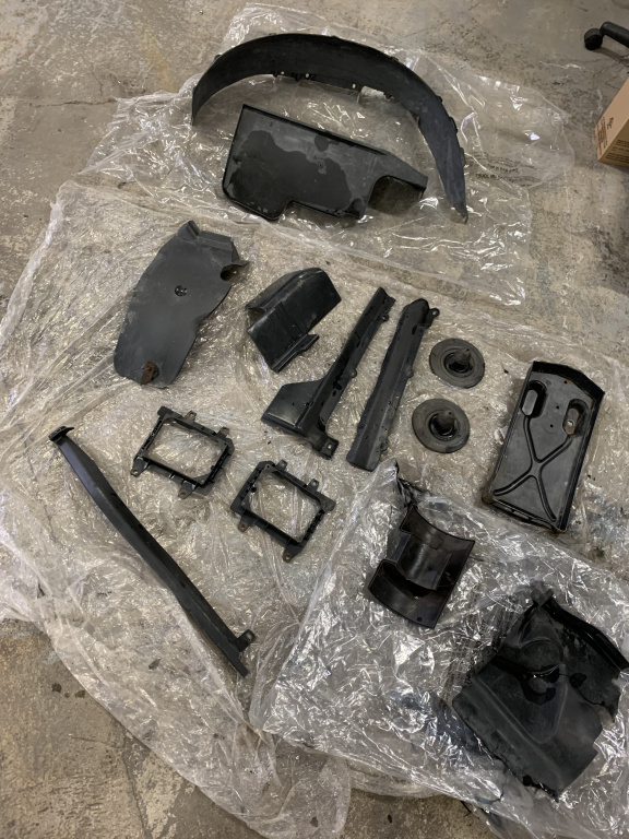

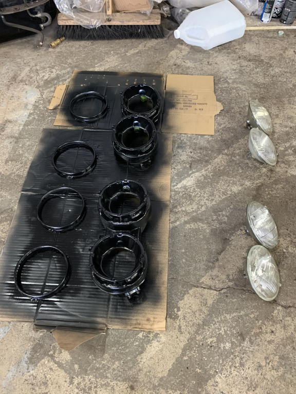

                        Plastic parts ready for some trim black
                        Scuffed and ready for paint
                        Fresh coat of Trim Black
                        ​Everything gets a little refresh

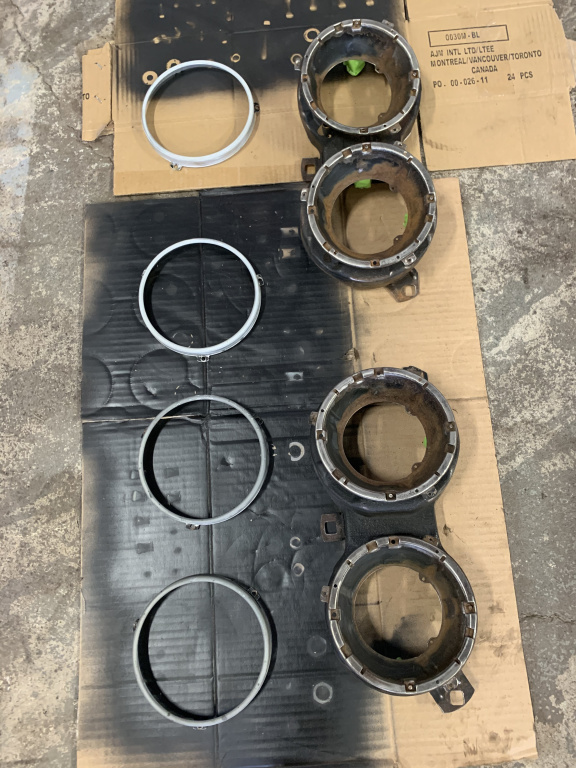

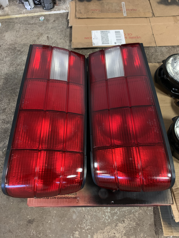

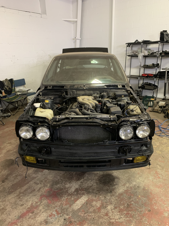

                          Not perfect, but much better while I wait to order some new Depo headlights
                          Went for the all red look
                          Perfect!
                          Quick refresh definitely did the front end some good! First parts to go back on the car

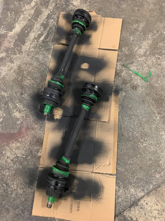

                            OEM Axles were fine so a quick coat of paint for now

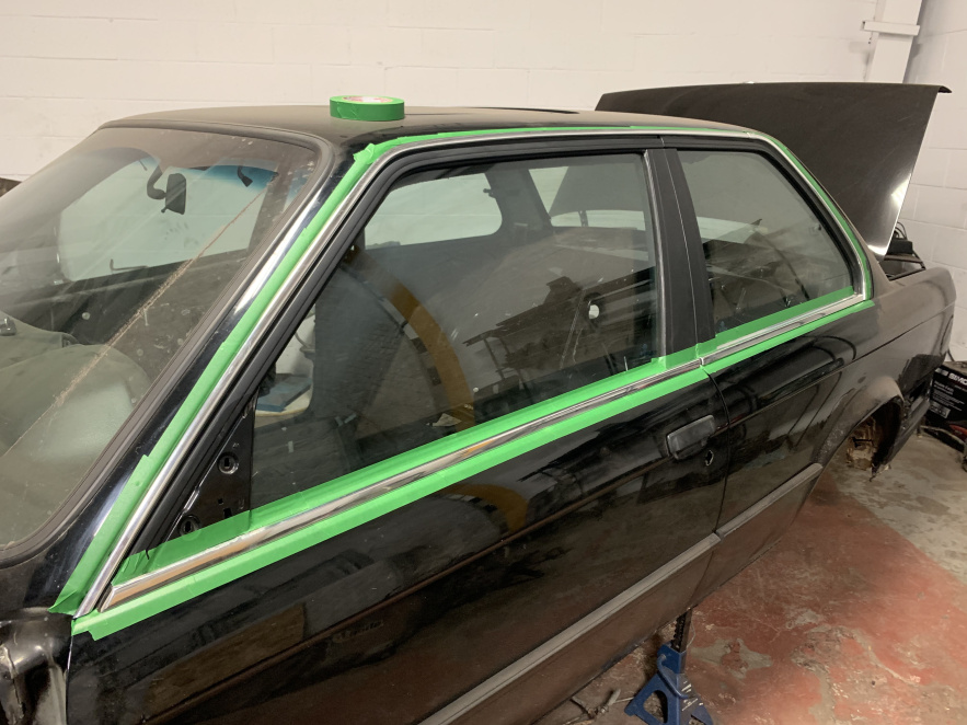

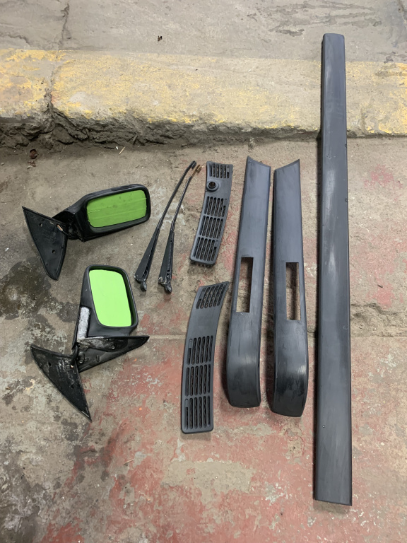

                            Decided to go for a dark look on the car so prep for SEM Trim Black on the window trim!
                            Love it!

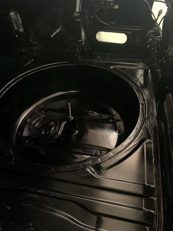

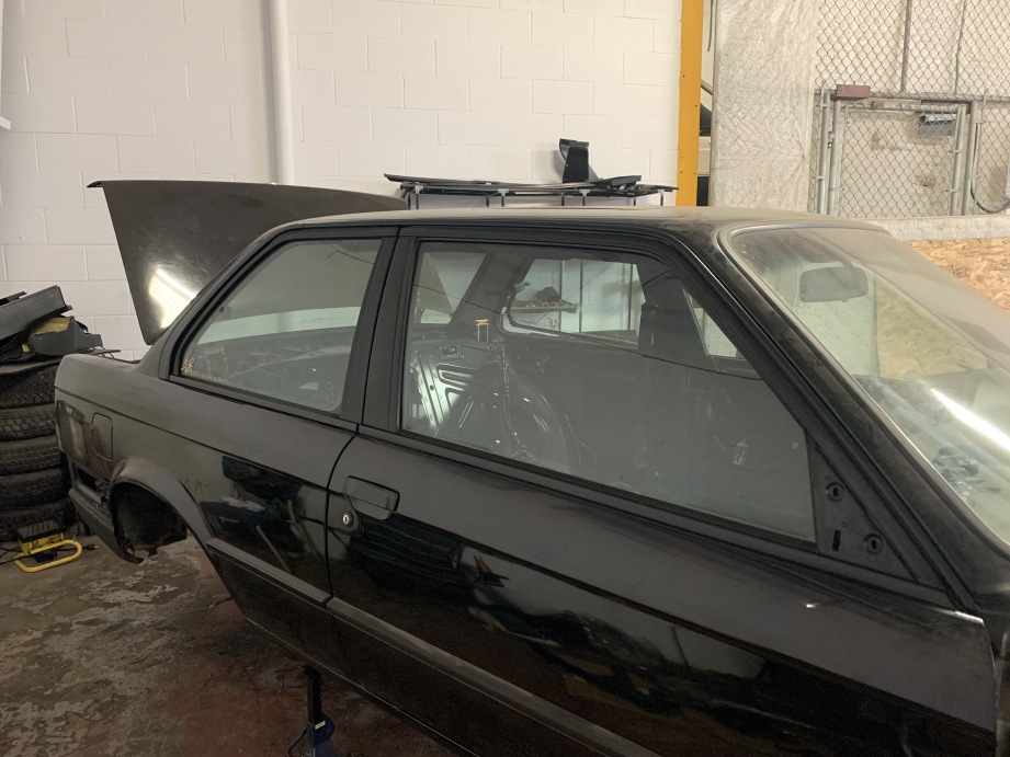

                            Trunk gets a coat of paint after all the repairs
                            Parts starting to come in! Best feeling for a car guy, especially stickers :P

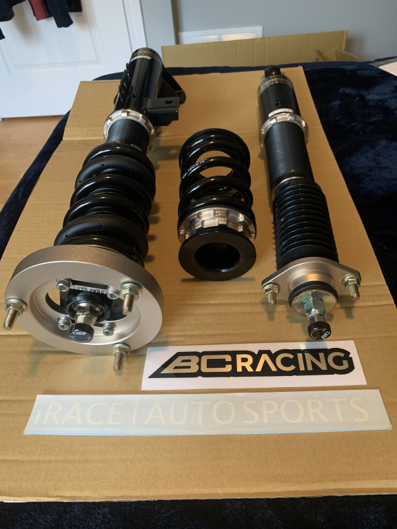

                            ​Went with BCRacing Extreme Low 5 Lug Conversion Coilovers 8k Front 10k Rear spring rates

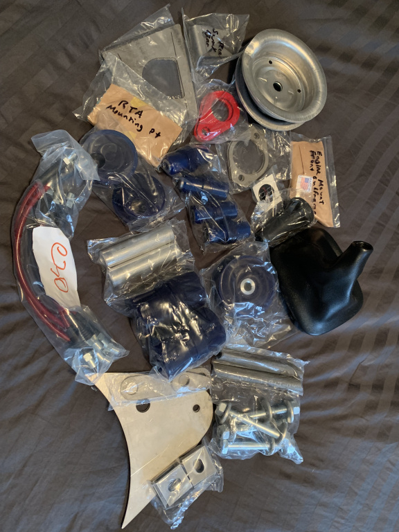

                              Visited Garagistic during a layover in Cali, picked up all the subframe reinforcements, bushings, brake lines, and anything else I thought I would need!

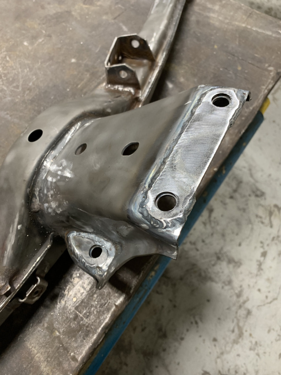

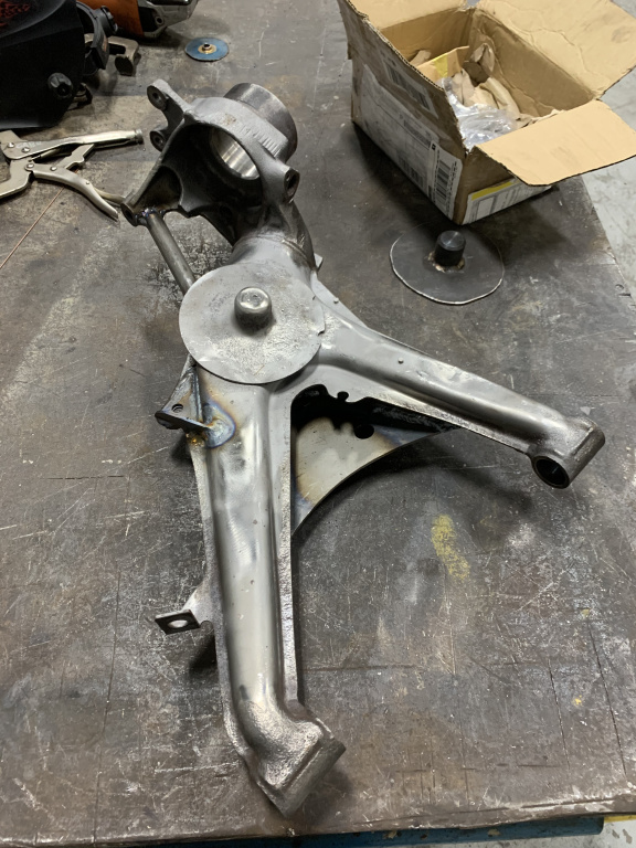

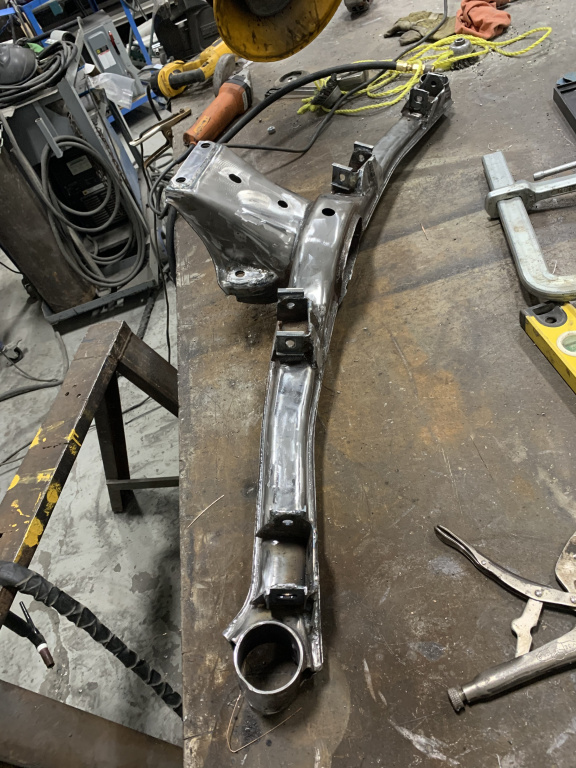

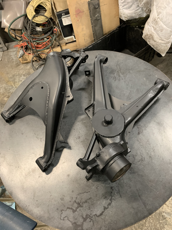

                              Back to the suspension components ! I wanted to do everything right the first time on this car, so I decided to weld on every reinforcement sold for rear of the car
                              Diff Mounting, Trailing arm, Trailing arm mounting, Swaybar mount, rear shock mount
                              Trailing arm getting gusset welded to reinforce!

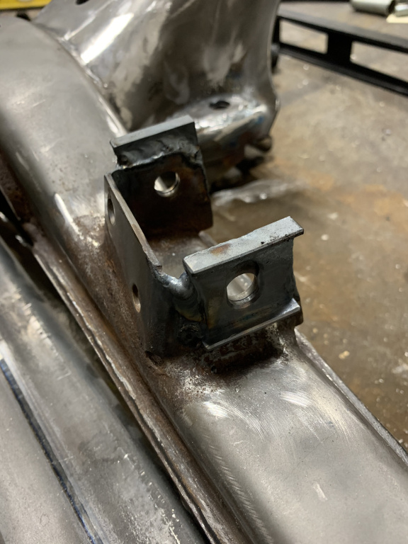

                              Swaybar mount welded on as well
                                Diff mounting point reinforced
                                Camber / toe adjustments welded on as well to fix the camber once car is lowered
                                Fully reinforced rear subframe
                                Coat of satin black powdercoat on trailing arms
                                So blessed to have access to all this equipment, this build will last a long time!
