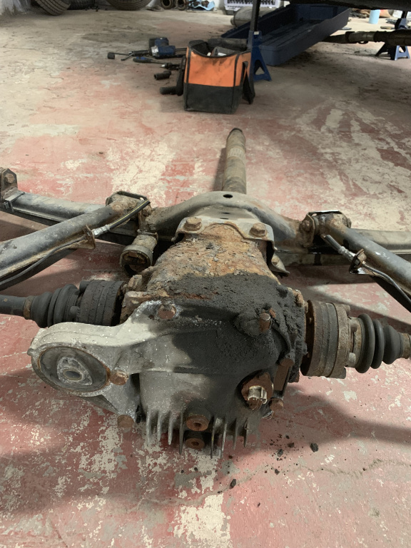

                            Since I bought the car, the diff was always leaking, and there was a few knocks in the suspension
                            At some point during the first winter storage, I decided to remove the diff to address the leak
                            This led very quickly to pulling the entire rear subframe to refresh it after one look at it...
                            This led to the "While i'm here" addiction which never ended until today​
                            After the first summer driving it, I stored it for winter which ended up staying there the following year since I know at this point a full rebuild had to be done

                            First things first, Got rid of entire AC system, compressor was seized
                            Rusty leaky diff and first look underneath
