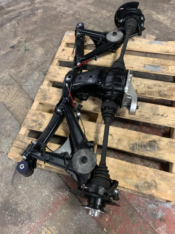

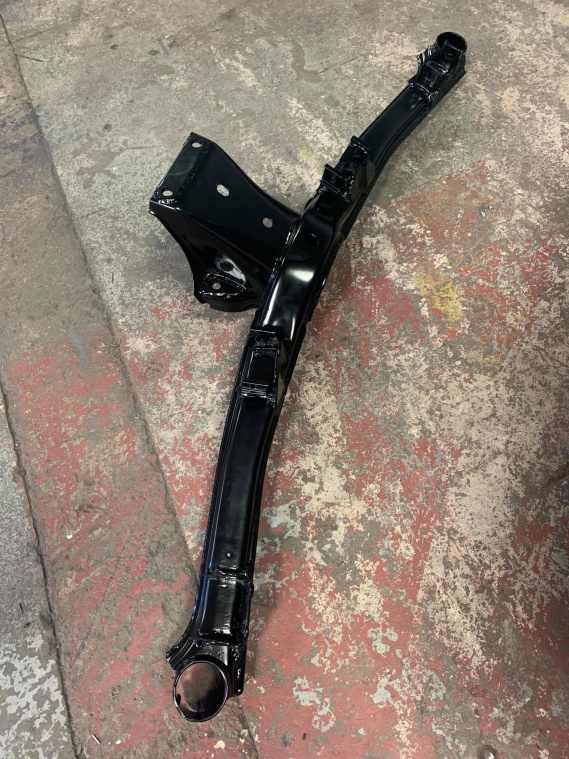

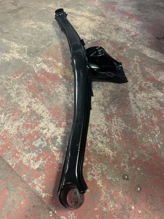

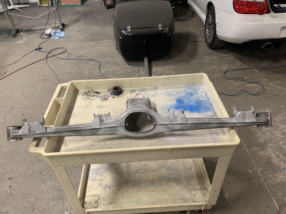

    Subframe sandblasted, Didn't fit in our powdercoat oven so had to send this one out!
    Back from powdercoat! Only part outsourced

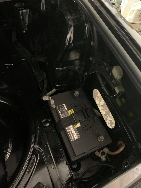

    New Battery installed with marine style strap hold down

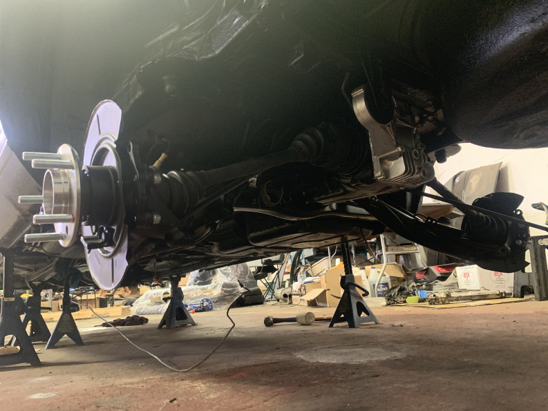

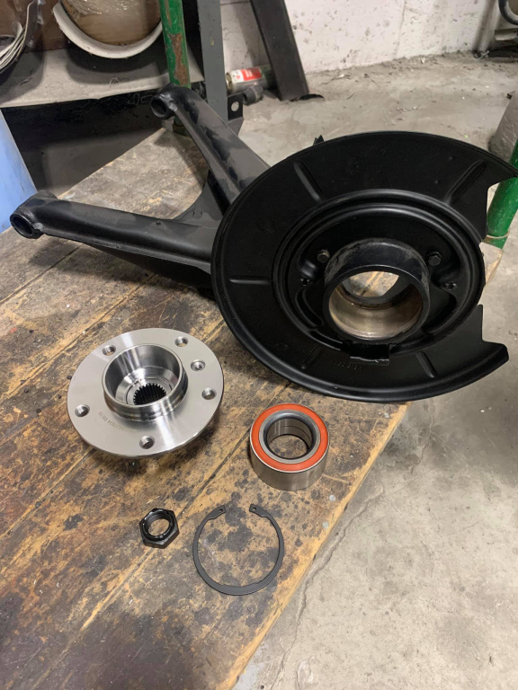

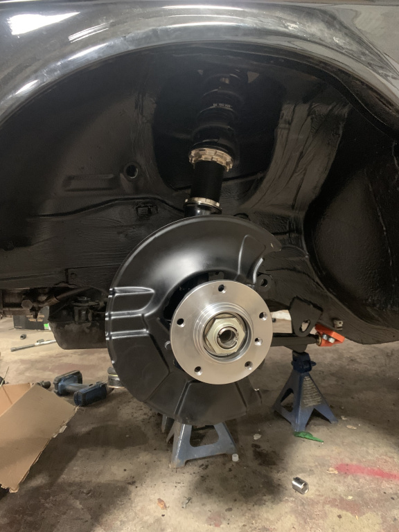

    Z4 Rear hubs for 5 lug swap, with new wheel bearing and hardware
    1989 BMW ​325i - M54B30

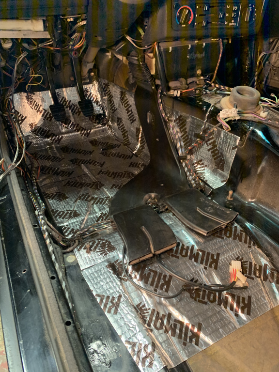

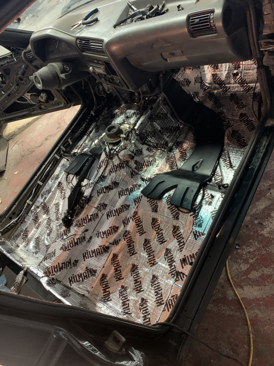

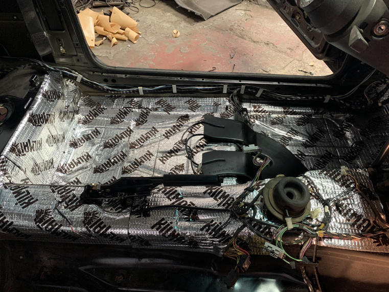

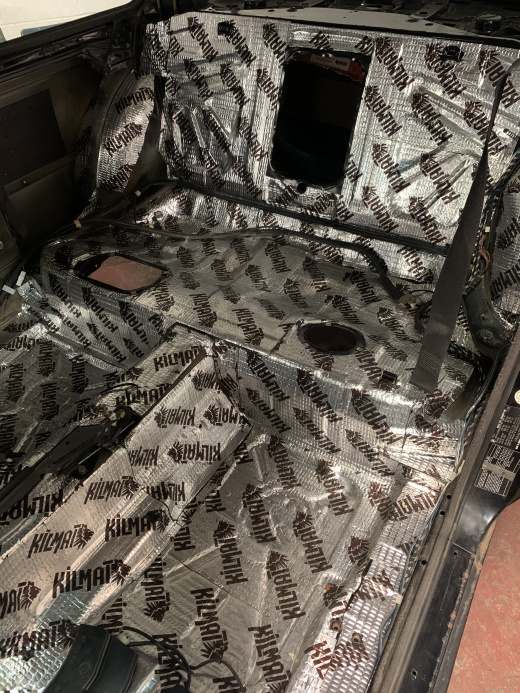

      Let's get back to the interior for now!

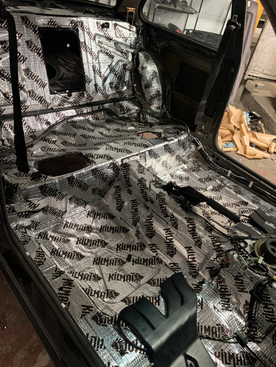

      Decided I wanted a car that I could talk in on long rides, after getting rid of all the oem sound deadening, wanted something that would not add much weight but still do the job
      I ended up ordering Kilmat on amazon, and I was blown away with the quality of this! Do not regret adding this extra step!​
      Started installing the Kilmat and resinstalling interior components
      Rolls on super easy and very thin to easy to cut out studs and holes!
      Might've gone a little crazy since they recommend 60% coverage but I couldn't help myself!

      I later covered the inside of the doors, inside of rear quarters, speaker deck and entire trunk as well

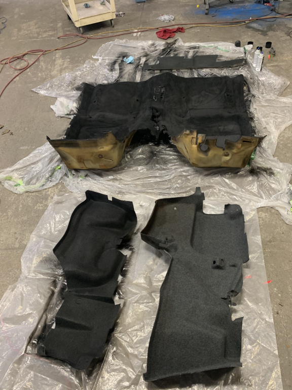

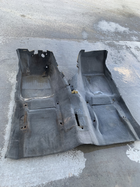

        Next on my list, do something with this disgusting carpet

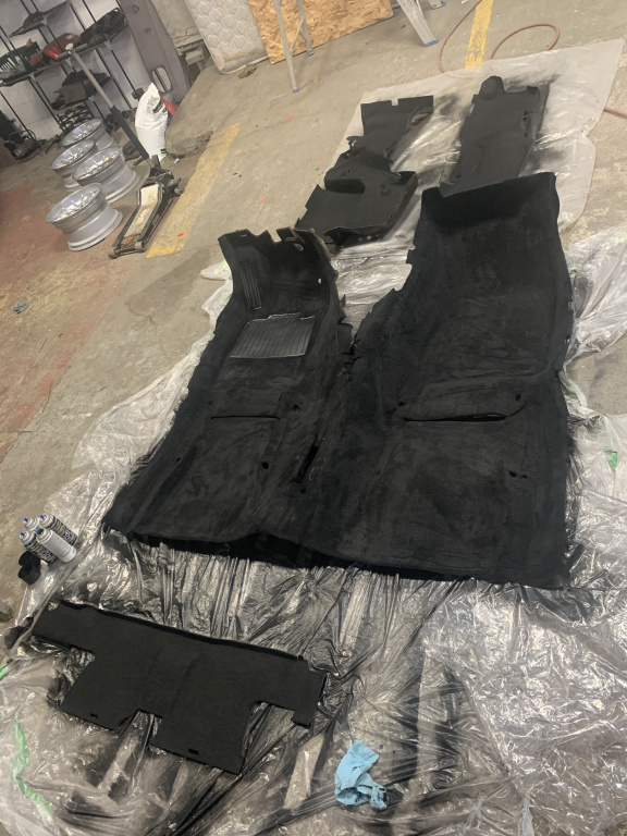

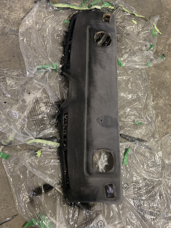

        Testing upholstery paint on the rear speaker deck, if you brush it after painting, comes out real nice!

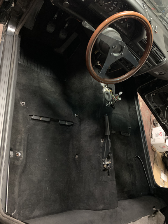

        Much much better, have to do trunk carpet too!
        Looks so much better painted black
        Carpet back in the car, what a difference!!!

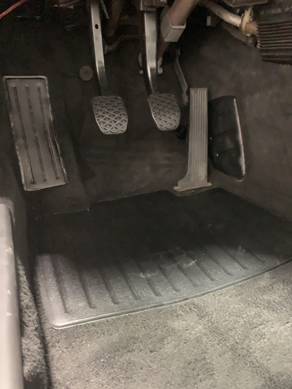

          Worth the effort !
          Brand new OEM Pedal rubbers - again it's all in the details

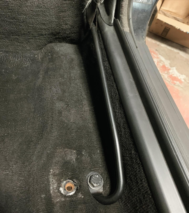

          Powdercoated seatbelt rails back in

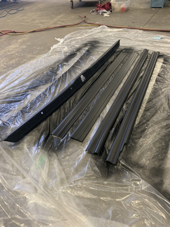

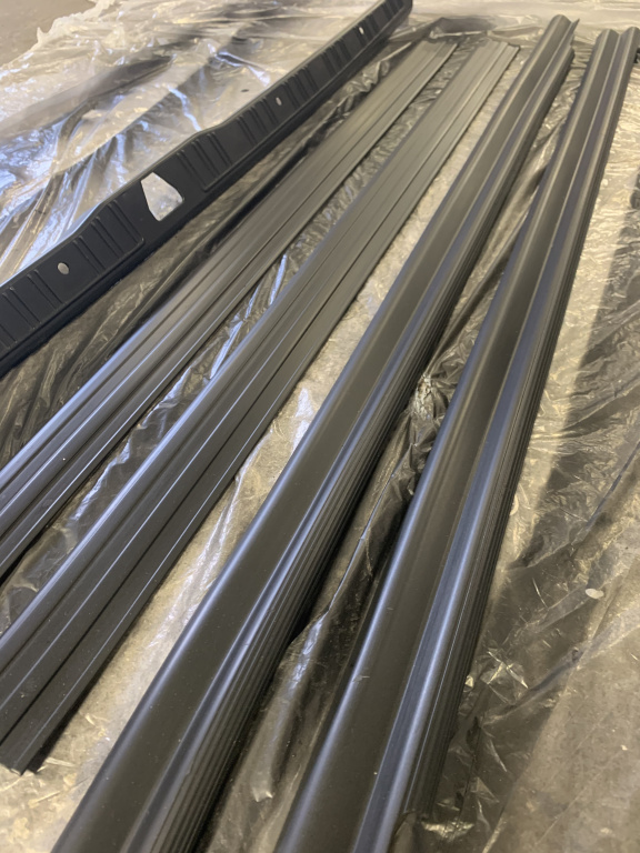

            Door and trunk trims get a coat of SEM Trim Black to complete the refresh
            Factory fresh finish

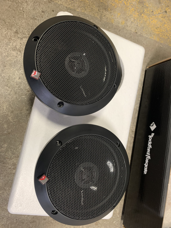

            New speakers to replace the OEM 30 year old speakers

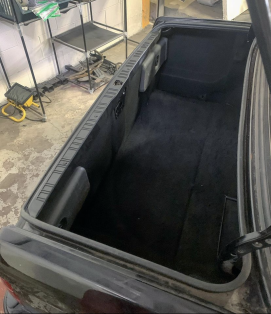

            Trunk gets sound deadening too because why not :P At this point I was just addicted

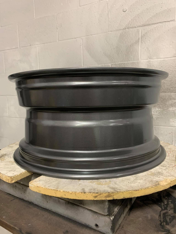

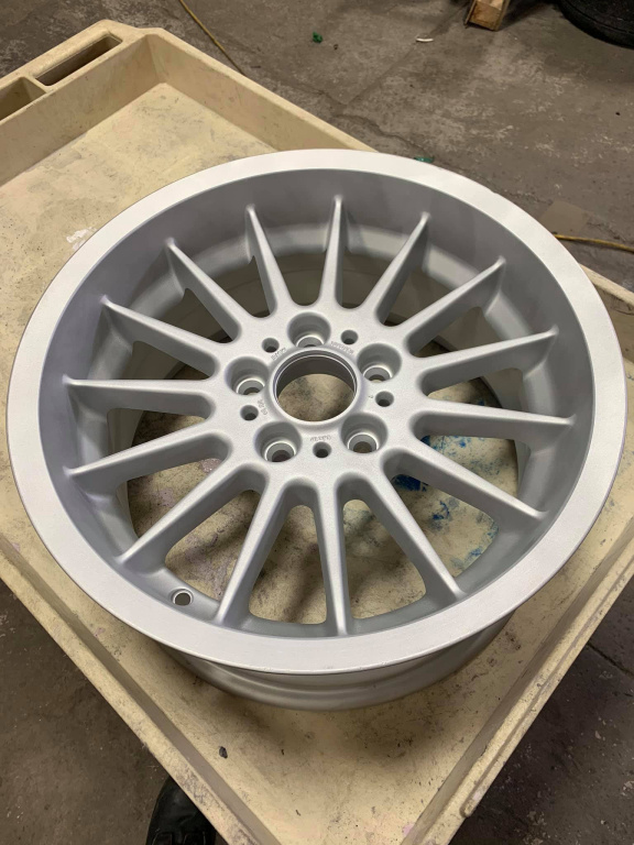

              Let's get started on refinishing these wheels!
              Sanded down all the curb rash by hand
              Learnt how to sandblast and powdercoat wheels on my own
              Messed up the first one and started over but the 12 hours of work to finish the set was beyond worth it
              My favourite part of this build​
              Sandblasting
              Ready for powdercoat
              Colour tease
              Looks AMAZING
              More than happy with this result! Got some cheap used tires for test fitting purposes

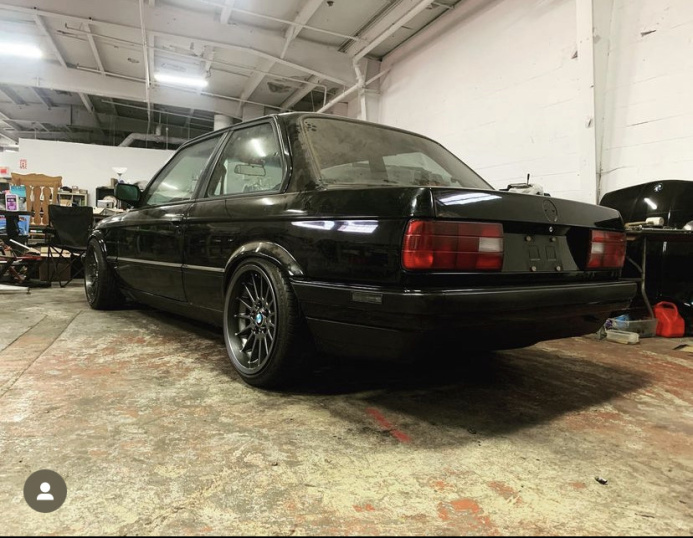

                #52

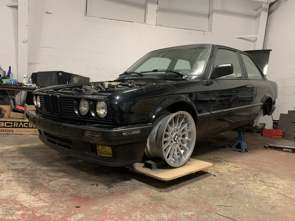

                First test fit with the wheel to get an idea of the look, LOVE IT
                My favourite build photo to this date
                I spent hours researching part numbers, learning every single component
                and getting ready for this moment
                I wanted every nut bolt and bracket to be powdercoated, painted or replaced
                Organization makes things soooo much easier
                When I dismantled the car, I put every bolt in seperate ziplocks based on what they came from
                This made refreshing each section that much easier because I knew where everything was
                Everything ready to go back together!!

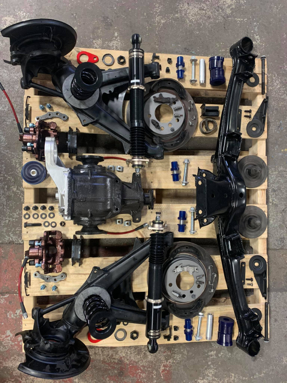

                Fully assembled rear end! 1000x better looking and performing than when I took it out
                This made the past year worth all the struggles and patience

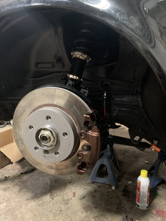

                  Brakes installed

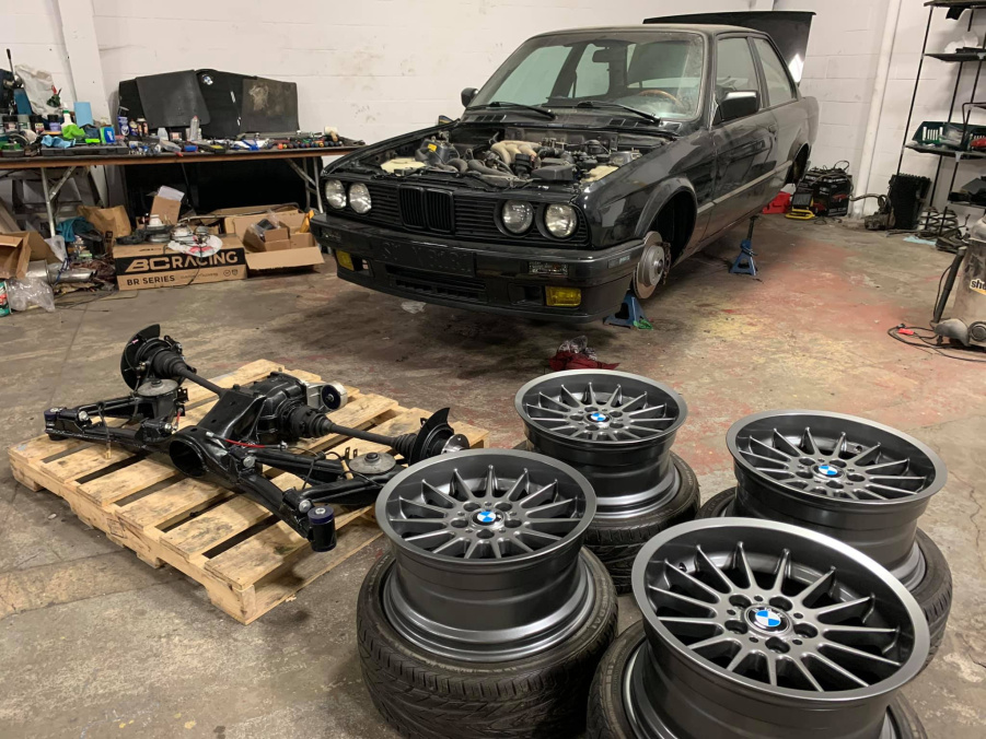

                    • Feb 2020
                    • 236
                    #54
                    In love!! 6 months of work staring to show progress of what I envisioned

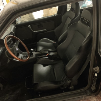

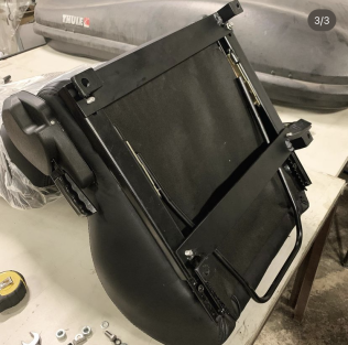

                    We made some custom mounts for the seats since the way I previously installed them was veryyy sketchy
                    Much Cleaner interior now!!

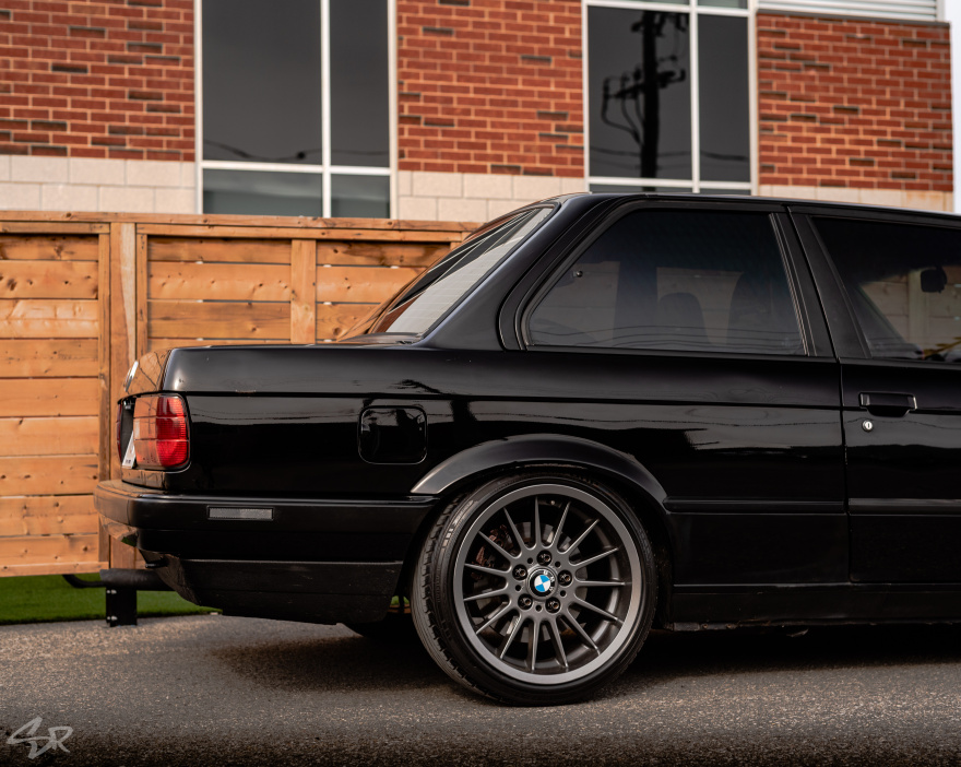

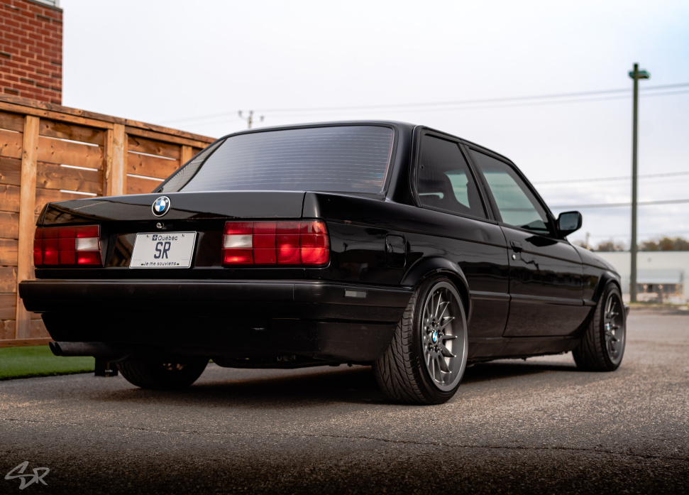

                        #56

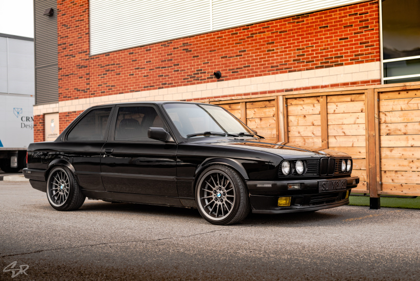

                        First photoshoot of my build once it was done! IG: photography_sr

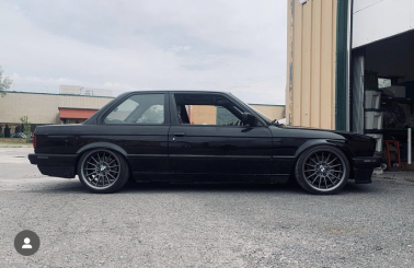

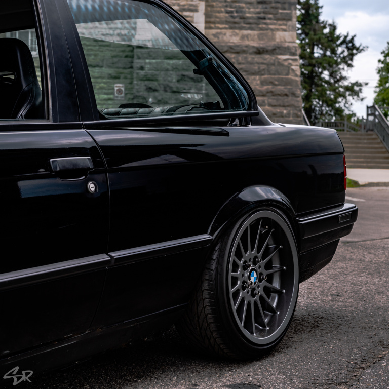

                        After this, raised the car 3/4" all around as it was rubbing on the top of the tire at the pinch weld, never rubbed ever again after!
                        Added some BMW Motorsport floor mats to finish the interior along with a new shift knob and boot

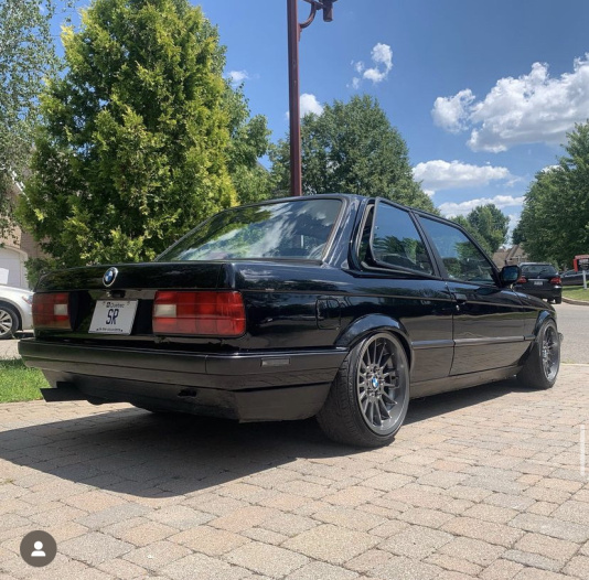

                        • E30Rossi
                          • Feb 2020
                          • 236

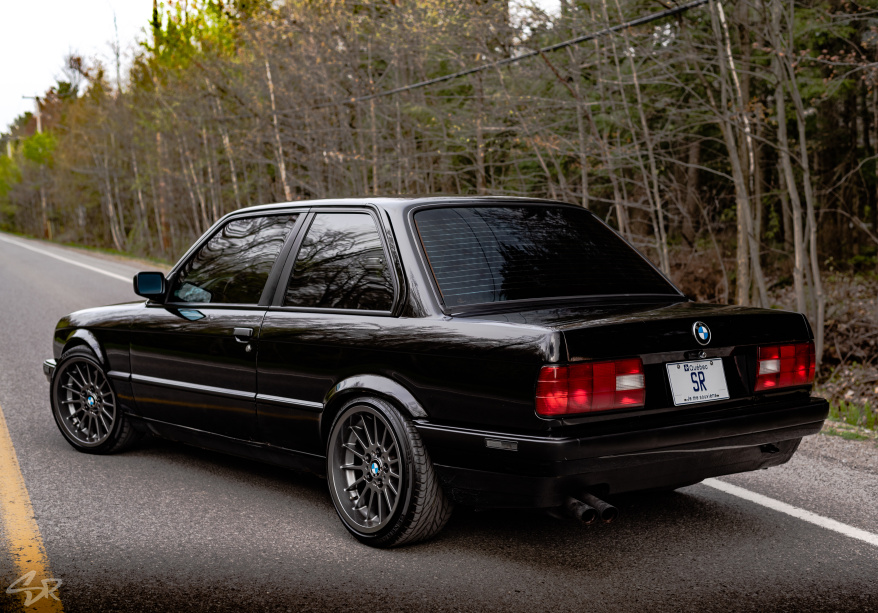

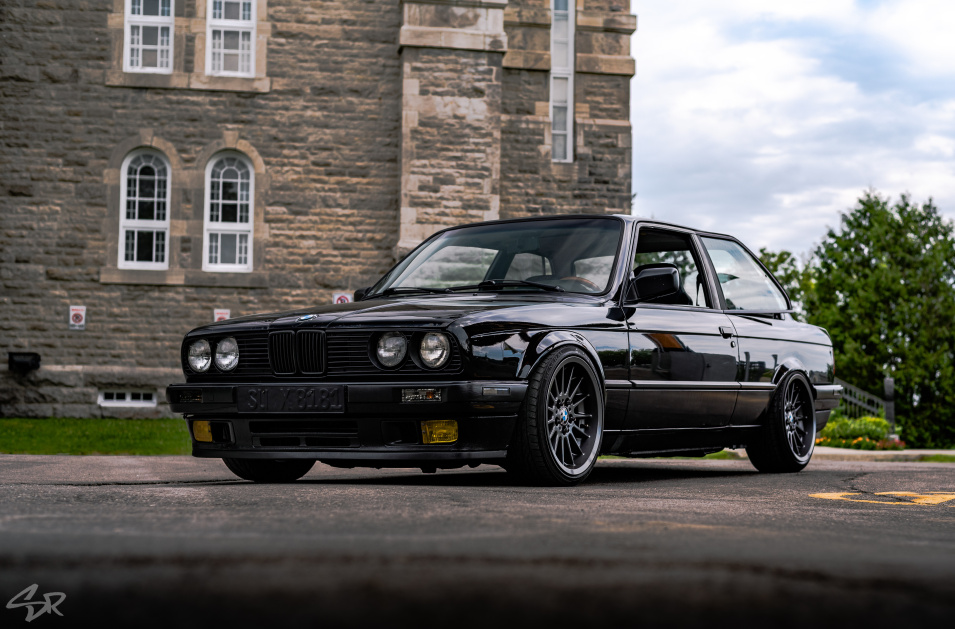

                          #57

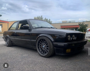

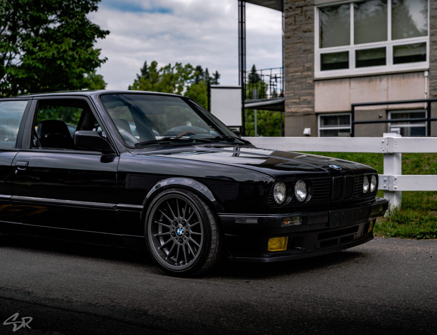

                          Next mod is not usual a popular one, but in my personal opinion it completed the look for me , 20% window tint all around
                          Car didn't change anymore for 2020, just enjoyed it as much as I could after all the time, money and effort poured into it!

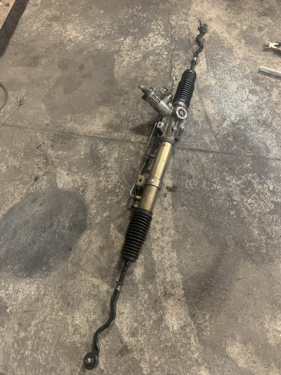

                                a few photos that were forgotten!
                                Z3 Steering Rack

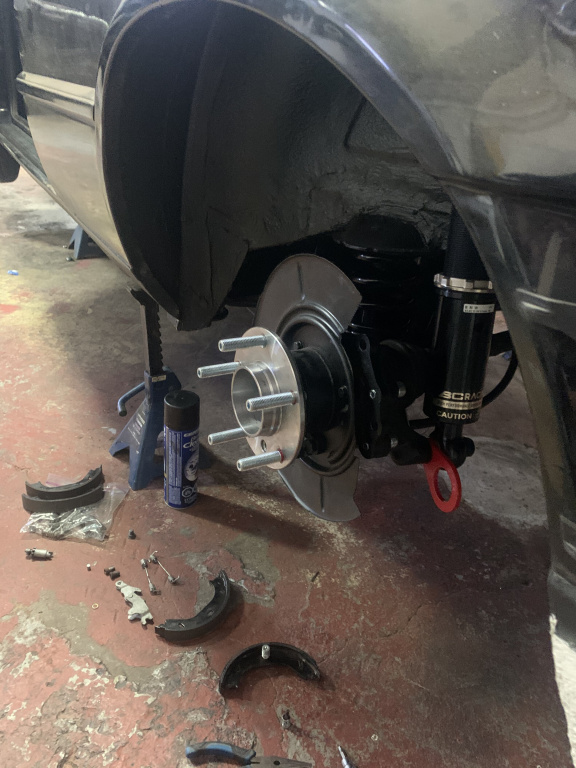

                                Rear subrame assembly installation with wheel studs

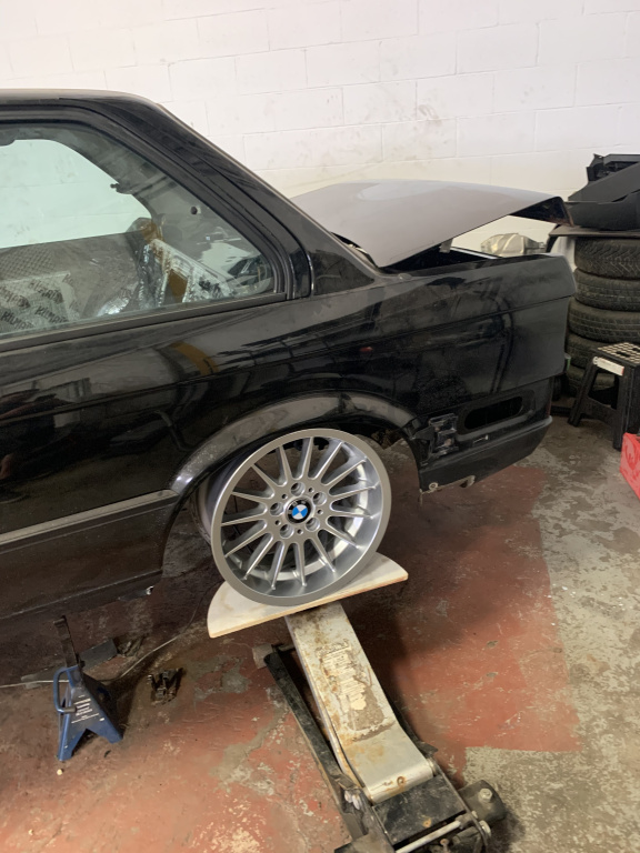

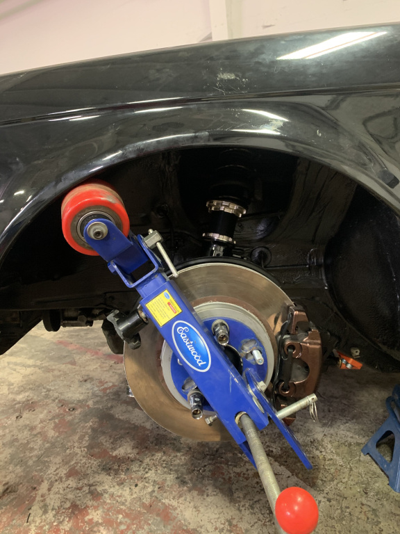

                                Fender rolling to fit the wheels
