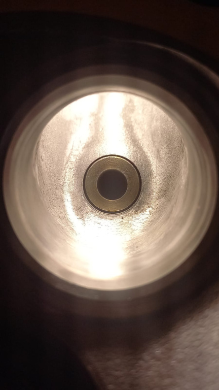

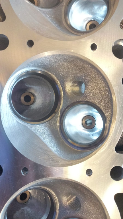

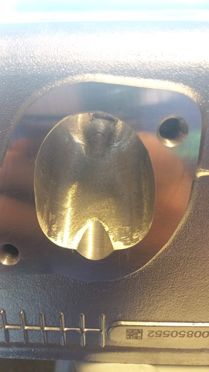

    Here is the AMC intake port after cleanup
Name:	WhatsApp Image 2024-08-01 at 18.37.59_3471b08f.jpg
Name:	WhatsApp Image 2024-08-01 at 18.38.00_65f25010.jpg
Name:	WhatsApp Image 2024-08-01 at 18.37.59_aad11cda.jpg

                    Port work looks good! Nice challenge to open up an older 12v head for flow.
                    Don't see someone putting in the work too often with a boosted motor. But of course an engine that flows more N/A will have better spool and response when boosted.
                    Car sounds great and scoots pretty well. Personally I'd be happy at your power levels rather then going for E85.
                    There is enough to knock the tires off based on your video, which is basically my benchmark for fun lol.
                    I'm also just not a fan of ethanol in general. I mourned the loss of E0 gasoline around here.
                    Left sitting it pulls in water from the air, rusts fuel tanks, plugs injectors. And it's even worse on something with carbs.
