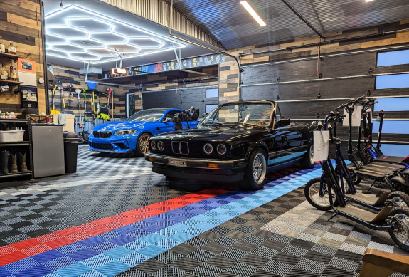

    '87 Vert For Her
    Greetings all ~
    My wife has been begging for a classic car to cruise around town. Being that classic Porsche prices are prohibitive, I've been keeping an eye out for e30's. Since my wife was out of town for work for a few days, I took advantage of the opportunity to meet up with a local friend who had recently acquired an '87 convertible, auto with 115K miles. I thought I would have preferred a manual, like my last e30, but I think the auto will be easier for her to manage, especially when she has the dogs on board. Anyways, we struck a deal and he handed over the keys. I was excited and nervous at the same time, worried she may be upset with the unapproved purchase, but she loved it! This will by no means ever be a show car and that is certainly not my intention. Rather, I would like it to look good overall and be in good working mechanical condition so my wife can enjoy for many years to come.
    In preparation of her return and the big surprise I:
    • Painted the wheels silver and lug nuts black
    • Vacuumed/cleaned interior
    • Shampooed floor mats
    • Dressed leather and trim
    • Cleaned/dressed engine bay
    • Fixed/installed a few interior panels and trim bits
    • Replaced windshield (yesterday)
    Happy wife, happy life, as they say.

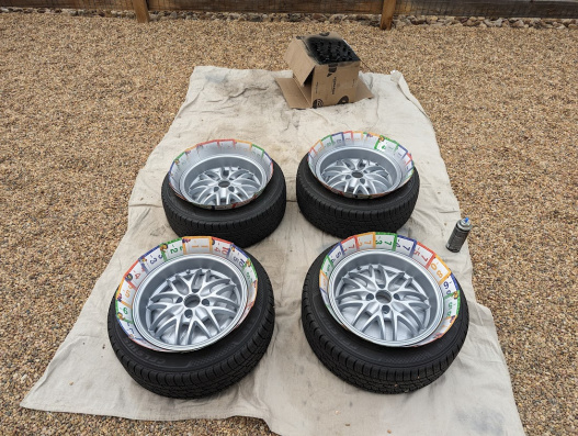

    A few wheel finishing pics. I was pleasantly surprised at how well the Hyper Silver rattle can kit from Advance Auto worked out. It'll do for now until I refinish the basket weaves.

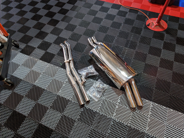

                Today, I finally got rid of this obnoxiously loud, Frankenstein exhaust and installed IE's system. Much better sound, look and fitment. I realized I need to purchase the exhaust hanger bracket, but this metal strap will work for now. Also, I am now planning a rear bumper tuck since the front end looks so much better with it done.

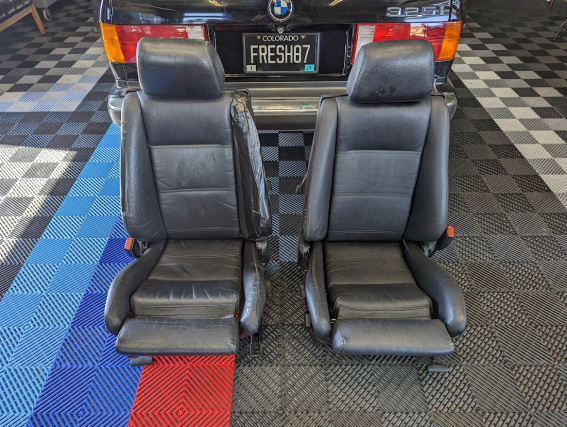

                    Over the weekend, I successfully installed the Corbeau GTS II seats and brackets. However, I wasn't particularly fond of the appearance of the Corbeau headrests. To address this, I decided to enlarge the rail holes and replaced the headrests with the stock ones, which, in my opinion, improved the overall look significantly. I am genuinely pleased with the seats' aesthetics, comfort, and quality, especially considering their price. It's a great feeling to have finally replaced the stock seats with their duct taped bolsters, and I couldn't be happier with the outcome.

                    • e30vert
                      • Jan 2005
                      • 1789
                      Seats look amazeballs! Great choice going with the stock headrests. Other headrest just look too bulky and blocky. When you bumper tuck and drill the hole in the shocks do so in a bag or something to contain the oil vapors. Some dude on the forum did a bumper tuck and the atomized oil was breathed in . He ended up at the ER as I recall with temporary breathing issues. The oil is under high pressure. Then when you have the shocks compressed and the bumper pushed back in on each side evenly and where you like it. Drive in a couple of self tappers to hold thier positions.
