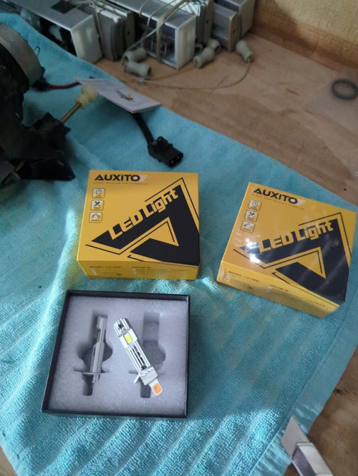

    Today, I completed the installation of the Euro Depo Smileys. Initially, I was a bit apprehensive about tackling this project because of all the articles I had read and videos I had watched. However, it turned out to be quite straightforward.
    My car is an early model with sealed beam headlights originally, so I utilized the three provided wires on each side for the low beams and two of the three provided wires on each side for the high beams (the third wire was capped and unused). To ensure a secure and weather tight connection, I purchased a quality connector set from Amazon and replaced all four connectors with weather-resistant ones. I simply cut off the wire connectors that came with the headlights, crimped on the new ones, and that was all there was to it.
    Having both low beam and high beams on simultaneously wasn't essential for me (since I seldom drive this car at night), and the LED bulbs I installed are more than bright enough without needed all 4 housing illuminated with the brights on. I have no complaints regarding their quality or the light output.
    I would personally recommend this upgrade to anyone who's uncertain. It's an affordable, straightforward process that results in good-quality lighting.

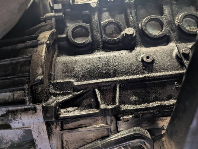

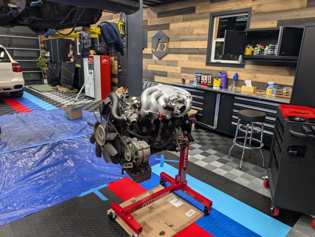

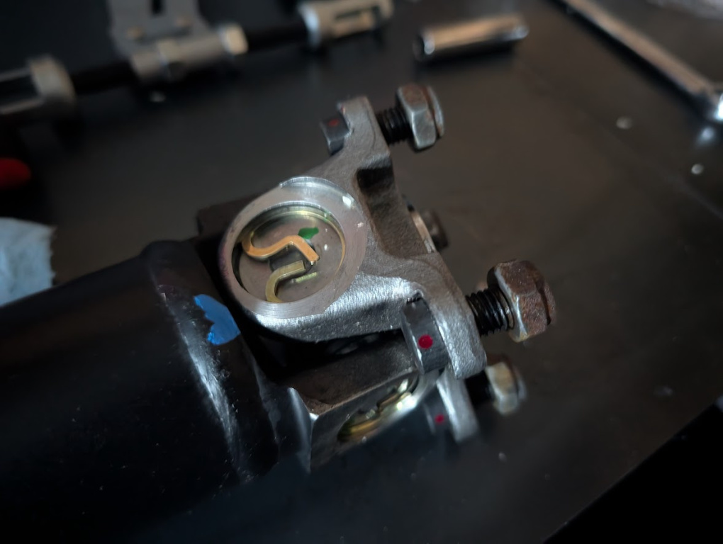

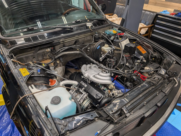

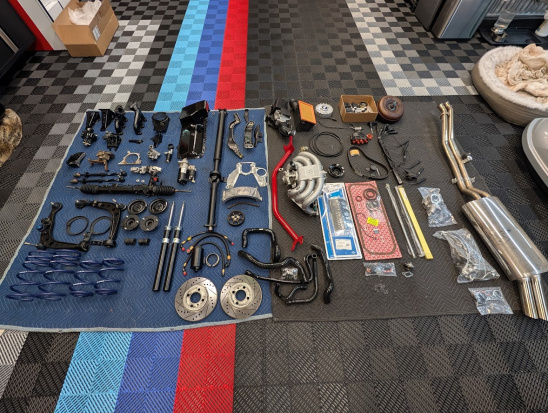

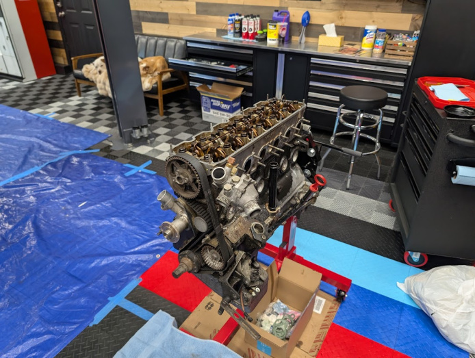

      I decided it was time to upgrade the suspension since most of the components are worn out. After taking the suspension apart, I figured there was no better time than now to remove the engine so I could address all of the leaks (rear main seal, front seal, head gasket, oil filter housing, oil pan, etc). In doing so, this will also make replacing the steering rack much easier. It seemed like the further I got into things, the more issues I found. For example, my driveshaft was floating inside the carrier support. The rubber was completely ripped, so I guess only a matter of time before that got significantly worse, and, also probably the reason I still have a bit of steering wheel shake. Got everything out of the car, garage cleaned up, and ready to tear down to take to the machine shop. Looking forward to not having wet cardboard under the car anymore :)
      High level plan:
      Clean/reseal engine
      New timing belt
      New steering rack (z3)
      New driveshaft
      New Suspension bushings and ball joints
      New H&R lowering springs
      Chase steering reservoir and lines upgrade
      Still deciding if I want the shop to rip the engine apart and rebuild for an extra $1500 in labor. Hmmm

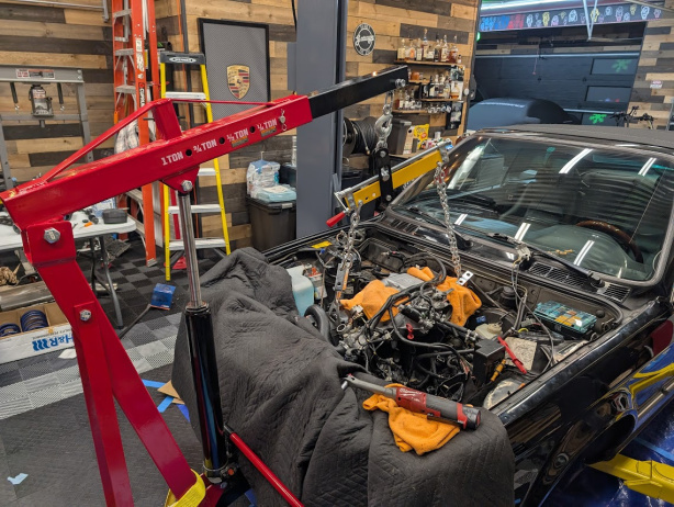

        #48

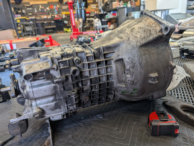

        Few more pics. Excited to tear this thing apart!

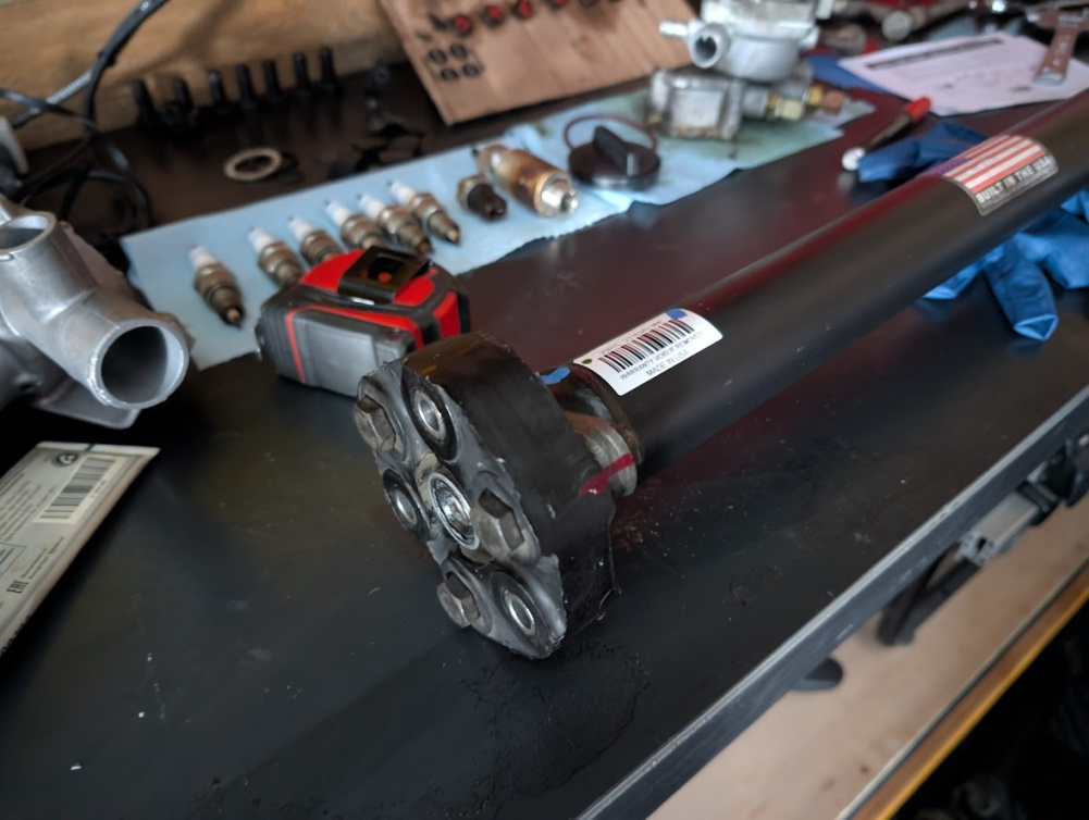

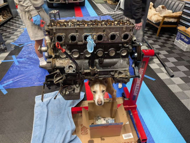

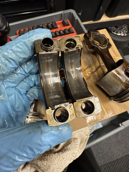

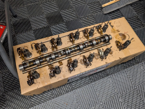

                  #53

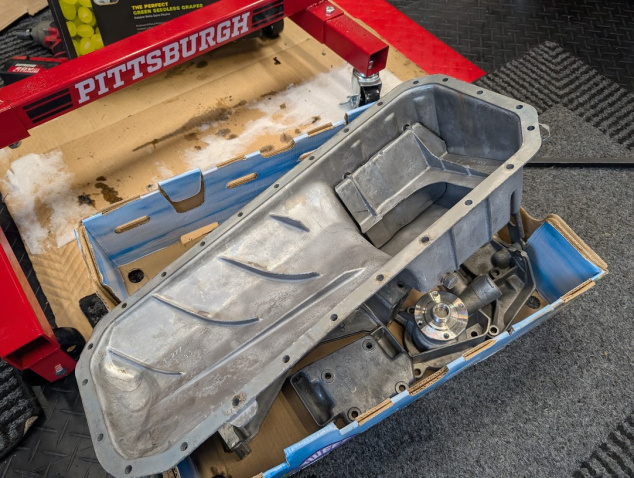

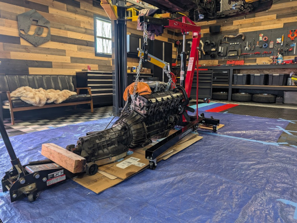

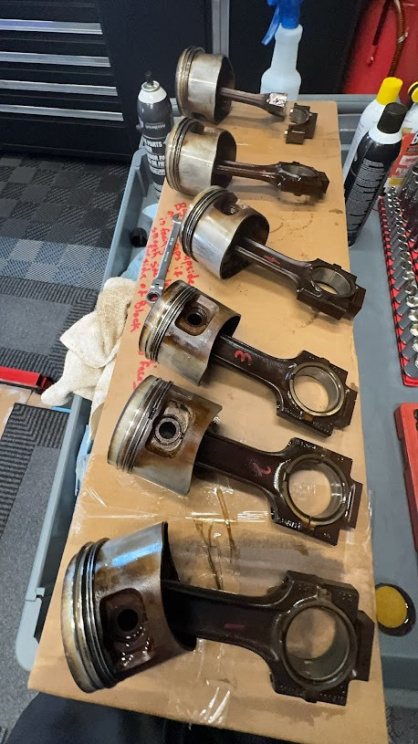

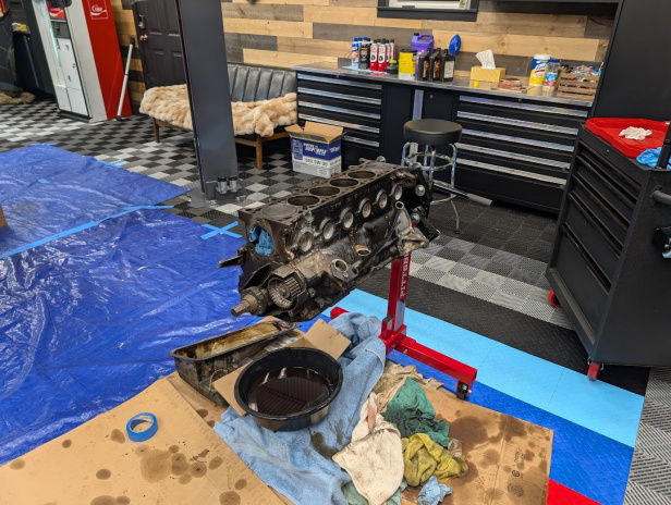

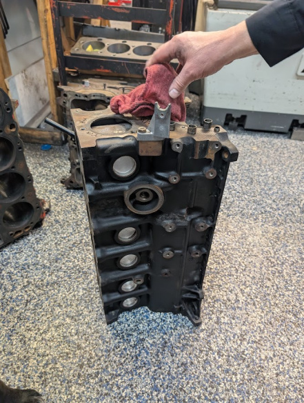

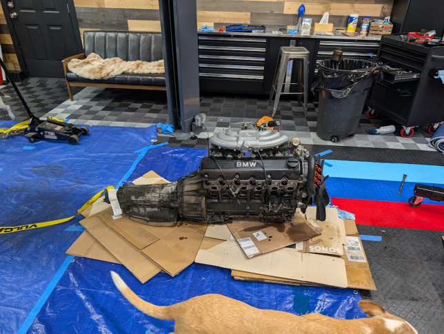

                  An update on things...
                  • Head is disassembled. Everything looks great except the intake rocker shaft, which had some marks on it (maybe from previous work done). Nonetheless, I purchased the set of rocker shafts from IE.
                  • Shortblock is disassembled. Having the block just sitting there, we decided to fully disassemble so we could take the block to the machine shop and have it cleaned, surfaced and inspected. During teardown, we found bad scoring on rod bearings of one cylinder. Mains and all other rod bearings looked fine. Some debris definitely made its way into this bearing. Yikes!
                  • All parts are at the machine shop, some for cleaning and some for inspected. In fact, we are already getting clean parts back and it feels so good to not be working with heavily-oil and greased coated parts. Talk about boxes and boxes of gloves and paper towels, lol.
                  • At this point we are waiting for parts to start arriving and for the machine shop to finish up the head and block.
                  Some pics for your viewing pleasured :popcorn:

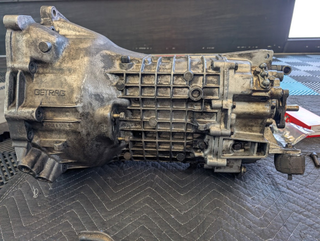

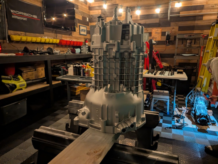

                        #56

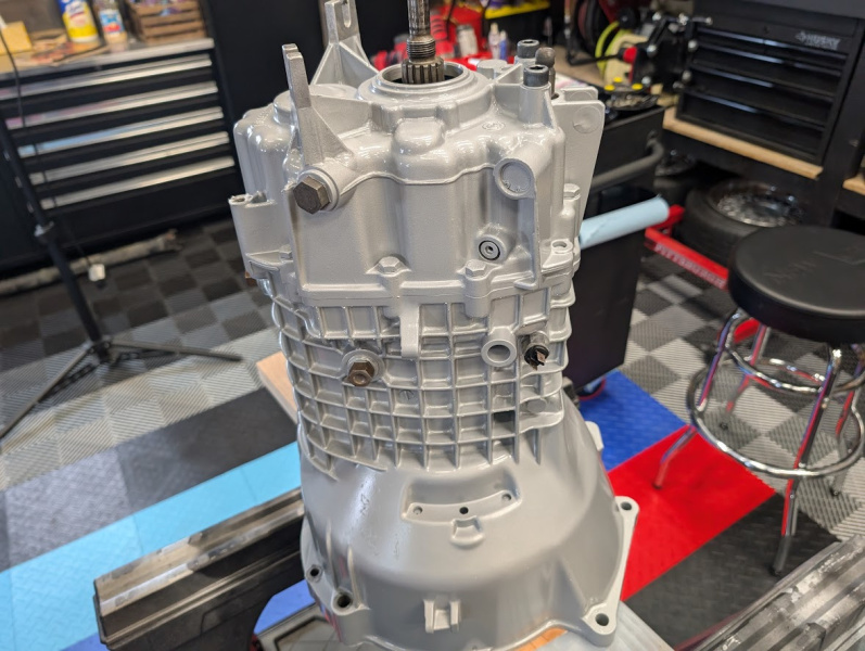

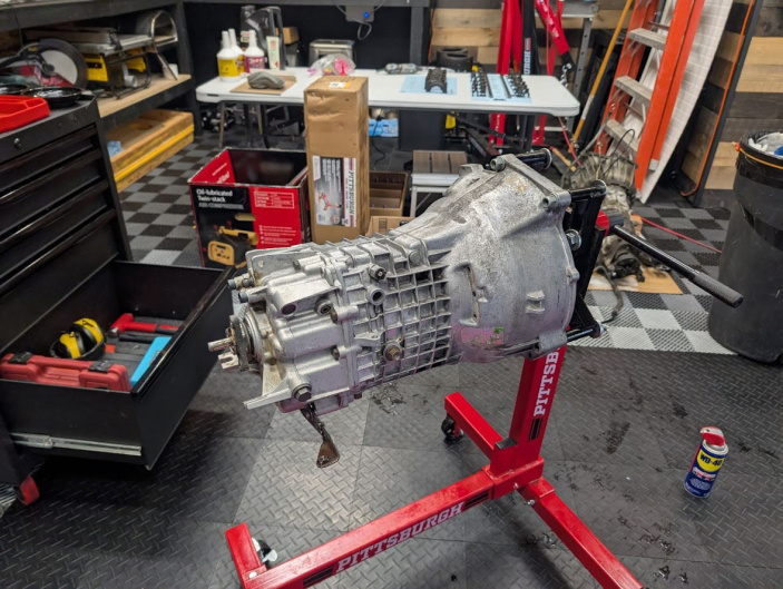

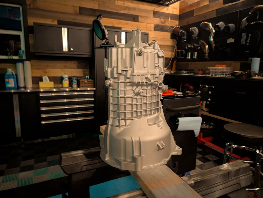

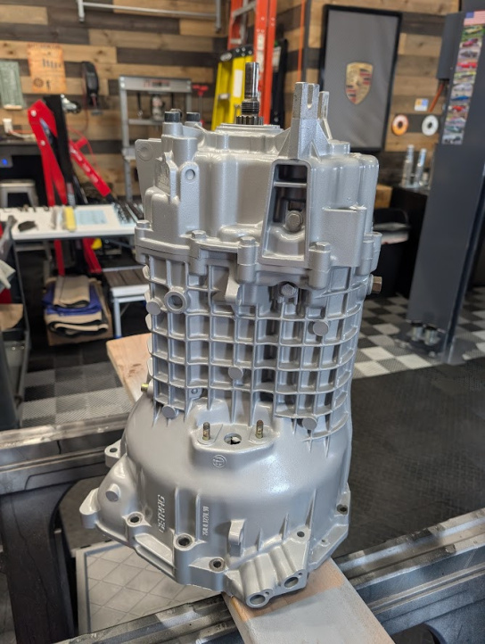

                        And just for fun because I'm blown away with how well this turned out, a few pics of the transmission from start to finish:

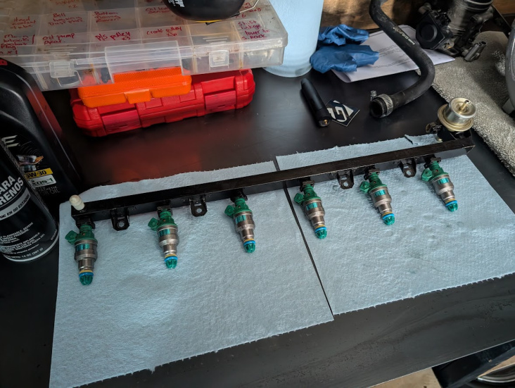

                            I spent some time tinkering in the garage yesterday. I used a 12v source to test and clean the injectors (found one oddball I may end up replacing) and then rebuilt them with new filters, o-rings and tips. I also received the manual trans drive shaft and installed the guibo and studs onto the ends. A little tattoo therapy was good for the soul as well. Will be finishing color on this next month. It hasn't been a bad week, considering.

                              HDT driveshaft? Thinking about one myself...
                              Originally posted by priapism
                              Originally posted by shameson
                              • m2d2
                                • May 2023
                                • 98
                                #60
                                I originally ordered a new driveshaft for the automatic transmission made by Trakmotive, and wasn't impressed. I returned it for this manual trans drive shaft and was pleasantly surprised at the quality: https://www.rockauto.com/en/moreinfo...&pt=2308&jsn=1
