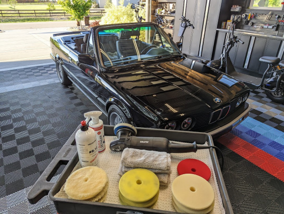

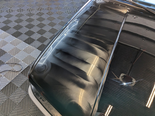

    I mentioned earlier this car will never achieve show car status. However, tonight, my friend is lending me his paint gauge so I can determine in which areas I can perform more extensive paint correction. Currently, I have no knowledge of which panels have original paint and which ones have been resprayed. In the meantime, I decided to perform a light polish to address the superficial water spots, haze, and spider scratching. I experienced the best results with Rupes Uno Advanced, which is a one-step polishing solution on a yellow foam pad. The results were as anticipated, with some improvement, but many of the deeper scratches and defects still persist.

      Much better! Just dont go with anything too abrasive. These 30 year old clear coats can only take so much .

        Thank you! Last night, I conducted a paint thickness measurement and obtained readings ranging from as low as 2.XX mils up to 30 mils and even exceeding that (referred to as "Overfill"). It appears the paint thickness is inconsistent throughout, leading me to believe that the entire car might have been repainted at some point.

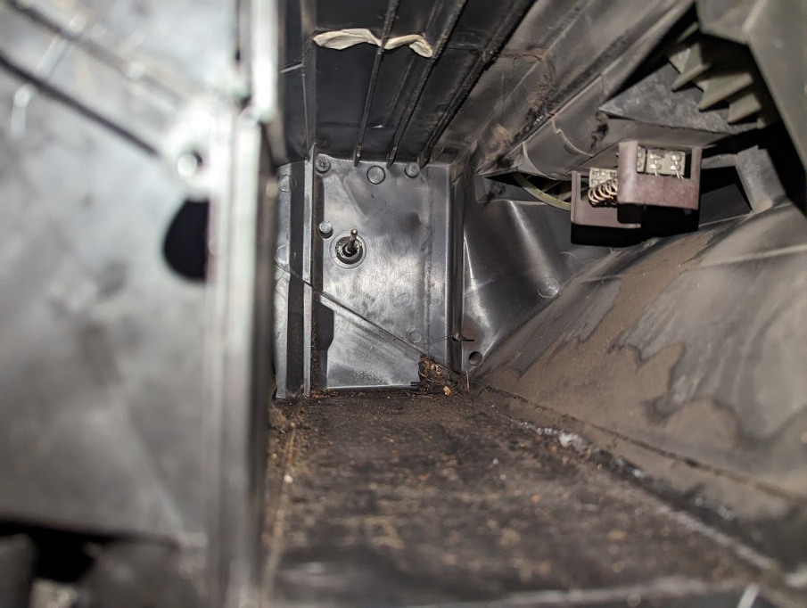

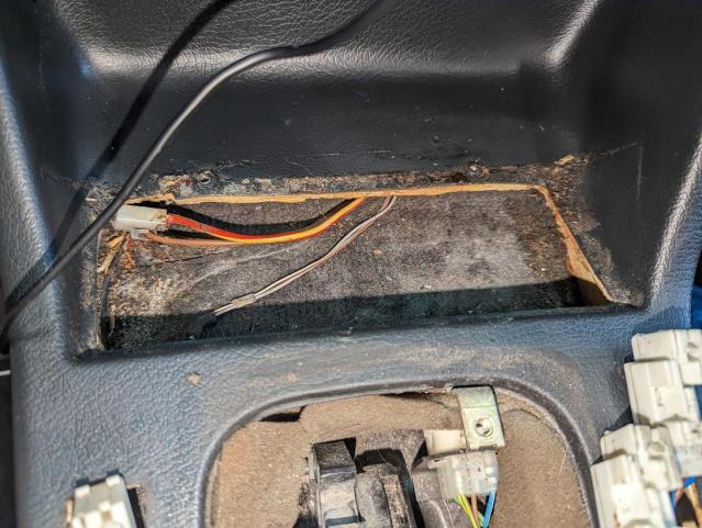

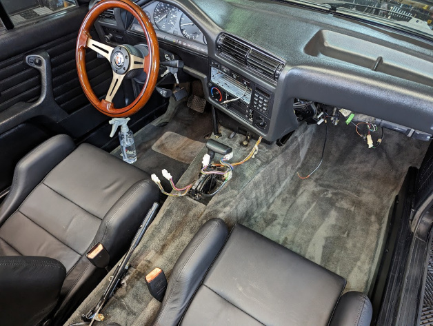

          After browsing through various forums, I encountered mixed experiences regarding the removal of the evaporator in convertibles. However, I decided to give it a shot. It didn't take long for me to realize that there wasn't enough space, primarily due to the location of the battery tray. In order to create sufficient clearance, I had to move and flex some panels. As I began removing the center console panels, I discovered numerous spills and food remnants accumulated over 30 years of use, not to mention bugs, cut wires, and broken screw mounts. Against my better judgment, I made the decision to strip everything out. I thoroughly vacuumed and shampooed the carpets and deep cleaned all the panels. To be honest, I had some assistance from my trusty companion, Harvey, who you can see pictured below :) On a serious note, my wife was a great support and helped me out, despite being grossed out by the whole situation.
          Anyway, now everything is clean and ready for installation. Moving back to evaporator removal, I managed to unclip a zip tie holding the main harness beneath the passenger-side dashboard and was able to wiggle the evaporator out to some extent. I couldn't remove it completely, and was about to give up when I decided to remove a few metal retaining clips along the bottom of the dashboard. This freed up an additional 1/8" to 1/4" of space, which was just enough to extract the evaporator entirely. I was astonished by the amount of mud, dirt, and debris that had accumulated on it. Considering its condition, I highly doubt the system would perform optimally without replacing it. While I could have rinsed it off and cleaned it, I've taken the advice of a good friend and HVAC professional to go ahead and replace it instead. I suspect that for those who have converted their R12 system to R134a and been unsatisfied with the results, this could potentially be the issue.

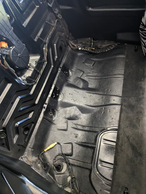

                  While waiting for the arrival of mechanical parts, I've been tinkering with the car. Fortunately, I successfully installed the new evap core without causing any damage, which is a relief. (For future reference, I have provided details on the installation process for vert owners, here). As for the interior, I decided to replace the old rear seat covers with new LSeat covers. However, I quickly realized that this task required professional expertise to ensure the best possible outcome in terms of appearance. In preparation for an audio upgrade, I'm collaborating with @e30dreamin to construct a sub box and felt inspired to incorporate some wood paneling in the trunk. While the seats were removed, a friend graciously helped scrub-a-dub-dub decades of accumulated dirt and grime.

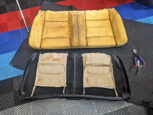

                    After ordering new rear seat covers from LSeat.com, I entrusted a local upholstery shop with installing them. I have to say, they did a great job and the outcome exceeded my expectations. The fitment was perfect, and I'm genuinely pleased with how it turned out. I must commend LSeat for their fast shipping and great product.
