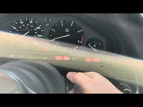

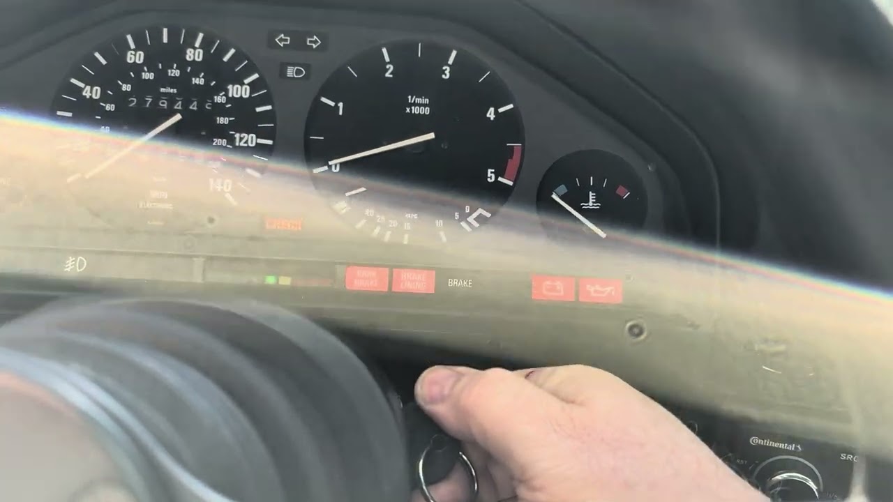

      Since the car got back from the shop after the conversion to the single high-pressure pump I've had what may be three problems:
      Had what felt like fuel starvation when I tossed it hard on an onramp. At some point soon I'll take it back to the shop to make sure the foot is as low in the tank as possible.
      There's a long-crank-no-start happening. Cycling the key a couple times seems to help, but not always. My shop wondered if there's a check valve somewhere that kept the fuel from migrating back to the tank after the car is off.
      There's what feels like a vibration/stutter in the throttle
