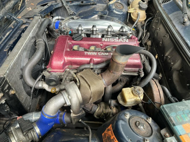

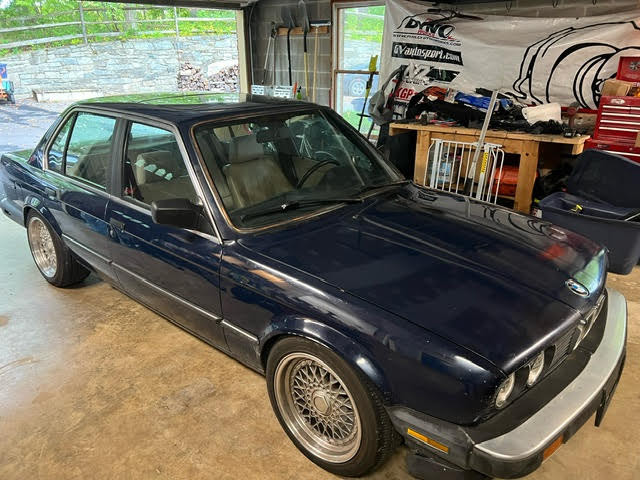

                        I thought it would be good to showcase the starting point. At some point, I will be playing "what does this connector do?" as there are several connectors in the engine bay just hanging out.
                        The engine bay, as it sits right now.
                        Click image for larger version  Name:	engine_bay.jpg Views:	0 Size:	170.7 KB ID:	10127752
                        The car in the garage.
                        Click image for larger version  Name:	garage.jpg Views:	0 Size:	113.2 KB ID:	10127751

                          Wow, lots of room for activities in that engine bay!
                          Strange seeing the intake and exhaust sides swapped from the regular E30 engines.

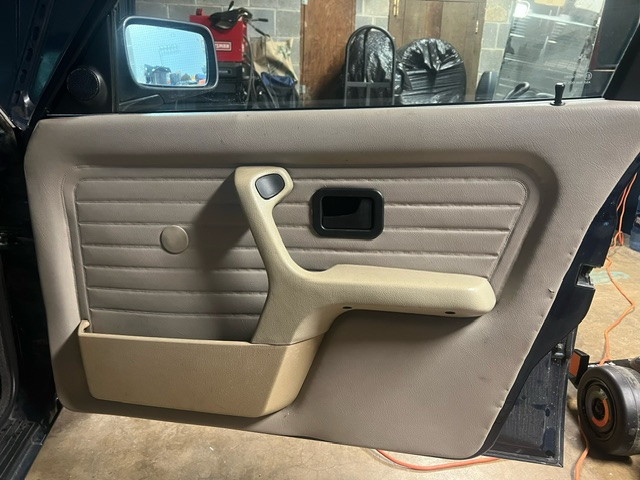

                            The interior of the car is not "terrible" but it does need some love. The door card on the passenger side was off and the interior door handle had been "hulked" off, the doors squeek, and the glove compartment is a rats nest of wires. At least it's not a real rats nest. So today in convinced myself that I would dedicate some time to working on the car, so In order to motivate myself I work up really early and drove to my local Cars and Coffee to get in the mood to work on the car. Having spent a couple of hours drooling at the 1970s RUF 911 that showed, I decide to come home at tackle the door card. I removed the door card, replaced all the clips as well as the door handle. Here is finished product :
                            It may not be impressive to you, but I'm pumped that I have a passenger door handle that works!

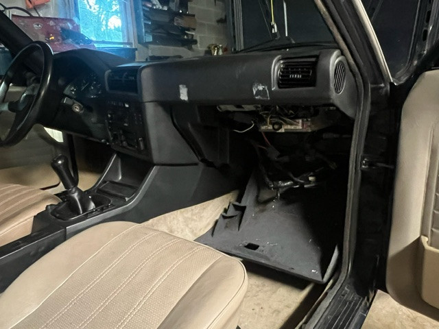

                            Next I need to figure out what I"m going to do to keep the glove compartment closed. I don't necessarily need a glove box to store stuff in this car, so I'm OK with it hiding the ECU and wiring. Eventually I'm going to migrate to Link ECU to run the SR20DET and will clean up the wiring then. For now I need to find a way to keep it closed. Contrary to what the previous owner thought, No duct tape is not going to hold it closed for longer than a day, tops. This is what it looks like now.

                            As a way to treat myself,. I pulled the car out of the garage, turned it on, and drove 10 ft. Then I parked it back in the garage. Soon The engine comes out and the real fun begins.

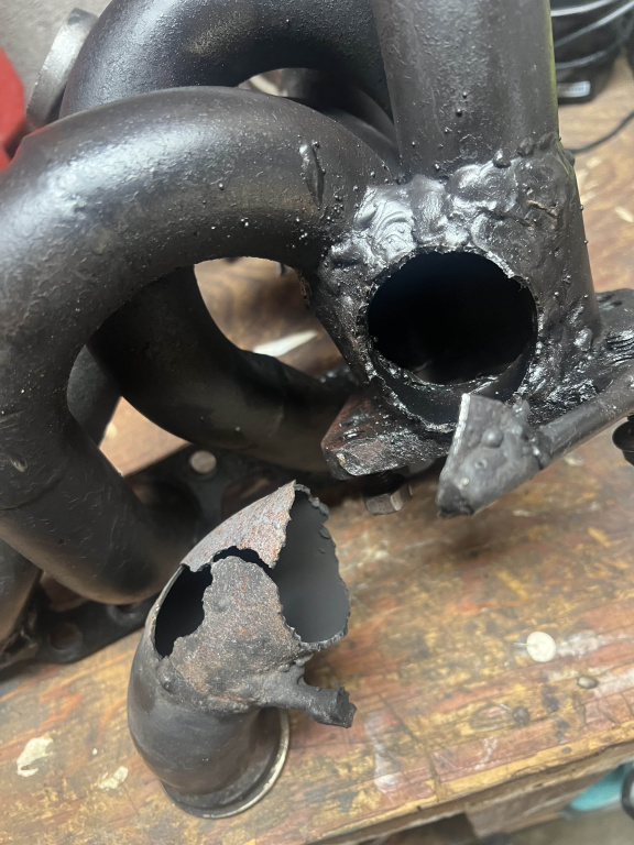

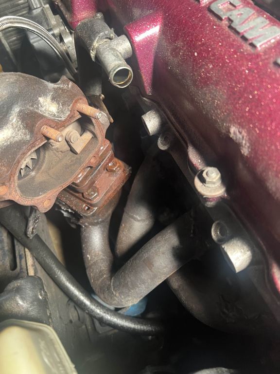

                              My goal for the winter was to pull the engine, but I'm quickly realizing that there are other things that really need to be addressed first. As I've mentioned earlier, the thing that keeps me from being able to actually drive this car is the cracks in the turbo manifold and the exhaust dump out of the top of the hood (its just not my vibe). So I've decided to tackle the hot-side of the engine.
                              The turbo manifold seems to be some knockoff EBay brand (maybe CX Racing) with a no-name external wastegate (not that it really matters, the section of piping the goes from the collector the the wastegate is falling off, so I'm not building any boost). The Turbo itself seems to be a stock turbo with a the internal wastegate welded shut.
                              Note that in the picture above, there should be a runner sticking out to an external wastegate, but it cracked off when I "accidentally" knocked it with a wrench. Here is a picture of what the turbo manifold looks like once it was removed from the car:

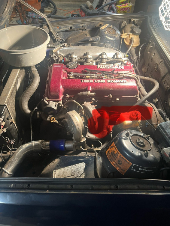

                              Clearly this needs to be replaced and I have two options. The stock configuration is a bottom-mounted turbo and the other option is to keep the top-mount configuration. The problem in either configuration is routing the exhaust. in the case of the top-mount, I have to go back along the head then down between the block and the brake booster. It is REALLY tight back there. So I'd have to either go with a smaller brake booster or remove it altogether (which I'm not too crazy about). I've seen folks have really good luck with retrofitting an e9x brake booster which is considerably smaller, so that is the route I am planning on taking for this build. Below is how I plan on routeing the exhaust.
