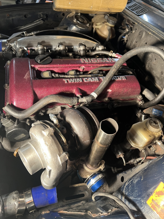

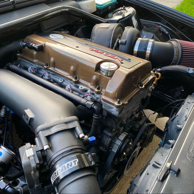

        That looks like a fairly clean E30 from the tiny glimpse we got, it's a shame the person who swapped it cut a hole in the hood. I can't find my pictures of the engine bay but I know a guy with an SR20 swapped E30 and he uses a top mount with a larger turbocharger than that (the car makes something north of 500hp). I think the turbo is a little bit further forward and lower. The downpipe goes down between the engine and the booster but because I can't find the pictures I couldn't tell you which booster it is. In any case, the vertical 4cyl and ample space is a great candidate for a DIY equal length divided manifold.

          I'm also disappointed with the hole in the hood, but all things considered, that may be the least of my problems. Pictures would be really helpful. I've been scouring the net for pictures of similar swaps.
          Generally speaking, I'm having a hard time figuring out what is going on with this car. Some things are very well done, but others it seems were done with bargain-bin E-Bay parts. I've sourced a manifold, turbo, and wastegate to replace the parts that were on the car. I plan on swapping to a e90 brake booster. I'm hoping that I can fit a 3" pipe between the e9x brake booster and the block.

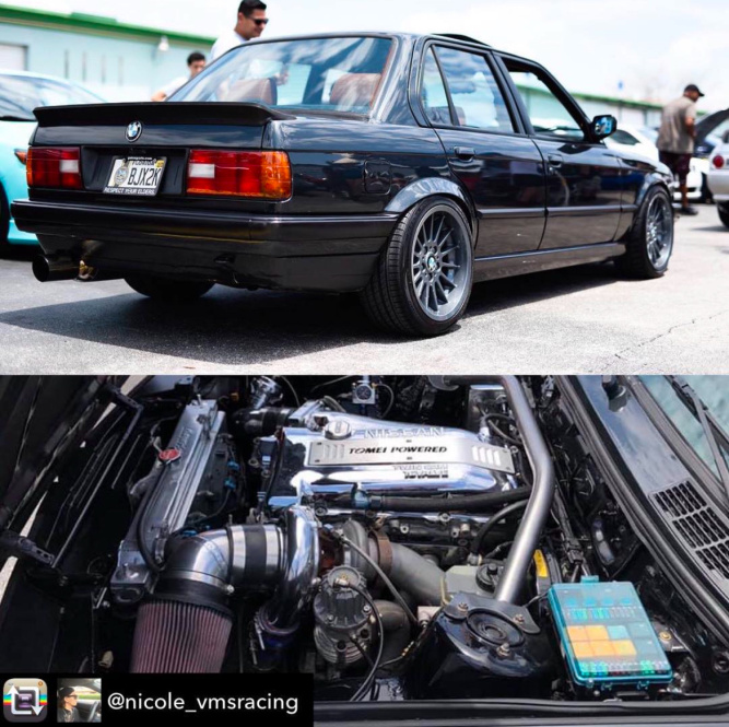

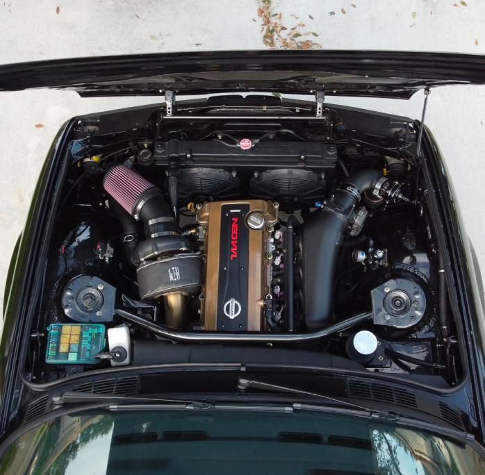

            The owner of the car I'm talking about is bigjamaican_e30 on instagram, older pictures are on bigjamaican25. You might be able to reach out to him and ask for more pics or a build thread link (I've never seen one). This is all I saw there and you can see the setup has changed a lot over the years, the third picture shows an old setup which clearly has a BMW booster in the stock (or close to stock) location and the later picture #1 things have been relocated for the larger exhaust and turbo.

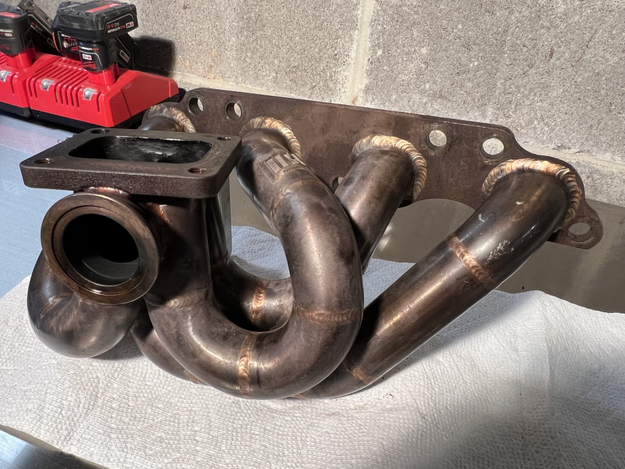

              If you are following along, you know that I've had a looming hot-side configuration debate for this setup... Well I think I've laid that to rest. In talking to some friends in the industry and getting some rough measurements for manifolds, I decided that I could make a top-mount work reliably and the market for top mount sr20det turbo manifolds seems to be plentiful.
              Ebay is filled with cheap manifold solutions, but I don't want to find myself in the same position down the road, so I decided to buy something a little more higher quality. After some networking, I was able to score a really high quality setup. The turbo manifold is made by Doc Race which is better known today for making 135i N54 turbo components. As it turns out, they used to make sr20det and 2jz manifolds long ago, and even though you wont find these parts on their site anymore, they are still coveted pieces in those communities. Behold the manifold:
              Click image for larger version  Name:	doc1.jpg Views:	0 Size:	314.2 KB ID:	10132469
              The welds on this thing look amaze! The collector is symmetrical the runner are very thick! this thing reminds of the FULLRACE manifolds that were popular in the Honda crowds in the mid-2000's. For comparison, It is almost twice as heavy as the cheap Ebay piece that came with the car.
