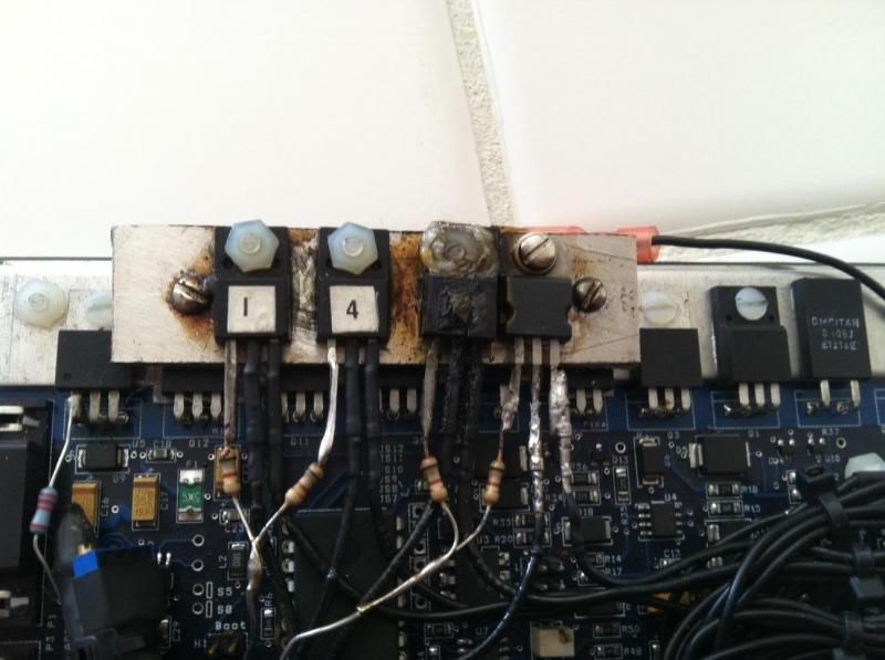

      Im dealing with a cold start issue and I cant get a decent start up with out extensive cranking. hot starts are almost perfect but cold ones sucks. If I crank to long it overloads my coil drivers and they fry. I ordered the updated ones that have a failsafe so this wont happen anymore.

          that would be great! also yes, the new updated drivers from diy are suppose to shutdown before they toast off.

              here is what im dealing with. Im on MS V3.5.7 This is a much older version but its still very usable.
              As you can tell, its clear which driver failed. When this happens it also shorts out the ignition coil so I will need to replace that as well.

                Yup, you had three vb921s and one BIP373
                  yep. I swapped out one vb921 when it fried. Now I just have to swap over the rest.
                  Ordered new from diyautotune @ $9 each.

                      got my new bip373s in the mail and installed them. Fired right up. life is good.
