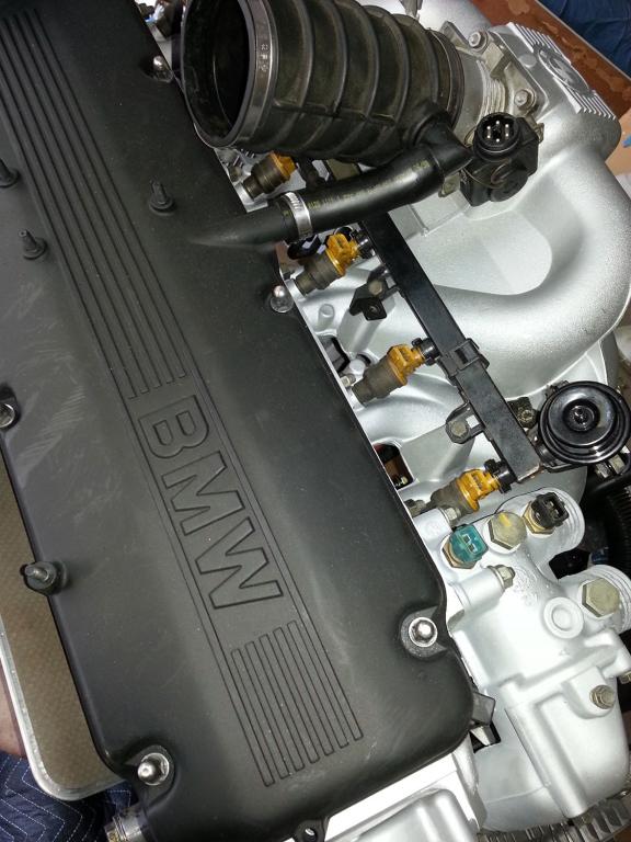

      picked up an m30b35

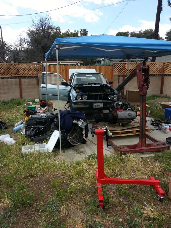

        started the m30 swap this past weekend.
        b35/getrag240, waiting for my flywheel.
