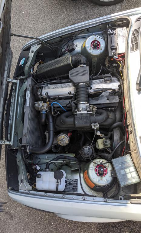

                        thermostat, hosing reroute, coolant reservoir swap and relocation.

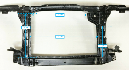

                          #132
                          working on a tucked radiator. dimensions for radiator support opening.
