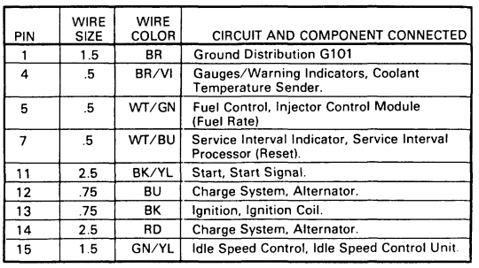

                        What modifications did you do to get the IE headers to fit?
                        Also, there is very little info on the wiring required to swap an m30 into an early 318 on the interwebz. Did you use a 320i harness or something?
                          isn't the only difference the square vs round c101?

                              Originally posted by AWDBOB
                              Cant wait to see standalone/ITB progress.
                              had to dimple the runner above the motor mount. painful to do that to a brand new set of headers but, it fits and it works + no one can see the dimple from up top.
                              this is the pinout. I spliced and soldered the harness, cut an end off of the harness from the junks.
                              Pin 15 has no use on the m30. It's kind of really trippy that the m30 can just run on the 7-8 pins off of the m10 harness.
                              Click image for larger version  Name:	e30 harness pin out.png Views:	0 Size:	92.6 KB ID:	9951175
