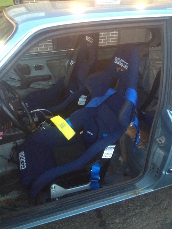

        Squirtle (the 2 door) has undergone a bit of weightloss as i've stripped the interior completely minus the dash and front center console section as its not a race car just yet.. I installed the Sparcos using Massive's kit and also had a harness bar made up and installed for me by Corwell Customs in Naperville.

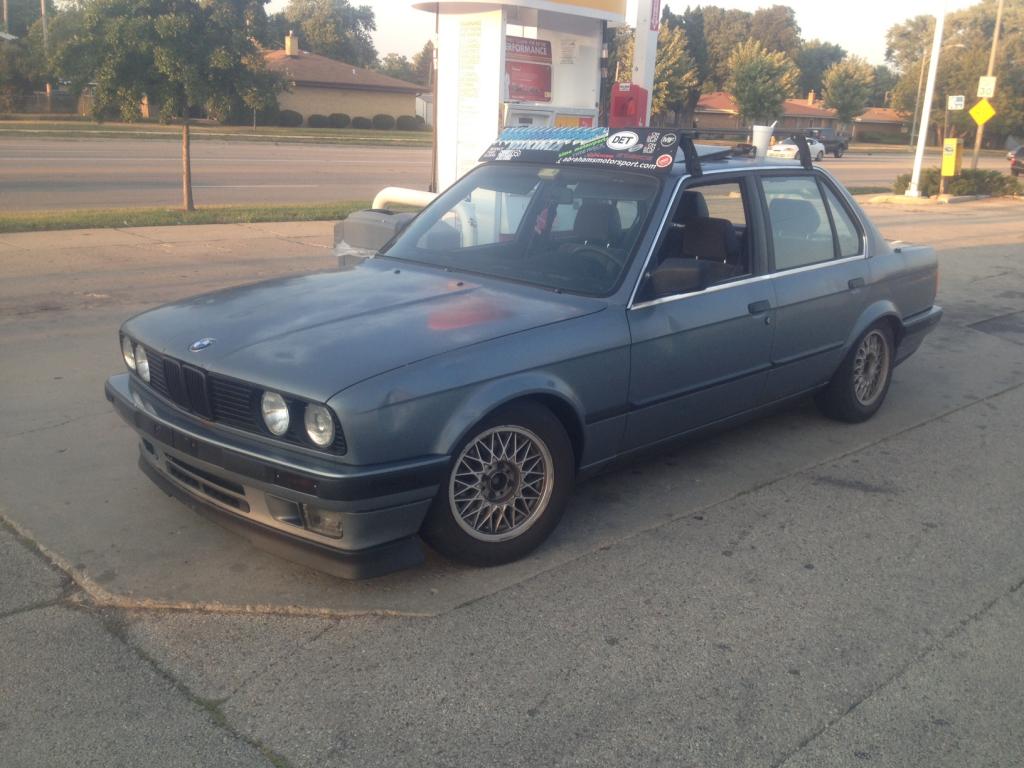

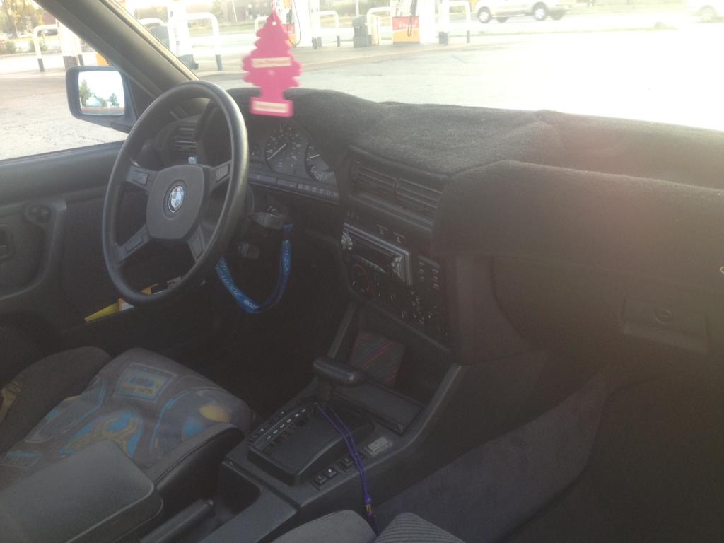

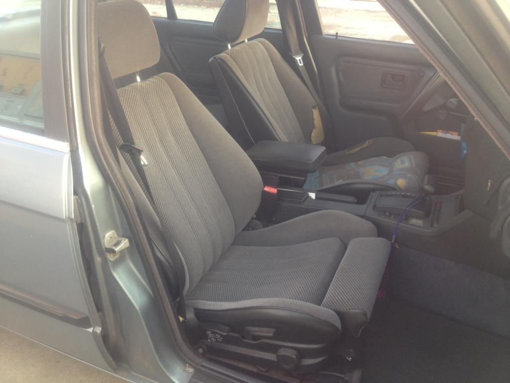

        The Daily received the interior transplant and looks and feels so much better. Still looking for a decent m-tech 1 wheel, but that can wait until after the manual swap.

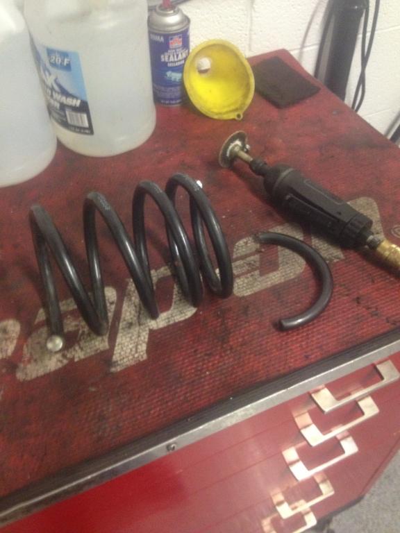

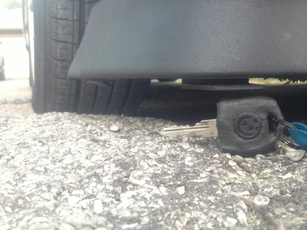

        I bought IE3s with e90 hats and bilsteins and successfully lowered my winter car, then decided it wasn't low enough so I cut half a coil off each end of the front springs, you know, because stance is cool and stuff.

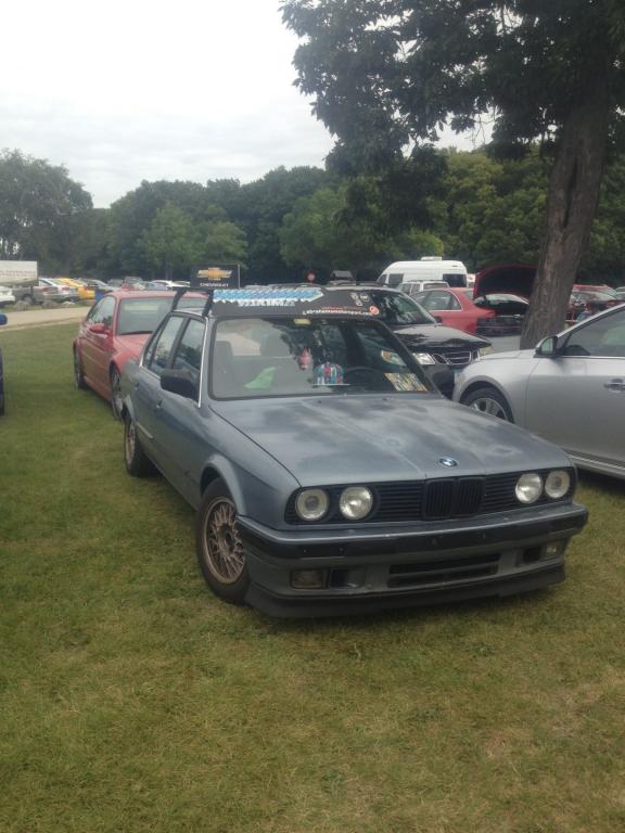

        And as if lowering it wasn't enough, I managed to find a volvo lip at the junk yard to make it a snow plow, we'll see how that works out for me...
        ^this was before front coils were cut, sits very nicely now.

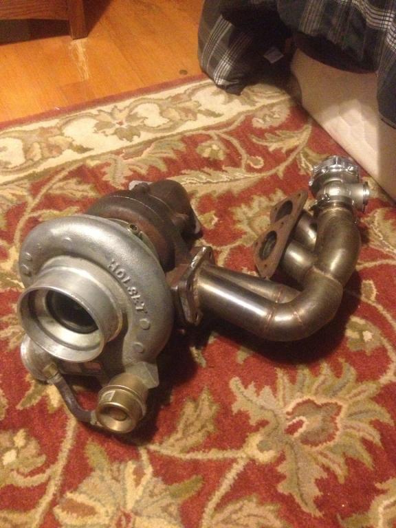

        And something recently arrived at my door...
        Hope everyone is enjoying my snail-like progress. I'll try to grab a few more pics over the next couple days to show what progress I've made

          How's the ride after cutting half a coil?

            with only 1/2 coil cut, isnt the spring sitting in the wrong position? its gotta make noise.

              I ran IE springs with 1 full coil cut. Handling on fwy was awesome. Street handling sucked balls. Seed bumps were the worst.
                  In the same boat here. Holy shit every bump and dip in the road..... Would never drive it as a DD like that.

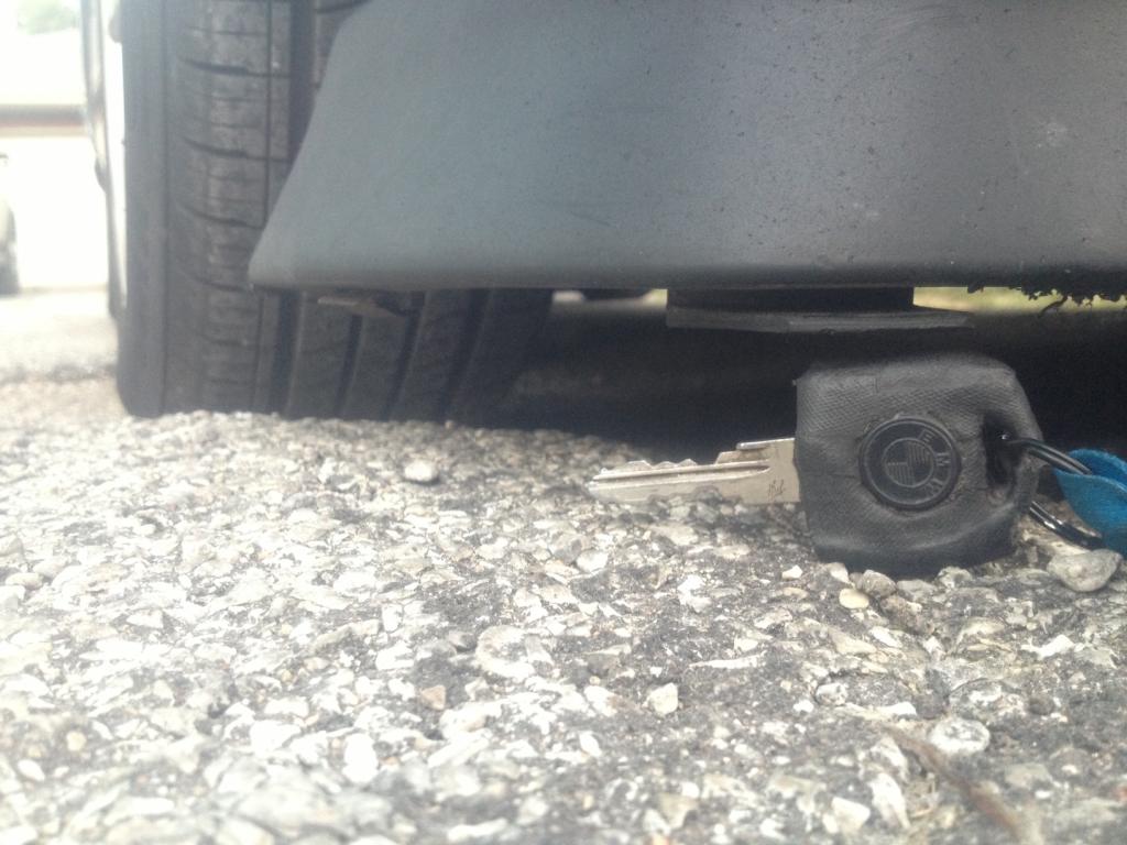

                        The upper spring perch (e90 drop hat) moves with the strut bearing allowing the spring to move with the strut when making a turn. Since it is both a lowering spring and a cut spring, I just have to make sure it seats properly when lowering it from a lift to be sure the springs don't get cocked sideways.
                        I'll try to remember to take pics net time I have it on a lift

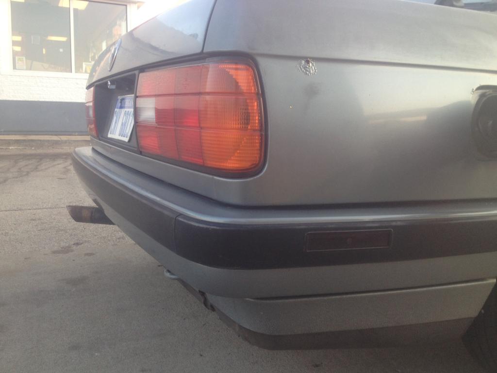

                        Anyways.. Snapped a couple iphone pics today after work...

                        Take a look at the plate and tell me if you see anything odd...
                        potholes in the driveway make me look hella low haha
