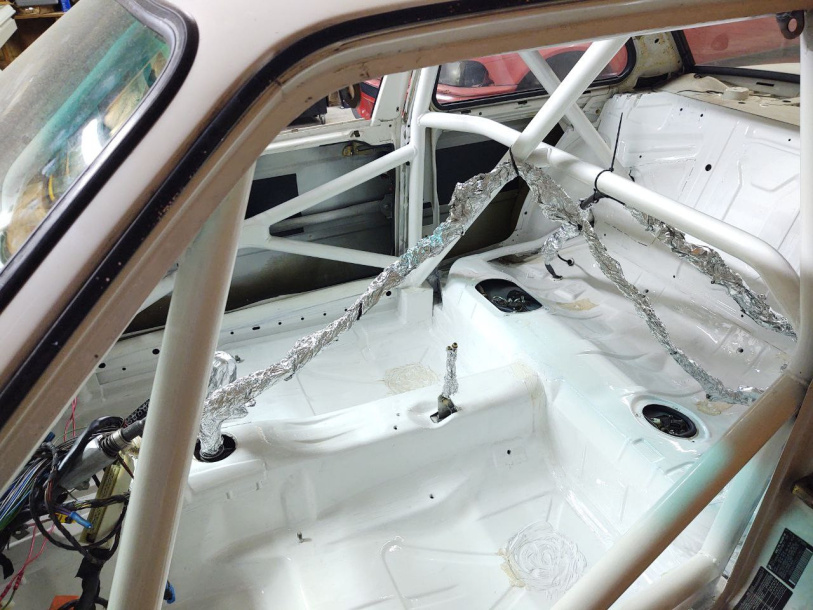

    Well, over 7 years later and this project finally got off the ground.
    I didn't turn it into a DD, in fact, I never registered the car.
    It's going to be an endurance race car now, and a friend and I are now co-owners. I wish I thought of that before I replaced all of the rubber with stock rubber.
    Hopefully we get this sucker up and running for an event or two in 2021.

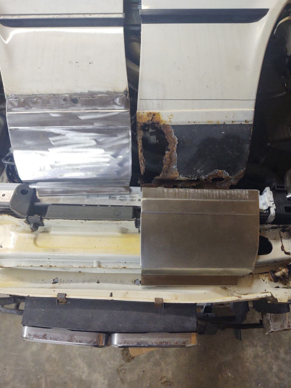

                      I had to address a fair bit of rust prior to calling the car good. The front fender bottoms were rotted, the front chassis corners were rotted through, and the accelerator mounting stub area was also perforated by rust, so it took a decent amount of cut and patch. It was a crash course in metal working with minimal Harbor Freight tools.​
                      Click image for larger version  Name:	photo_2023-01-18_21-54-30 (2).jpg Views:	3 Size:	159.7 KB ID:	10082137
                      OK, all painted with Rustoleum Appliance Epoxy. It hides a lot of the ugly.
                      Click image for larger version  Name:	photo_2023-01-18_21-54-30.jpg Views:	0 Size:	216.2 KB ID:	10082136

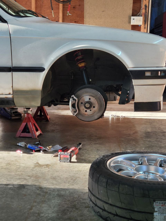

                      Car is on an inherited GC coilover conversion kit, PFC 11 pads, Ate front calipers.
                      Click image for larger version  Name:	photo_2023-01-18_21-54-30 (3).jpg Views:	0 Size:	170.1 KB ID:	10082142

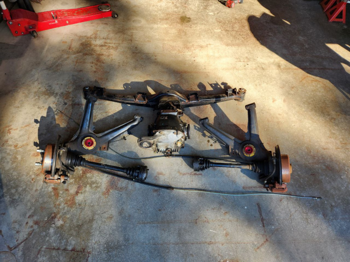

                      Dropped the rear subframe to replace the subframe, trailing arm, and diff bushings with AKG 75D pieces (not shown). The differential was rebuilt with new seals, new bearings, new crush sleeve, and new clutches and steels.
                      Click image for larger version  Name:	photo_2023-01-18_21-54-30 (5).jpg Views:	0 Size:	205.0 KB ID:	10082139
