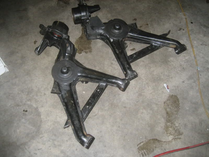

        Here you can see the difference.
        z3
        E30
        Just looking at that would lead me to believe the axles are different as well (z3 being longer).

            Yeah I have z3 hubs on my e30. I'm talking about where the cast portion is welded to the stamped part. you can see on the z3 its about 3/4"-1" wider.

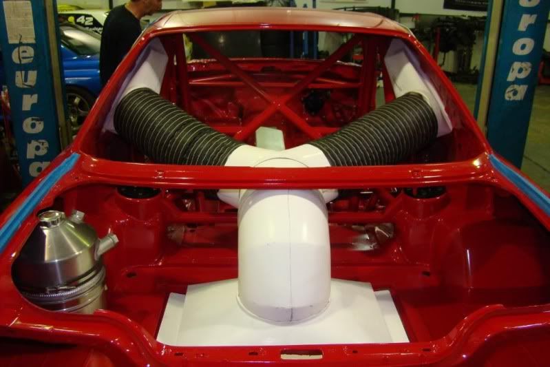

                              btw i hate to be a debbie downer but i don't think you're gonna have enough airflow going to that radiator
                              assuming your naca ducts use 3" tube (7 sq.in each) and your scoop on the rear window is a generous 24"x6" (144 sq.in) your total radiator intake area is only 158 square inches. it's been a while since i had to figure this out, but based on the pictures i took (with measurements) the stock radiator opening is about 340 square inches on these cars.
                              guys have problems staying cool with m60's using z3 radiators with the airflow they get, who knows what kinda issues you're gonna run into with such tiny piping.
                              IMO ditch the teeny naca ducts and turn your entire quarter windows into ducts, like what these guys did
                              add that to the roof scoop you already have and i think you'll have more than enough airflow

                                #75
