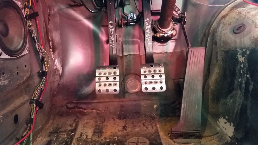

        got my wilwood pedals installed thanks to the garagistic mount, he was having a sale
        still need res's and lines
        anyone ever made a aluminum gas pedal, one that doesnt just clip on?

          i imagine it'd be pretty easy with some sheet, a little stock and a hinge for the mount at the floor. can you weld aluminum though? not sure how else i'd attach the sleeve for the throttle linkage

            i can weld aluminum, just looking for ideas...
            i kinda regret not just buying the full pedal box floor mount but it was way more money iirc

              Aluminum pedal would be cake to make.......hmmmmm..... add a foot hook to it as well.

                Pedals look good, I have the same setup for my car. got them used with all the res' and MC's for $275. making a copy of the garagistic bracket off a buddy.

                  #83
                  sorry about the foot!
                  i was going to make my own bracket also but really didnt want to spend that much time under the dash test fitting and what not

                      I wouldn't screw with the bracket either if I didn't have one to make a copy from.
