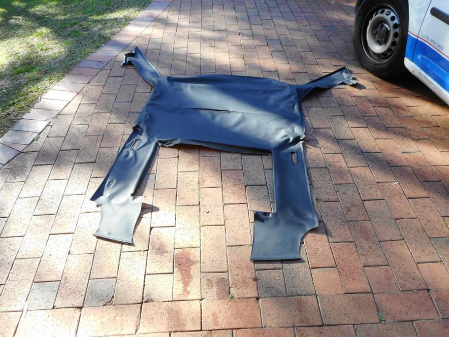

                The end result: delicious iS spec headliner removed intact.
                Unfortunately the sunroof part didn't make it due to tearing when I touched it. Hot Australian summers take their toll.
                May end up fitting a CAtuned black headliner anyway.

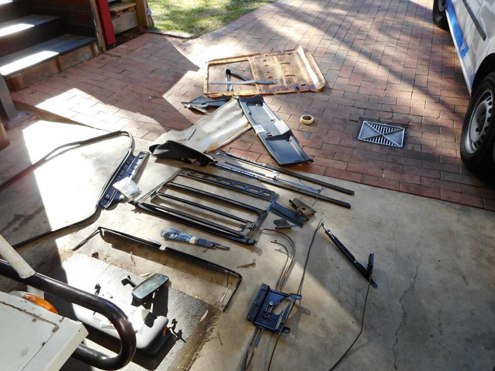

                All the sunroof shit I had to remove. Going to be a nightmare to replace. Do have new sunroof cables to fit though, which is dandy as the ones I removed had heaps of cracks in the plastic slider bits.

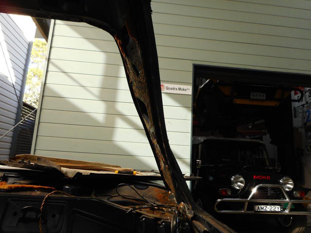

                And here's the bit that I really needed to see: the inner C pillar skins. They're not bent badly at all which is really promising.
                Basically the plan is for the panel beater to section the outer skin and remove that, put the thing on his laser aligner thing and pull the roof to correct position, then weld in the replacement C pillar skin that I have.

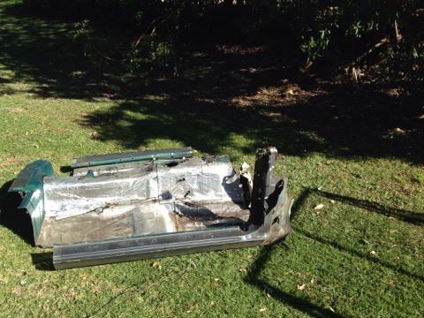

                Take note r3v, this is how you do a part out. The remnants of the 318i that I cut up. Everything else was used.
