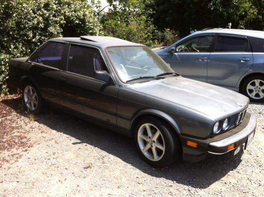

    This is what it looked like when the tow truck dropped it off, and before I lovingly washed it then let it sit for a month and get dusty again.

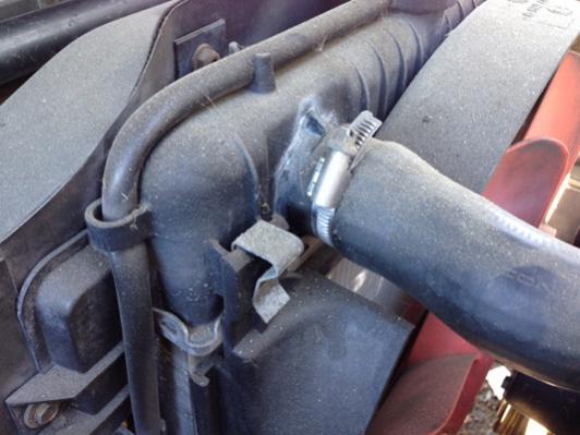

    We paid $400 for it non running, but it looked very promising. It had a cracked radiator right at the intake barb. We glued that and test drove it and the thermostat didn't open so it got hot (about 3/4 on the gauge) and blew the barb off completely. Glue held fine though! Brittle plastic and all that... Bought a new radiator and thermostat and it was back up and running, except it was idling at 1300 rpm. I drove it for a week while waiting for parts etc and it ran just fine, just high idle.

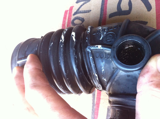

    I couldn't smog it at the high idle so I replaced all the small vacuum lines and taped up the intake boot, but that didn't fix it. They wouldn't smog it with it taped up either.

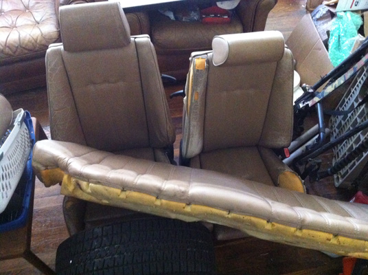

    Bought a set of sport seats, from a member in San Jose, to replace the nasty comfort seats. The hinges and sliders needed to be repaired, greased, and I chose the best four gas shocks to install. I swapped parts off my comfort seats which worked decent but they're ugly. The car's previous owner was maybe a little bit of a tweaker, found some meth baggies, and the repairs are classically bad. I was wondering about seat fitment too, look at the rear seat, the middle seat belt is reversed on the sports vs the comfort. I had to swap the middle one so the seat belt latch would clip in to the seat. How was it originally?

    nice intake boot.

      Haha thanks, posting from ipad and it messed up the image uploading.

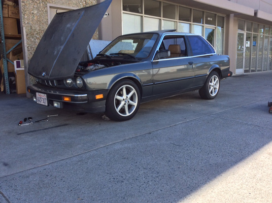

        So here are more pics and some questions.

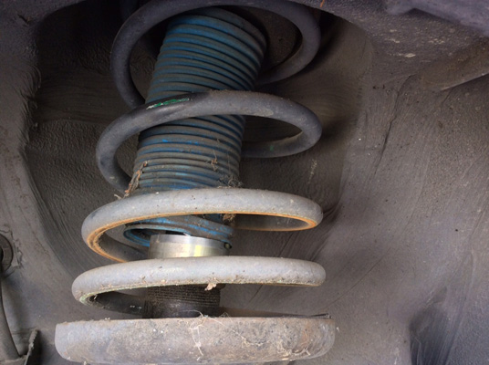

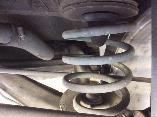

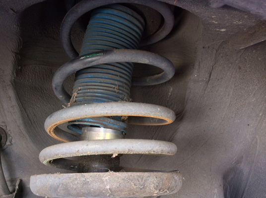

        What shocks and springs are these? The front look lowered and rebuildable, the back look probably stock. The springs are covered in dirt but are green under that. Haven't foamed them up and washed them to look for brands or specs yet.
        Ride is stiff and pretty flat cornering, harsh bumps. Wheel shakes at 45-60mph but I'll be starting with those M3 bushings and an alignment when I get new tires.

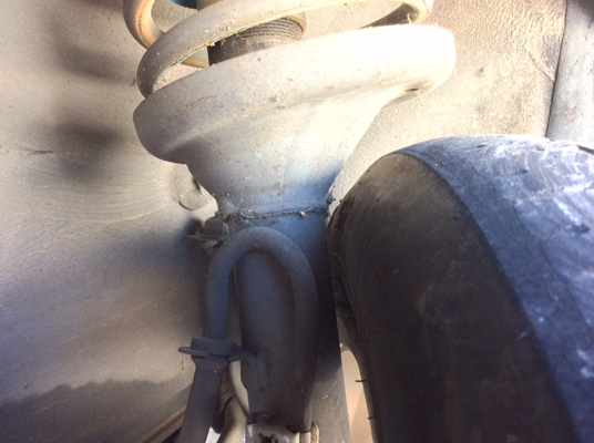

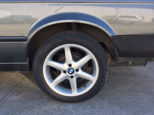

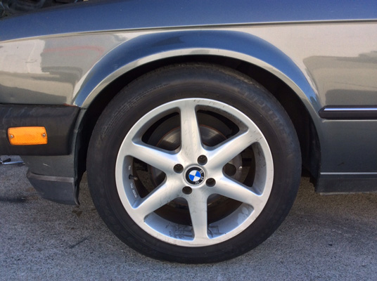

        The wheels are some Borbet type C replicas, they need new tires and refinishing pretty damn bad. The tires on it are 205 55 16 and they almost rub the struts. They probably rub while cornering hard. Would it be worth it getting a narrower tire or just a stiffer sidewall? What about getting spacers? I don't care about being hella flush, but a lightly lowered and flushed look would be nice. My matrix has the same size almost new tires but without the pooched out sidewall and I figured I'd put them on, but trying to sell that car so not sure what to do.

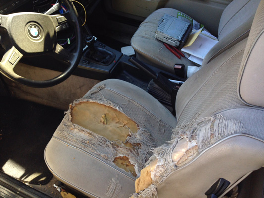

          Old comfort seats. Full of tears and meth.
          New sport seats. Ripped and needed the hinges fixed/swaped, but way more comfortable and supportive than the bowl of jello they call comfort seats.

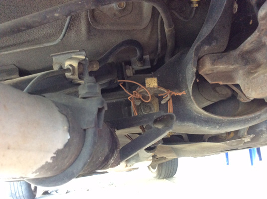

          The exhaust needs new hangers, but the bailing wire the previous owner used seems to work fine for now.

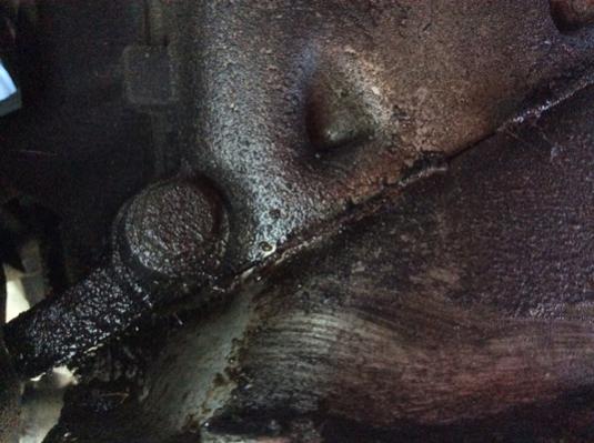

          Upper oil pan leaking pretty well. Parts of gasket just missing.

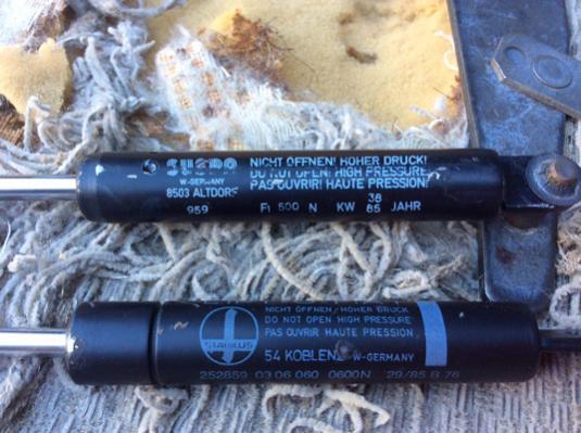

            Need new gas shocks, 1 out of 8 were good enough to reuse. And I broke half of those stupid push nuts swapping them around to the new seats.

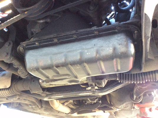

            Wiped off the 25 years of oil and road grime on the oil pan looking for the leak. Might need a new steering rack, previous owner said it was gushing fluid and he used stopleak on it... I think he just over filled the oil and it all squirted out the gasket. Steering rack doesn't seem to leak, but I might need new tie rods, these have some play. (well, something has play in the steering somewhere, haven't chased it down yet.)

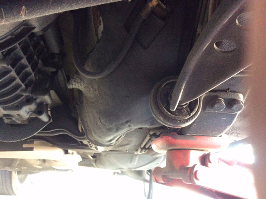

            Need new alternator mount bushings. That's a thing? Weird, BMW, weird. Dont have a pics of clapped out bushings so here's another of the car and it's stellar paint and dent free body.

              Done! Install exhaust donut and double d hangers.

                If the springs are green, they are probably racing dynamics. Struts look like bilstein sport, but can't be sure just from photo. Good start, have fun with it!

                  Hey thanks, your sig looks really clean and a lot like what I'm going for. What are your suspension and wheels/tires?

                            you don't want narrower tires, you want shorter.
                            205/50-16 is correct rolling diameter, and will probably get rid of your rubbing.

                              Yeah, I used one of those online calculators and it seems that the diameter of these tires are about an inch larger than stock.
                              The problem in the pic is the sidewall is just 3/16" away from the strut, the little fingers from the molding process actually touch the strut tube. The tires from matrix would probably get put on here since I can't afford new ones. They're some bravuris 2 brand and only 6 months old.
