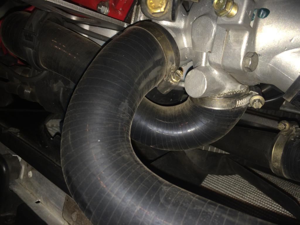

          So lately I've been battling my mechanical fan eating my coolant hoses. The clutch on the fan seems fine and so does the water pump. Initially I thought just replacing the hoses would solve the issue of a pin hole in my coolant hose off the thermostat. This pin hole happened because the fan is hitting the hose and eventually working its way all the way through it.
          Well moving forward, I replaced the hoses with nice new silicone hoses from I.E. I'd say about a week after installing these and everything was running smooth I smelt coolant one day after work and also my belts were audibly slipping. So I pulled my car over immediately and check to see why this was happening.
          As you can see, the fan once again ate ahold through my hose.
          Moving forward I was able to get a replacement for that hose from I.E. again. I replaced the hose and then made the decision to do away with this mechanical fan. In the meantime I made some protection from the fan.
          You might say it's ghetto, I say it's necessary till I can get my fan replaced. I've driven the car only in limited fashion lately, but have now got what I need to install an electric fan.
          Today I should have progress on that. I'm going to pull both fans out and install a 14" electric fan. It will be setup as a puller fan inside the engine bay and wired directly to the aux fan switch which I've replaced for an 80C-88C switch.
          I know there are a lot of write ups for this procedure, but it seemed most simple just using what's already there. My AC doesn't currently work and I'm honestly thinking about getting rid of it, so for now this is hopefully going to be just fine.
          If anyone has some advice to give me I'm opened to it, but from what I've read this should be enough.

                I had the same problem with the same iE hose not fitting close so I cut a little off the end where it connects to the t-stat. Also if your missing the clip that holds the hose to the engine hook plate then that would cause a issue too. (Top left is clip)
