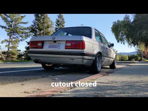

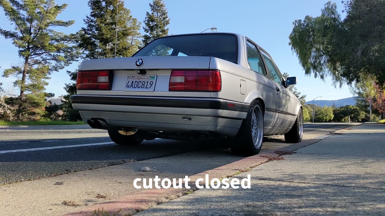

      Long time no see! Did some things to the E30:
      • Smoke tested the intake tract- no leaks
      • Cylinder 1 misfire code is now gone- Hooray!
      • Vibration at idle remains- Boo!
      • Bought LED bulbs for the headlights- OMG so much better
      • Installed a new keyless entry- the fobs for the old one stopped working
      • Bought a larger front swaybar from Garagistic on a whim because of their Black Friday sale. Turns out it was legit 1mm bigger than my current cabrio swaybar... :sadface:
      • Tried out AKG 70A poly motor mounts- no better than the Revshift
      • Moved on to stock E36 mounts flipped upside down- took some work but they fit
      • Went back to stock trans mounts as well
      • Modified the mid-section of the exhaust
        • Cut out the huge straight through Magnaflow muffler
      • welded up the pin holes at the flanges- oh the boogers!
      • replaced the old muffler with a 3" race catalytic converter
      • Reinstalled the driveshaft tunnel shielding
      • Exhaust sounds even better- videos to come
      • She continues to make advances, albeit slowly and with much expense
