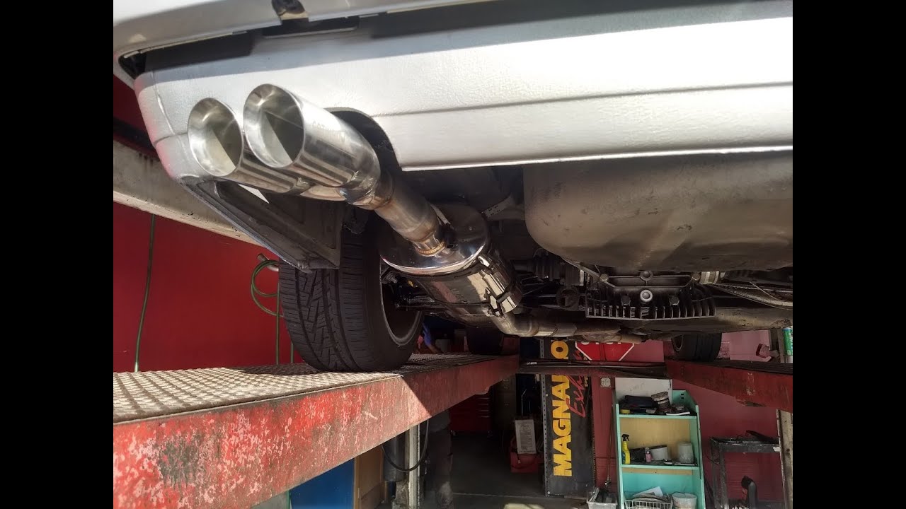

                  Finished up the exhaust this week. Amazon delivered the dual tip on Monday so I rushed to an exhaust shop after work to get it installed.
                  The Varex muffler thankfully has a flange on it, so I had them keep it to make things more serviceable.
                  While it was up I also got to see how the suspension looks fully compressed. No dead coils and a good amount of available compression.
                  All in all it went pretty well, but unfortunately I could only see the fitment from underneath. With the car back on the ground I feel like it needs to go in about an inch. Oh well, easily fixed.
                  So I didn't mention it earlier, but when I had the Lukebox out to do the rear suspension, it took a small spill and the sub ended up ripping it's screws out. This is mainly because the box cutout for the sub was slightly too large. This had been a known issue since I bought the box, but I had just been living with. I took this as a sign to finally find a sub that would fit correctly, and after some research ended up with a 12" Image Dynamics IDQ. As you can see I ended up installing it 90* offset due to the old screws ripping out.
                  While I was in there I hooked up the rear speakers to the stock deck, and painted the rear parcel shelf, as it had faded quite a bit. Need to find a UV resistant fabric to wrap the parcel shelf. Oh, also painted the sub ports.
                  While I was figuring out the rear speaker wiring, I also took the opportunity to run wiring from the muffler up to a switch above the deck.
                  Switch doesn't quite fit and will need some trimming, but it'll work for now.
                  Why on earth would I need wiring for a muffler you ask? Because the Varex muffler has an internal cutout! Honestly at first I thought maybe I had it wired incorrectly, because it was so quiet when opening the cutout, but after driving around for a couple days its really started to open up. It actually provides a decent amount of volume reduction for a straight through muffler when the valve is open. Videos to be posted next weekend.
