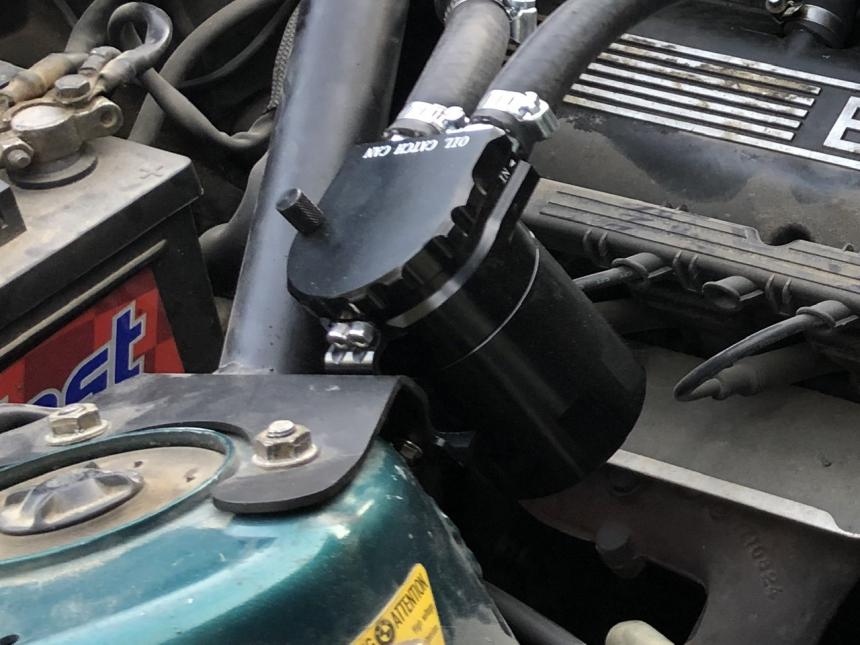

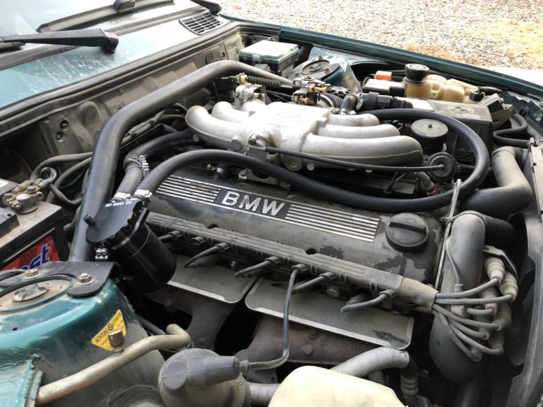

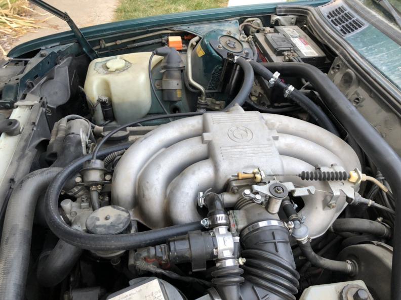

                            Replaced all the hoses, and added a catch can. I’ll empty it in a few weeks to see how full it is. I have a new o2 sensor to put in, but I ran out of time.
