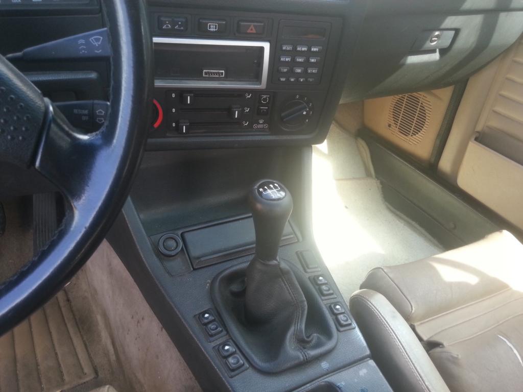

It has the BBS alloys that I wanted on the last vert I had, so that's a plus! Some curb rash, but that's to be expected. Has all the center caps, so that's good too. New tires, brake rotors, pads and calipers. Drives straight and there's no squeaks to be heard. Just the typical vert noises. Top components rattling and whatnot that I'm used to.
Interior definitely needs work, but I really don't wanna replace the front seats because they're heated, and that's nice in Colorado winters. Our old Audi A6 had heated seats and those were a godsend. The rear seats are trash, so I'm gonna see about restitching and getting some covers. other than that, the dash has fewer cracks than the last vert, so that's nice, I suppose. A/C works too.
