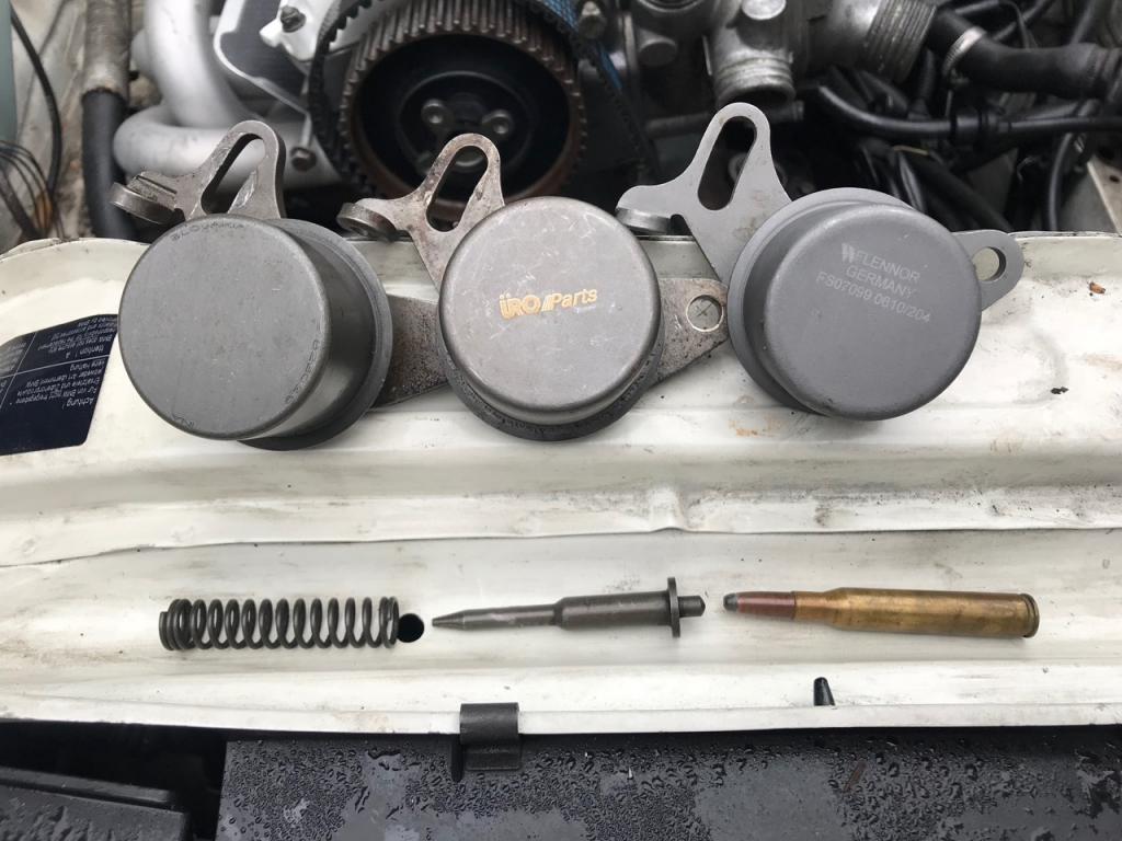

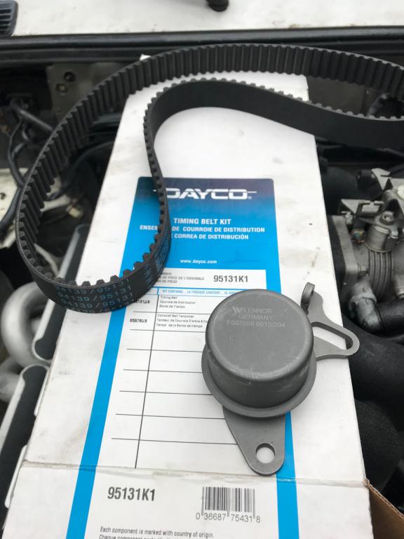

    Now, back to the pictures. Here I go installing the fresh timing belt and tensioner. The belt is American, the tensioner is German. I now have a little collection of functioning tensioners.

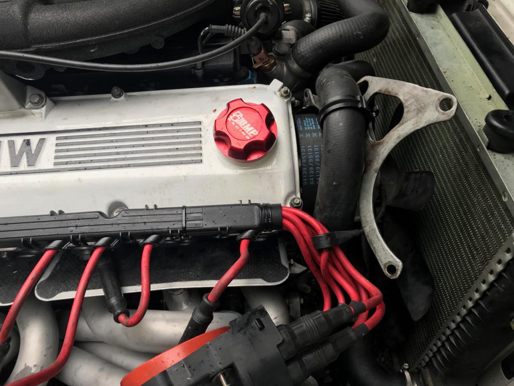

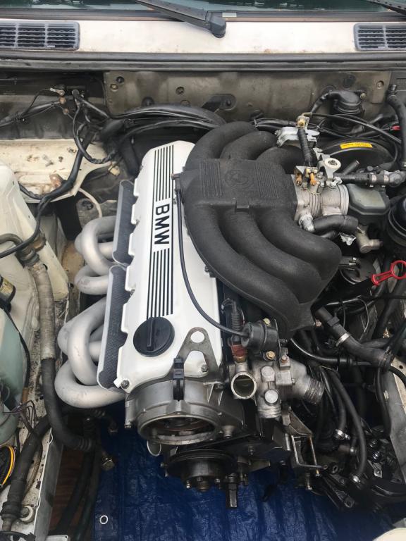

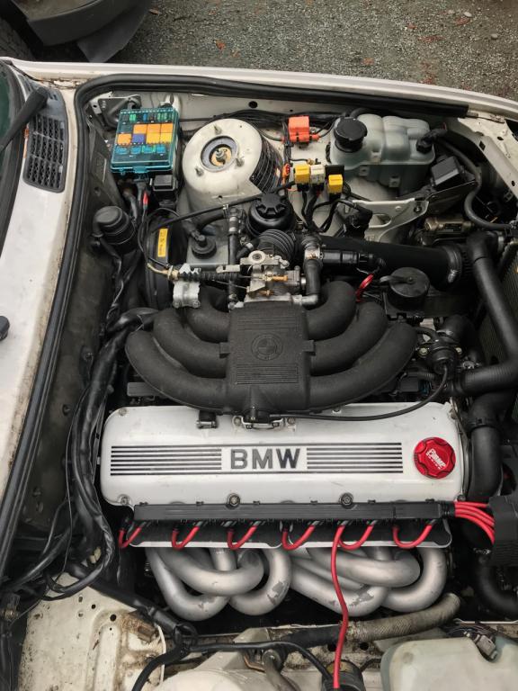

      Locals will know that today is the last dry day of this remarkably dry spell of weather we've had in the Seattle area (excluding last night's brief rain). Since I'm doing all this outside, this is my last day to button up the project before the fall/winter/spring perma-rain arrives, so I need to hustle.
      Here's where I am today. Just need to bolt up the remaining pulleys, fan, radiator, attach the spark plug leads and rotor, coolant/heater hoses, ancillaries like PS, AC, alternator, their attendant belts, and the replacement (intact) harness. Oh, and the exhaust. I swapped in the other bundle-o-snakes, because they fit better than the prior IE long tube headers in the engine bay. Switching headers means I'll need to attach the rest of the exhaust system that goes with it, which I'm glad I got with the extra engine.

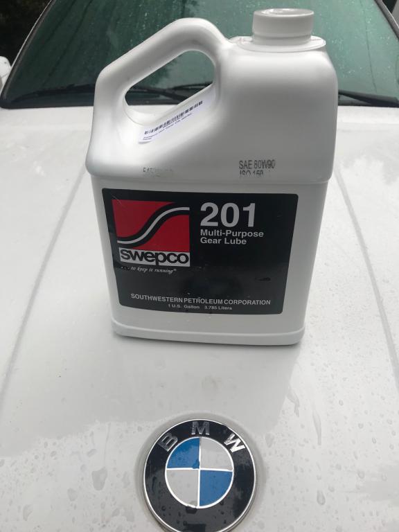

        Now that it's raining, work is going to slow down. Took refuge under the car, and changed the new-to-me transmission's oil as part of my effort to baseline it. Don't know what was gear oil was in it, but it probably wasn't any better than Swepco 201. German cars love this pretty blue/green stuff. Gonna put it in the diff, too.

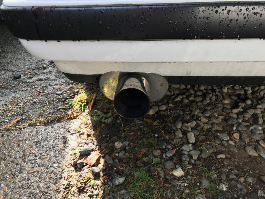

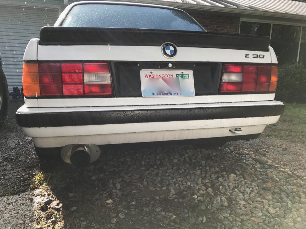

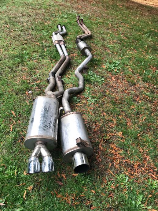

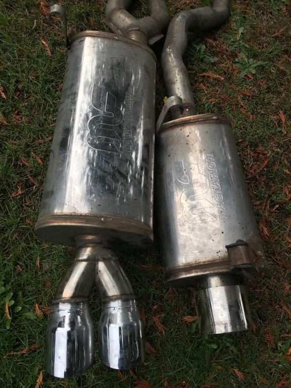

              Buttoned up the engine's anus. It now farts through ANOTHER Magnaflow system. The one on the right. Growing weary of collecting E30 parts. I may need to do a garage sale soon.

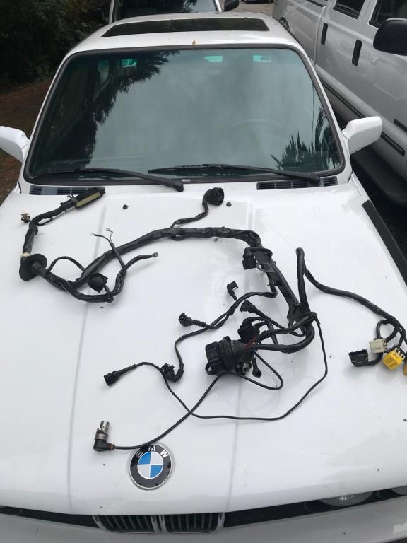

                At this point, all that's left is connecting the replacement wire harness. I have one that came with the replacement engine, and it isn't hacked up at the fuel injector leads like the one that came with the car. Then I'll fire up this boiler and see what it can do.

                    #144
                    I have an E 30.
                    And I thought my tail pipe was big!
                    Sent from my iPad using Tapatalk
                    • Nader393
                      • Dec 2015
                      • 408
                      #145
                      Yeah, it's a throwback to the big fart-can exhaust days of the mid-nineties. I was there. I had a '91 Sentra SE-R that was begging for one, but never got it. This is my chance to relive those days, PROPERLY.

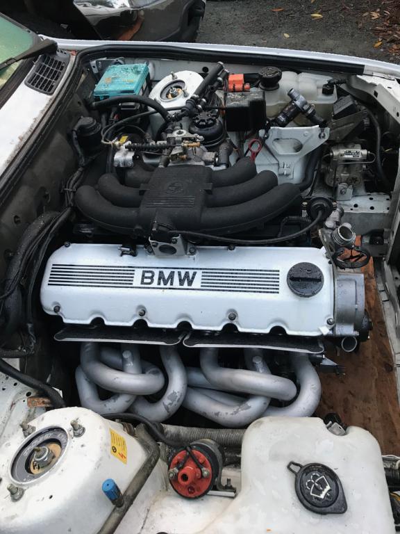

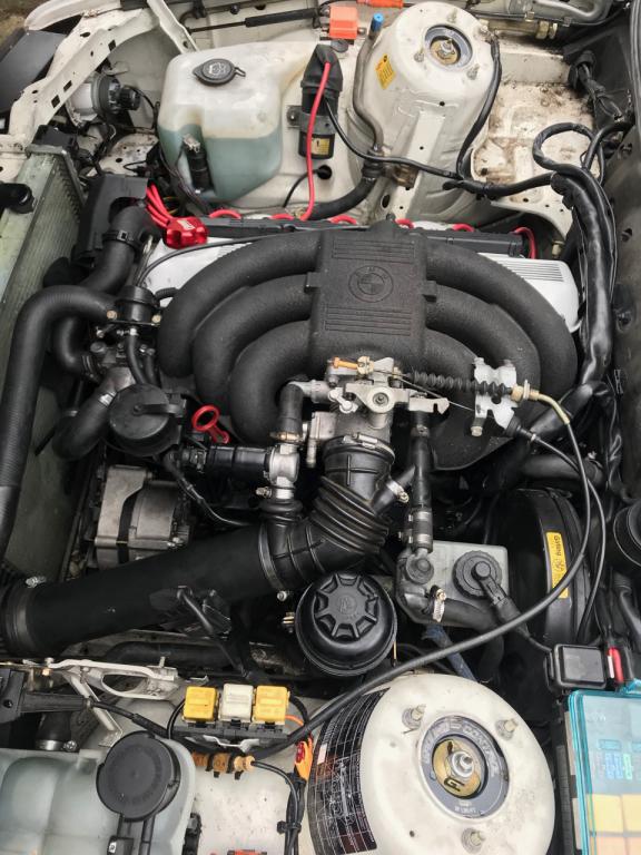

                          So, I connected everything from the harness, and with mild trepidation, I turned the key. It cranked and cranked without firing. Seems to stumble, but never fires. Dispiriting. So I spent the last couple days going over everything.
                          All relays, connectors, CPS, etc. are intact and good.
                          There is fuel; pump and injectors work.
                          There is spark at all plugs.
                          Buuut, compression is suspiciously weak; 110 across all cylinders. The last engine with stock 2.5 pistons was 180, and these are now SETA pistons. Should be higher than 110.
                          Without spark plugs, it cranks smoothly, no contact between valves and pistons. But I wonder if I somehow mis-installed the belt and it skipped a tooth, effing up the cam timing and compression. I hope that's all it is. I was careful lining up the pulley marks to TDC for the cam and crank during the belt install, but didn't hand-crank the engine over a few revs after installing the belt to confirm excellence. So now I'm going to go back in and check the timing marks. Really hoping they're off, that would be relatively easy to fix. If they're correct, then I don't know, might have to punt and tow it to a shop.
                          You know, I do have better things to do. But right now, getting this effing E30 and its replacement engine running, is all I can think about.
                          Achingly close... come on, baby, give it to me...

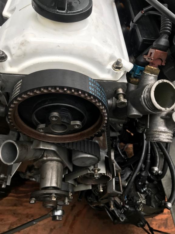

                            #148
                            Pulled a couple covers out of the way to get a look at the cam timing belt. It's painful to backtrack. Anyway, the marks lined up at TDC for both cam and crank, just as I had installed it. Nuts. That would have been a good explanation.
                            Thinking about it some more, it occurs to me that the low dynamic compression numbers (compared to baseline in the prior/stockish engine) may be a result of the more aggressive cam causing intake/exhaust valve lift overlap. Theoretically has benefit at higher RPMs when exhaust scavenging comes into play, but also causes a lopey idle and less response/power at lower RPMs.
                            So now I need to revisit fueling and spark. I have adequate fuel pressure at the rail shown my almost 1L filled after 30 seconds out the return line. Need to document that the injectors are actually spraying. I have spark, and have to assume it's happening at the right moment. Have already tried two CPSs and two DMEs (both with Miller PSIK chips).
                            With my luck, it's probably something stupid like swapping the TPS connector with the ICV connector...
                            ... hang on while I go check something
