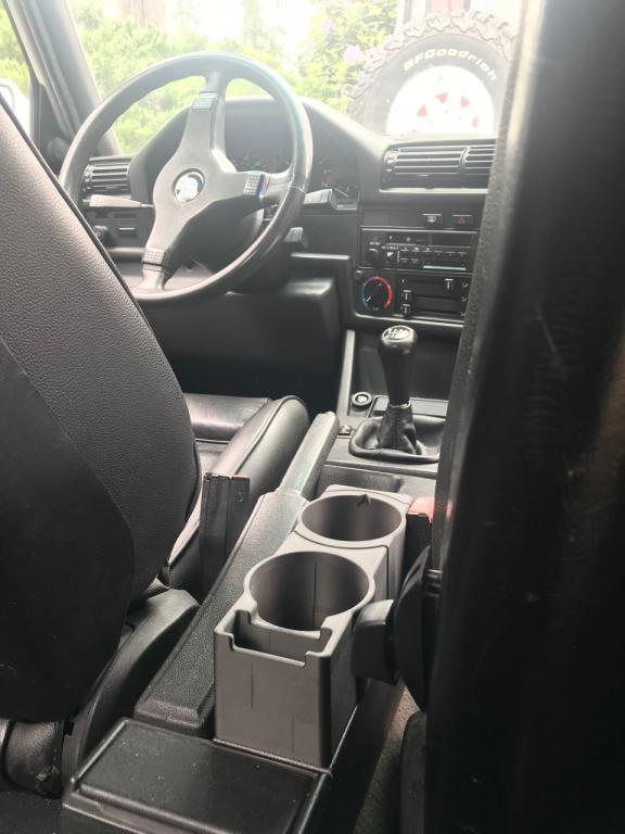

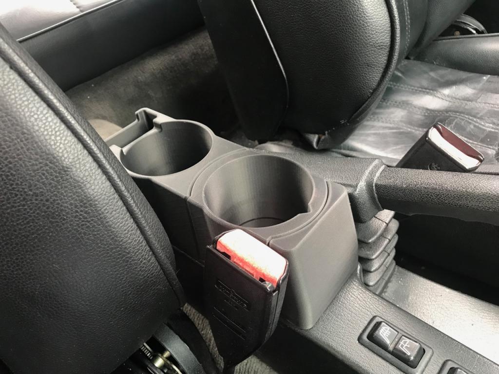

      While I let the Kreen soak before I burn it off and change the oil, I thought I would make a huge upgrade to the interior. With cupholders. I have mixed feelings about this, because none of my 5 street cars with manual transmissions have them, and I feel a little smug about that.
      Anyway, here it is, by Gearswitch.
      First, it came in a really cute box with a "Thank you Nader" printed on the inside. I'll feel bad about tossing this. Even has magnetic closure!
      The cupholder itself looks well-made, and the press-fit is great with the silicon bumpers that were included. The surface finish is a little rough with fine grooves from the 3-D printing process, which I suppose I could sand and buff. But I don't feel like it yet.

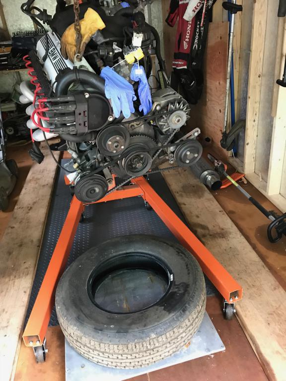

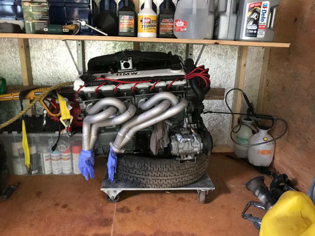

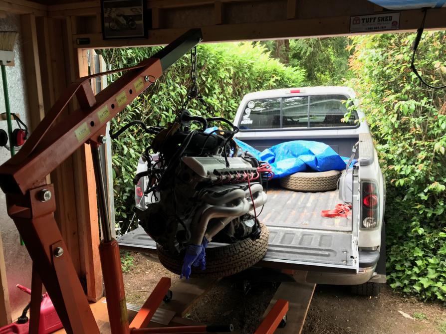

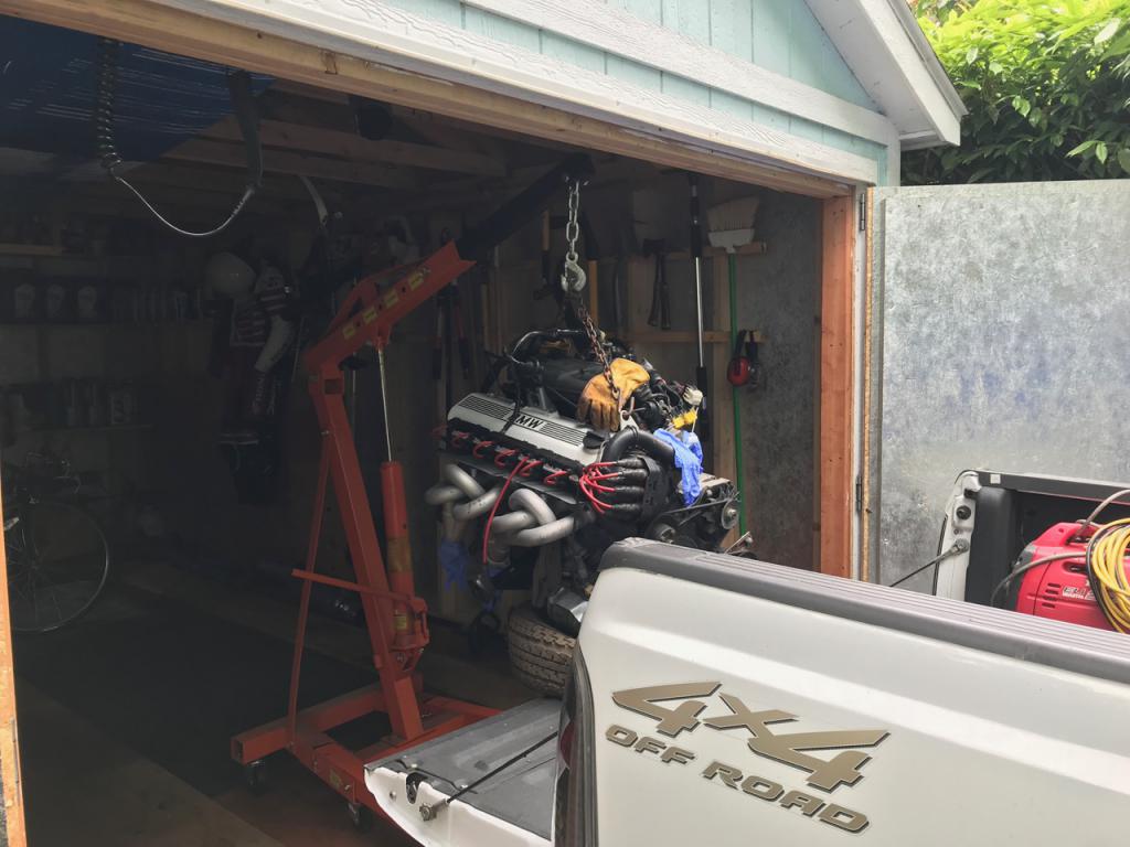

                  That spare engine has been camping out in the back of my F-350 and under a tarp for the last few weeks. High time I get it some shelter. Here it is going into my shed.
                  This is an important step, because it means either of two things:
                  1. I start working on the car again to transfer the head and headers (and that sexy valve cover) to the existing bored/stroked short block and make it the best e30 it can be.
                  2. I let it sit in the shed until I die, to become a "barn-find" to someone in (hopefully) 40-50 years.
                  Stay tuned...

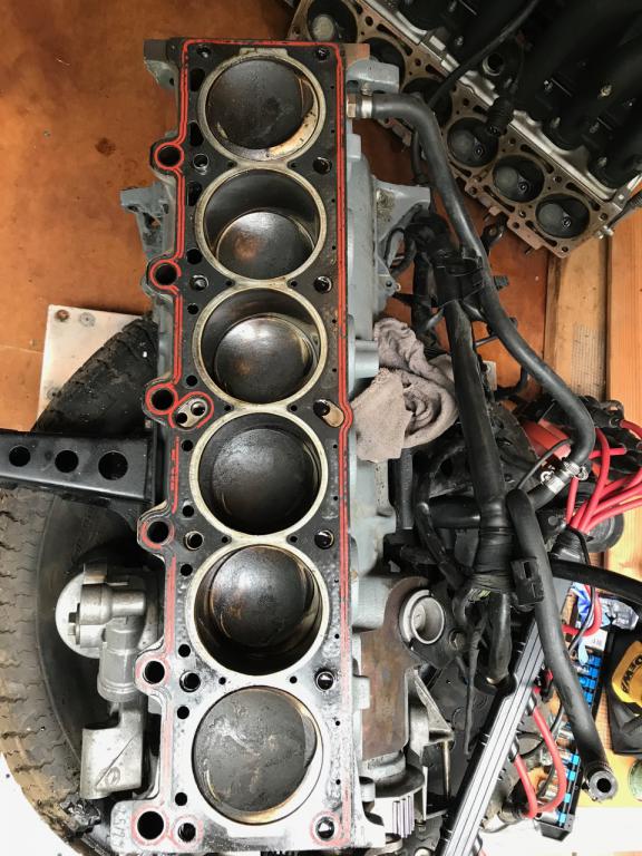

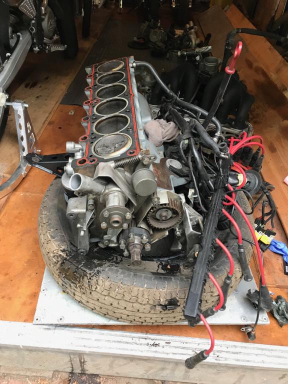

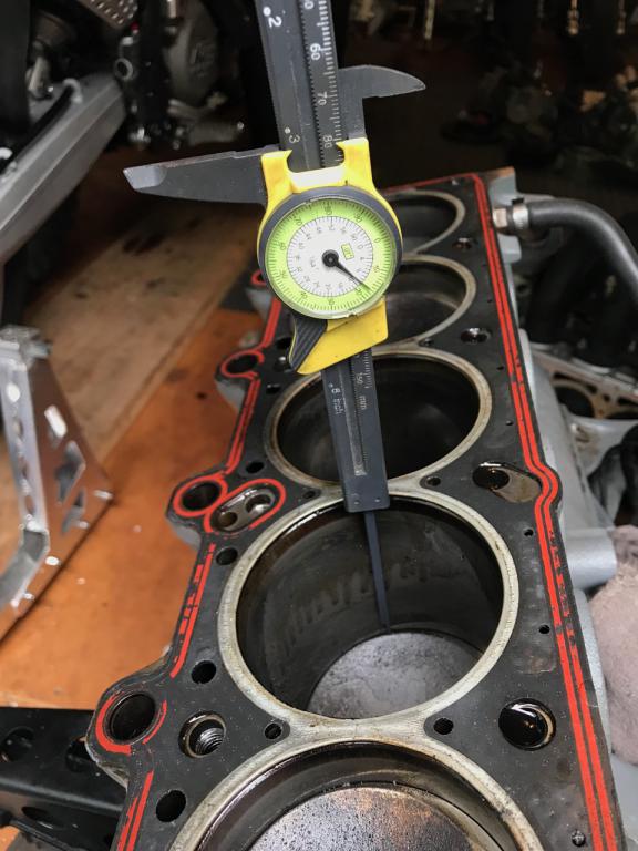

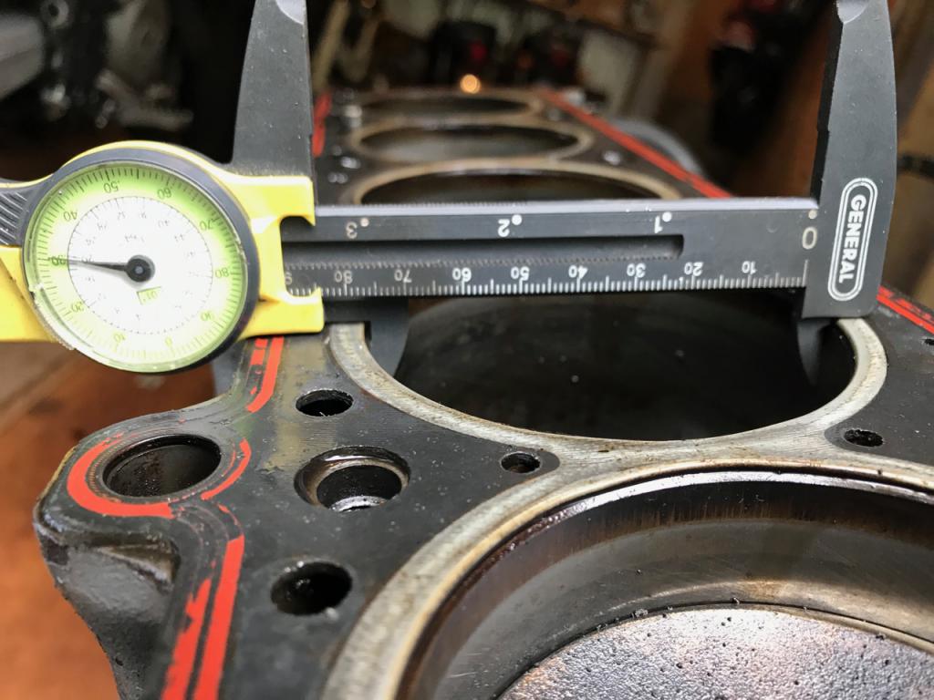

                    I'm back. Now that my motorcycle and car racing season is over, I can turn my attention back to the e30. Finally got to tear into the spare engine that's been hiding in the back corner of my back corner shed. Tore it down to the block.
                    Wanted to see what I really have before transplanting parts.
                    Pistons look like they are off a 2.5 engine. Bore (84mm) and stroke (81mm) indicate 2.7L. So that's good, and consistent so far with what I've been told about it.

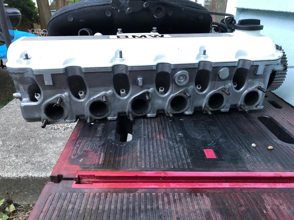

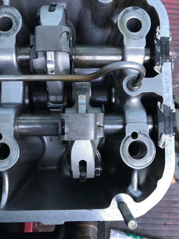

                      The head, however, is still a mystery. I was told it was a Bimmerhead rebuild, but it lacks the identifying stamping that usually goes above the #6 exhaust on one of their performance builds. Bummer. I contacted Bimmerheads (very responsive and helpful, BTW), and Matt said their budget rebuilds don't have the stamp. So maybe it's one of those.
                      On the other hand, this head does have H.D. rockers. So who knows what this really is? And will it make any difference if I transplant it into my car's existing engine? Next step is I need to identify the cam. I'll also get the intake manifold off and see if I can identify any fancy smoothing/porting.
                      If one of the prior owners of this engine stumbles into this thread, I'd appreciate any info.

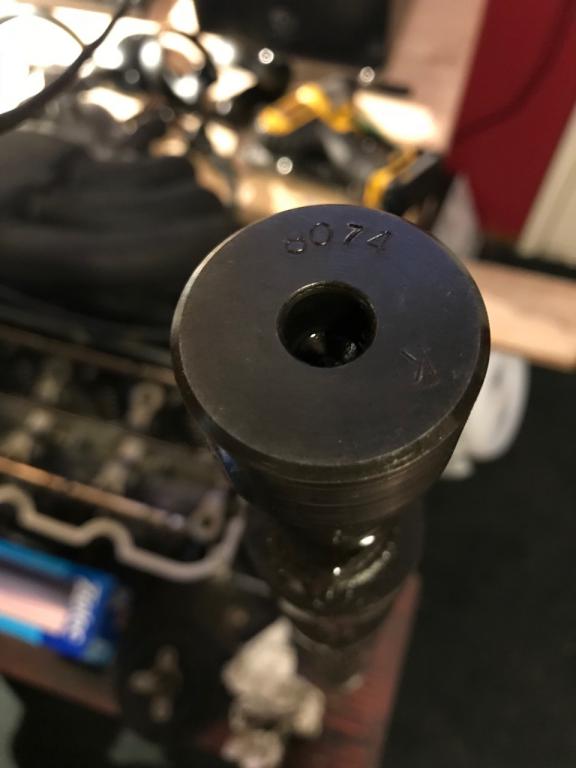

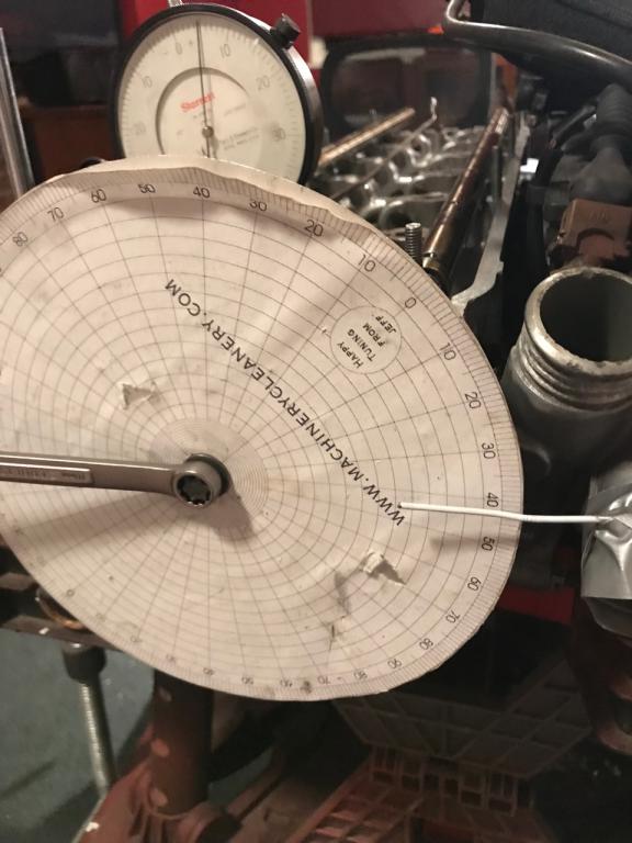

                        Finally got down to the camshaft. Set up shop in my den. This is what you do when the wife nags you to spend more time with the family; bring the projects indoors and in their faces. Who doesn't like the smell of used motor oil while watching T.V.?
                        Anyway, with my battered degree wheel and Boeing dial indicator (bought it from the Boeing factory when they sold surplus to the public about 10 years ago), I got some unexpected measurements.
                        Lift is only 6.5 mm (stock is 10.1 mm), but duration at 0.005" lift at the cam was Intake 140˚ and Exhaust 160˚, which at the crankshaft would be a whopping 280˚ and 320˚. Only marking on the cam is shown.
                        Does all this sound right? Small lift with long duration? Might need to post this in the general or engine section.

                          #102
                          Ahh, never mind. I was measuring cam duration starting at 0.005" lift, not 0.05". Stupid accurate Starrett gauge threw me off. I need to remeasure...

                            #103

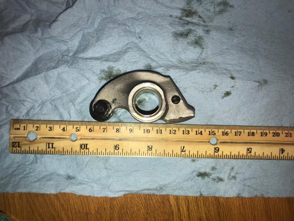

                            Rocker arm looks like a 1.5 ratio. So the 7 mm lift I measured at the cam translates to 10.5 mm at the valve. Which seems more reasonable, and basically stock. I've also almost solved my cam duration measuring error.
                            I'm clumsily fumbling through this process in public. If I were smarter, I'd keep from posting until I had it all sorted. Scratch that; if I were smarter, I wouldn't be tearing an engine apart in my den.

                              #104
                              stock lift is definitely not 10.5mm. Also, you have to account for the valve adjustment, which changes as the engine warms up.

                                #105
                                Really? Definitely? Why would you bother to respond, but not correct me by posting the actual stock lift?
