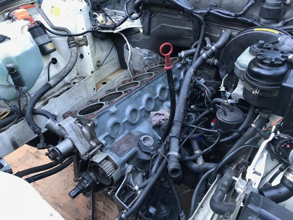

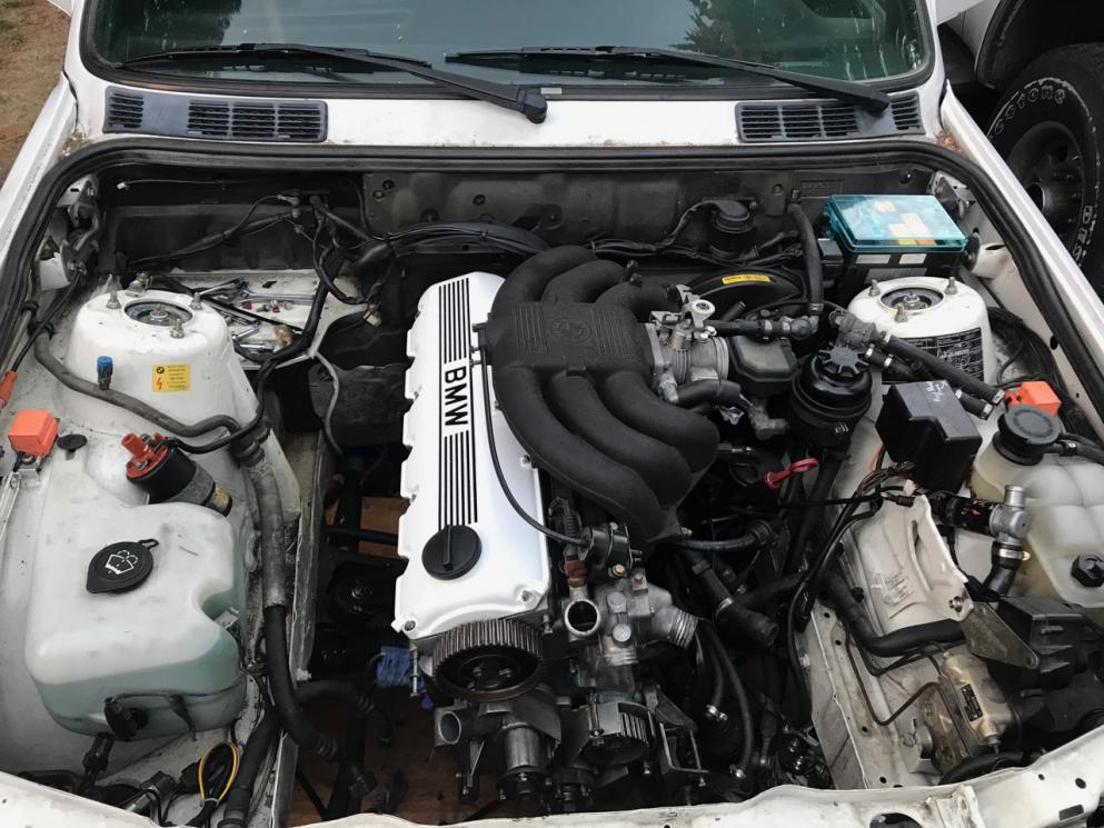

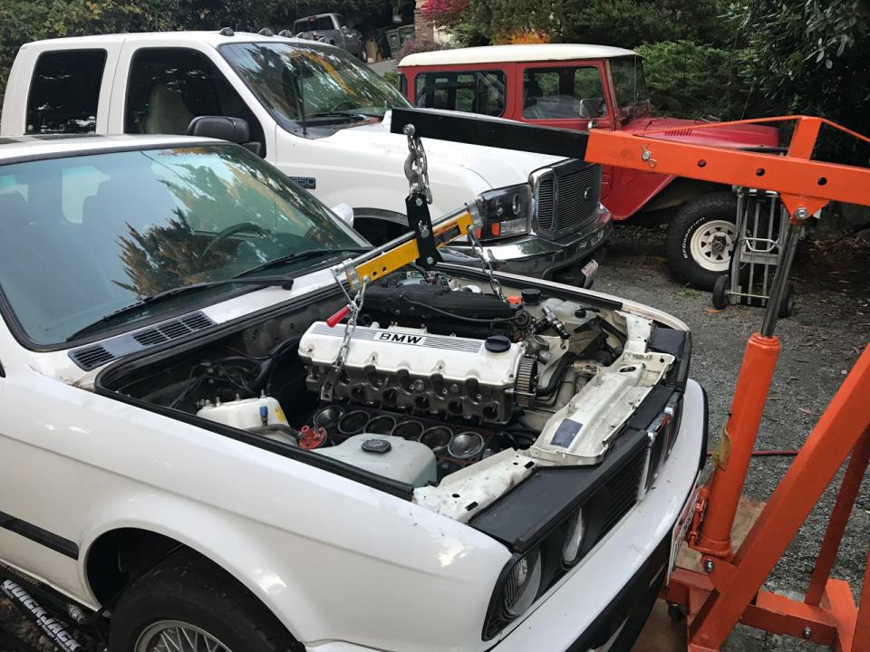

Job is incomplete until this happens: Obligatory man-in-engine-bay shot. Had to obscure my face because I am incredibly handsome for a middle aged guy, and I can't have the general public's girlfriends and wives stalking me... again.
For this picture, just imagine an incredibly handsome, swarthy middle aged guy, with a smirk of m20 extraction satisfaction.

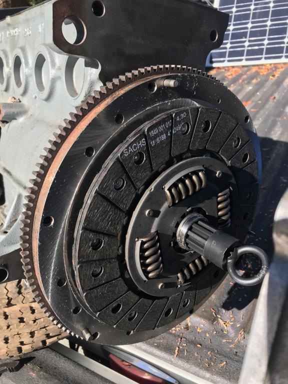

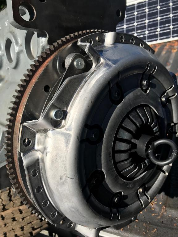

Plugging away: The prior transmission had a "Getrag rattle" (not the T.O. bearing), and I'm hoping this one doesn't. Flywheel was machined, and I put in a fresh clutch and pressure plate. Bolting it up to the backup 2.7 stroker, while using the fasteners from the prior engine, I discovered it was missing more fasteners (a recurring theme), including a pretty important 12mm engine to tranny bolt. Nice.

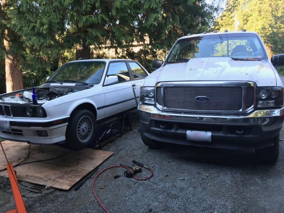

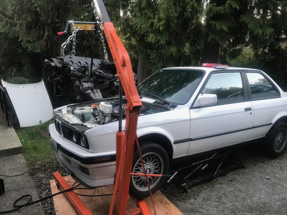

Though sometimes (understandably) mistaken for a force of nature, I am still a one-man operation. Despite that, I was able to, with much grunting and beer, wrestle the shortblock+transmission into place. Someone before me lovingly painted the block grey.

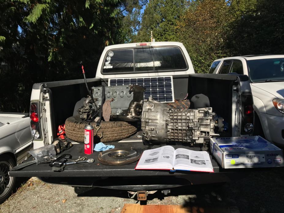

Big boy F-350 Powerstroke looks on in approval. He's partly responsible for this fiasco. I wouldn't have bothered with this arduous engine swap if that crazy truck wouldn't have dragged the extra engine home.

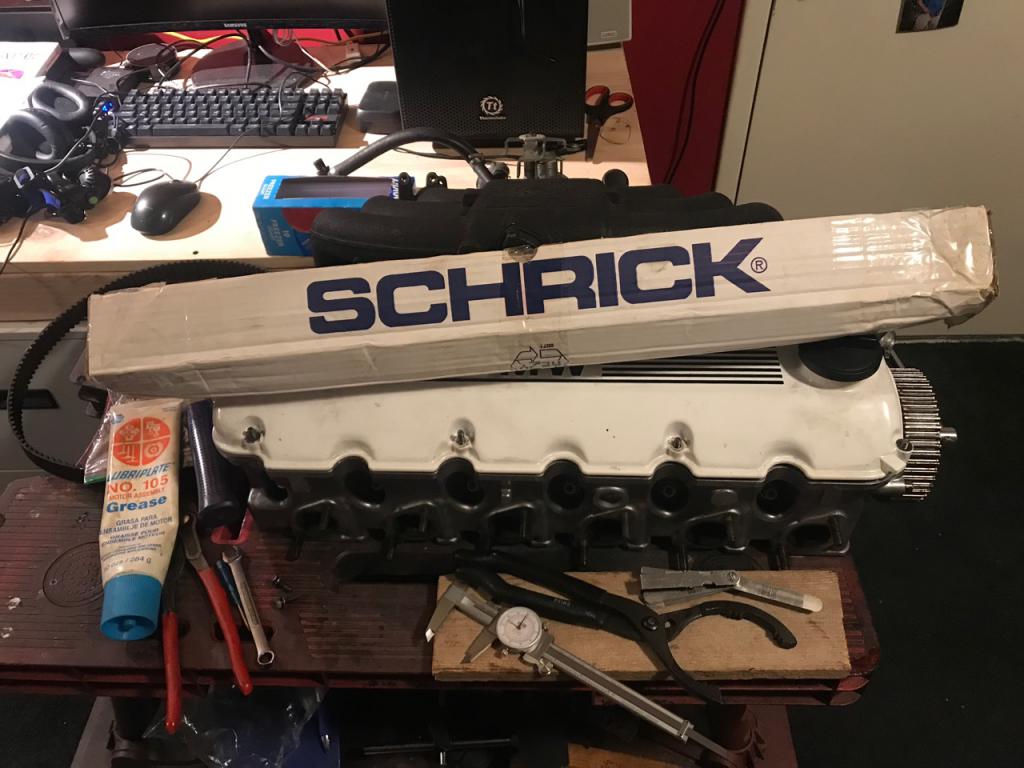

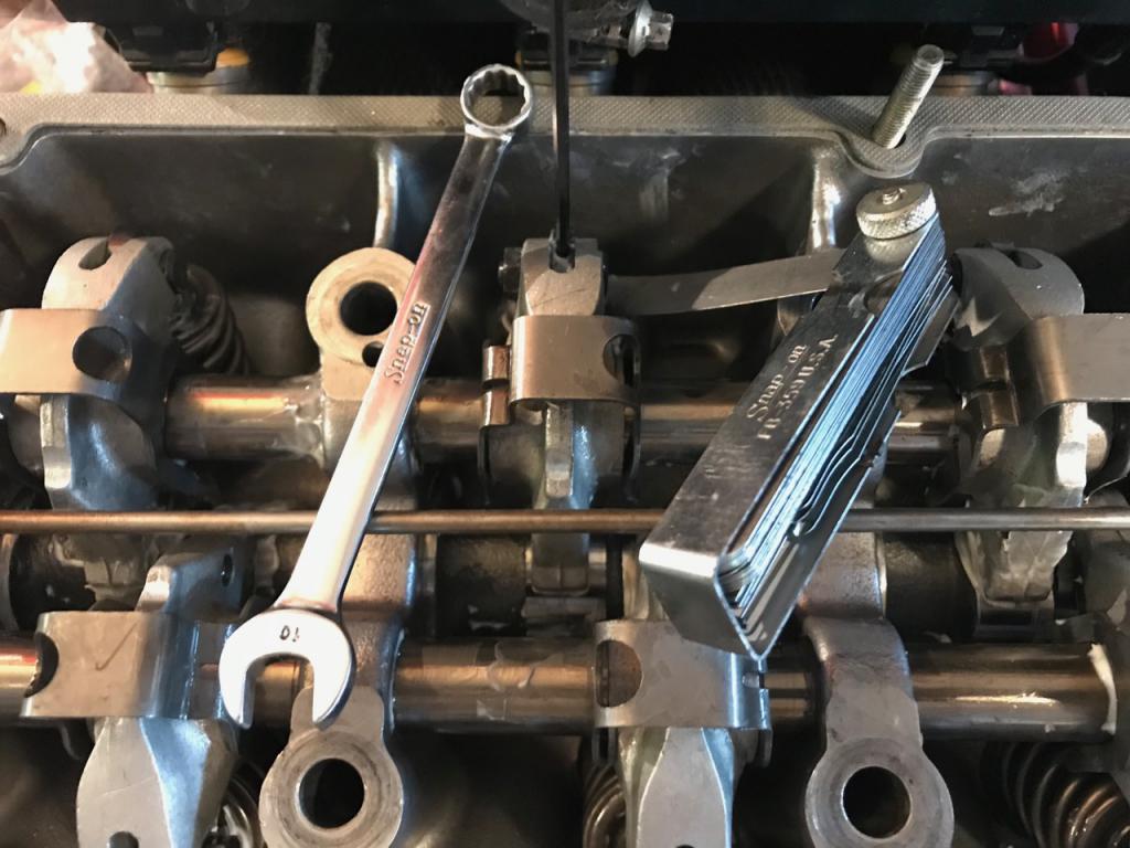

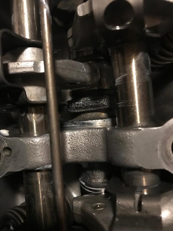

Schrick is in place, head is reassembled.

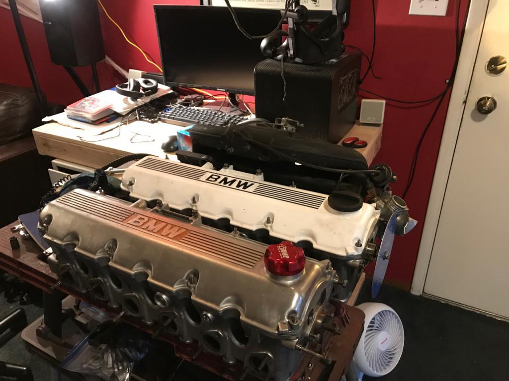

I don't recommend bringing dirty old major engine parts into your home, especially when you have small kids running around. But I will say, it's kind of nice, relaxing, even, to leisurely set valve clearances while sitting in an office chair, sipping on a nice latte...

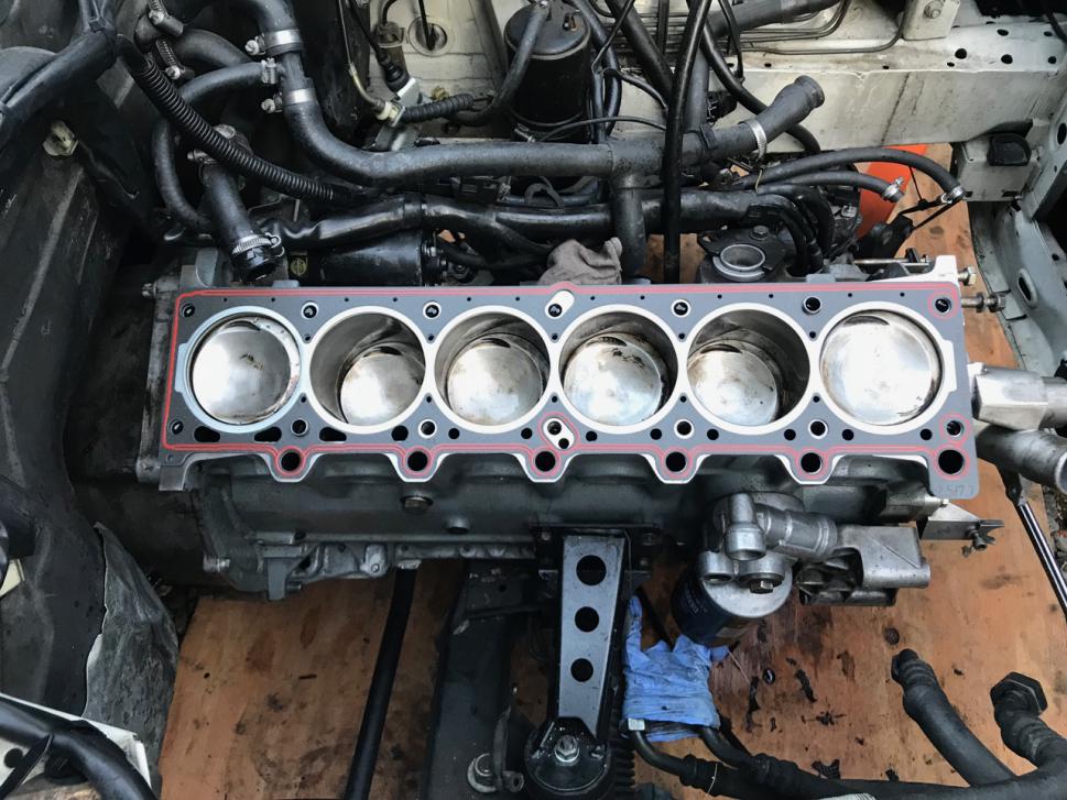

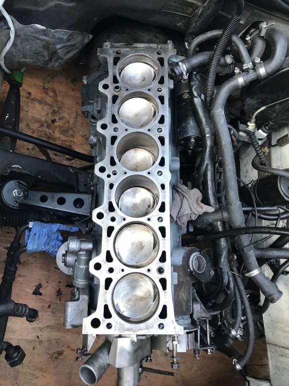

Prepped the block and head mating surfaces with razor blades, solvent and a wire cup on a hand drill to finish, super clean! Satisfying. Never use abrasives around the engine's moving parts. People recommending Scotchbrite and Rolocs for these occasions make me cringe. Wire brush or cup only.

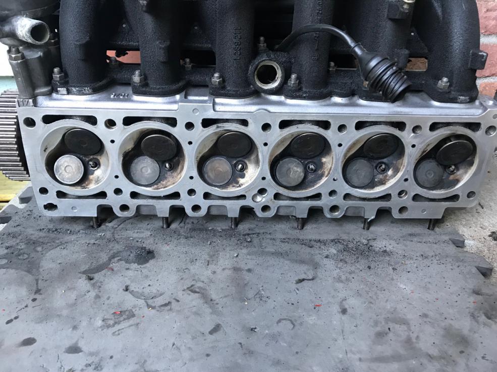

This^^ i am almost certain is the case. I paid $3k for the engine and i have check stubs to robert and max to prove it. Total out the door cost of the car + their labor + parts + rental space was ~$7k. The original deal was for that to include paint, which it later did not lol, so that was an extra $2500. He billed that and marketed that engine as having the MM 2.7 kit installed, thats what he would always say and the line he fed me during the entire build process at his shop.
So i, being the naive person that i was 4 years ago, went along with it and didn't have a strong reason to doubt him. Although highsight is always 20/20 and today there would have been a million red flags that i would have been privy to. Oh well, we live and we learn. But i carried the idea that it had the MM kit installed with me during my ownership of the car, not really digging into it that much to verify otherwise. I never had it dyno'd and didn't take the head off. As time went on and Robert and i's relationship soured, especially after they had all that really sketch, shady shit go down at their shop on 99, I did express increasing skepticism about the engine, and i relayed that to Hank when i sold it. So thats the story about the engine.
I remember expressing concern about this when we went to install the headers. The original guy who built the engine, Idanity, told me he polished and ported the ports here. In some spots that made it so the stock gasket covered over certain areas that had been widened. Robert said this was fine because, the way he explained it is the hot exhaust gases would widen the gasket over time to the correct diameter of the opening.. :drink: crazy i know and not sure why i believed him but we had some arbitrary time crunch to get the headers bolted on and block plunked back into the car. We were also working with their shop mechanic at the time.
