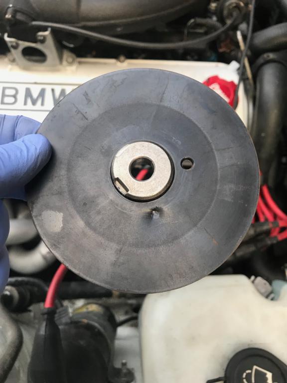

    Have you confirmed that your front balancer is orientated properly? If you have fuel and spark, it sounds like a classic case of ignition timing out of sync.
    I agree, it totally feels like a timing issue. But as you know, that balancer pulley is indexed, and putting it in wrong would result in a big wobble which this doesn't have. And again, the timing marks for both the cam pulley and the balancer line up perfectly for top dead center both before and after installing the balancer.

      How about the distributor gear and the rotor itself?

        Sure enough, I effed up the distributor rotor installation. I knew it was indexed with a peg-in-hole setup, and am pretty sure I installed it that way, but when I turned my back to get the Torx screw to fasten it into the cam, the plastic disc must have rotated before I cinched it down. Stupid. Here's the divot formed by the peg, tells you how many degrees it was off.

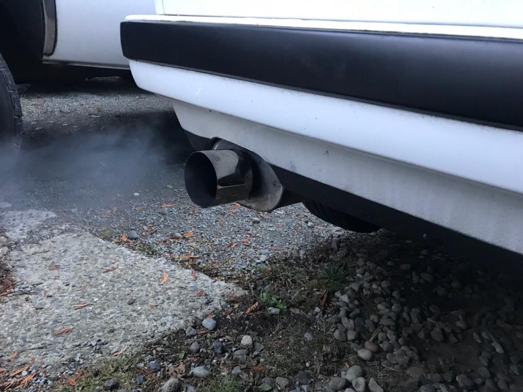

        So pleased to hear this thing run. This pic shows exhaust steam, not smoke, thankfully. I wish I could give a driving report, but I somehow lost the heater blower motor and power windows in all this. So the windshield fogged up with my excited heavy breathing, and it got dark before I could pull out of the driveway. Thanks, daylight savings! This will have to wait until the morning.

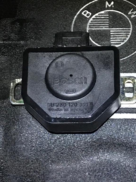

                  To fix the idle and bucking ride, I first replaced the ICV (idle control valve) with a spare I already had. Easy to do, low hanging fruit. That didn't do it. So next I replaced the TPS (throttle position switch). Had to order it, and it took a week to arrive. A full week of me driving this car in that condition, which kinda sucked.
                  When I finally got it, I felt like this $50 small plastic box would be the answer to my problems. The old one was full of oil, so I drilled a small hole in the new one to drain whatever oil vapor drips down the throttle shaft into the switch box. Sure enough, this new switch fixed the problem. Idles smoothly at 900 RPM. Well, smooth as a 284 cam in a relatively low compression engine can idle. Car is driveable again. I want to believe it's significantly more powerful, but like I said, it needs the dyno to show that. Stay tuned...

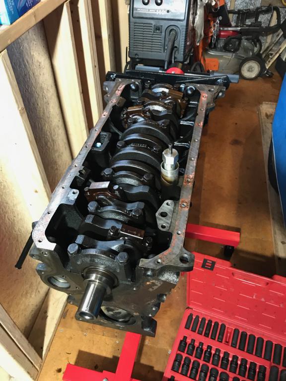

                    #159
                    The old lump is mostly stripped and on a stand. My plans will require a visit to the machine shop...

                      #160
                      oh dayum... Are you going to stroke the motor too? I plan to go balls deep 2.9 build. Same 85mm pistons and M52 84mm crank
                      Have you driven the car yet?

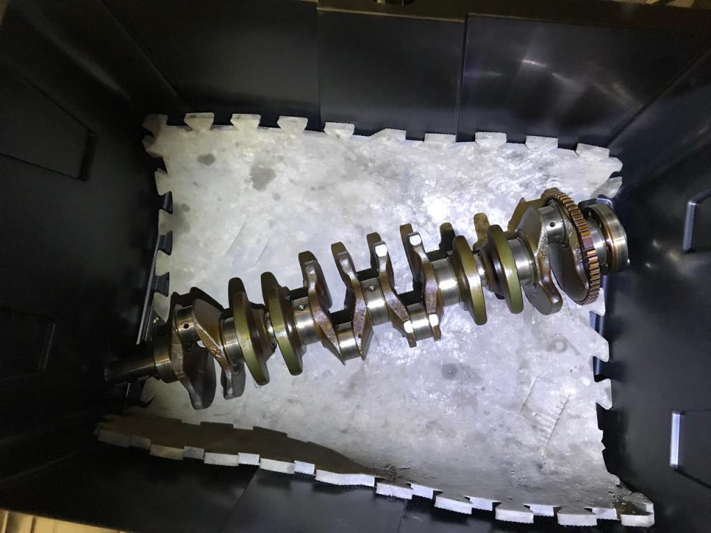

                        #161
                        Yes, and yes.
                        I do indeed have the M52 crank. (Thanks, Greg!)
                        Car feels great since I fixed it, but I won't spew superlatives until it proves itself on the dyno. Not that it matters, because 2.9 (and stuff) is coming...

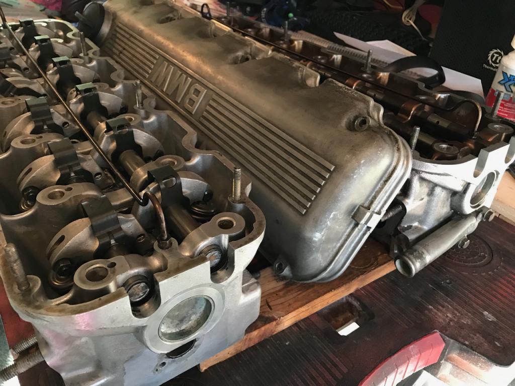

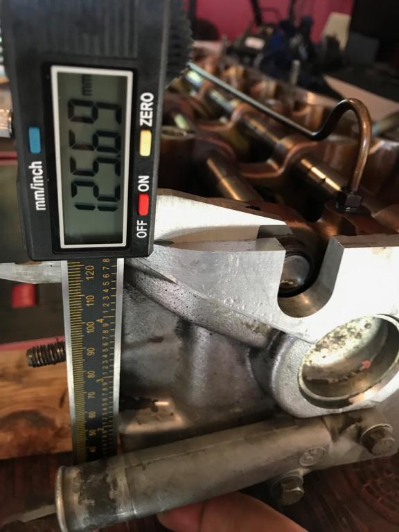

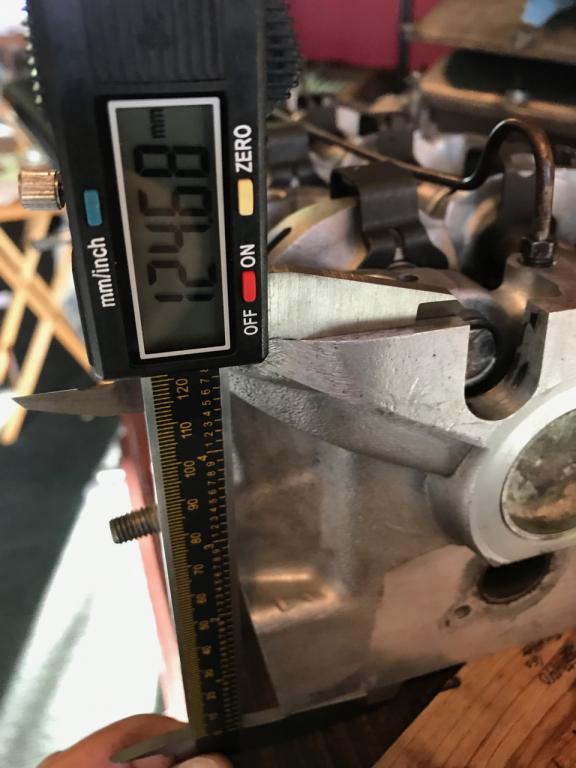

                            #163

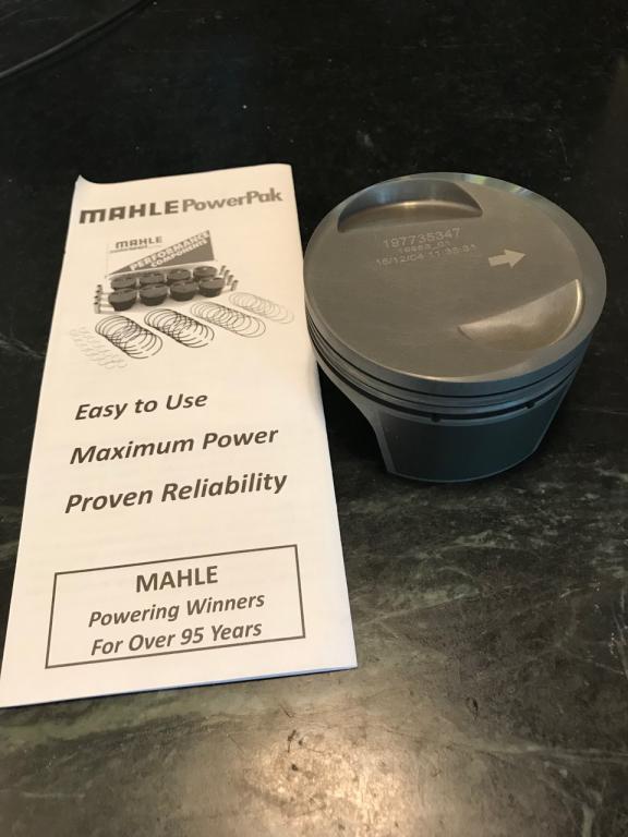

                            So, Greg was selling, and I was buying. I cleared him out of the aforementioned crank, the Mahle 85mm 10.5:1 pistons, M52 connecting rods, Bimmerheads shaved 284 head (verified with stamping), and box full of bearings, seals, gaskets-n-stuff.
                            I now find myself buried in e30 parts, not that it's a bad thing. In fact, I'm tripping over heads. So I brought a couple back inside (sorry, wifey!) for further work. Like I said, the verified Bimmerheads unit is shaved. How does that affect the compression ratio? Let's measure heads! Stock is first, shaved Bimmerheads is second.

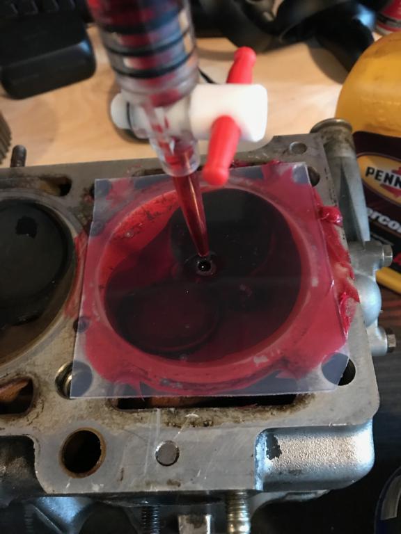

                                #165

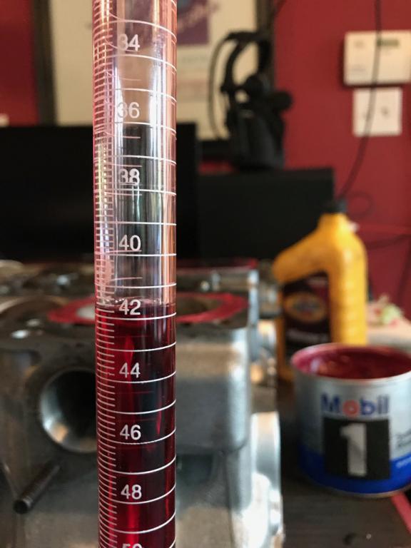

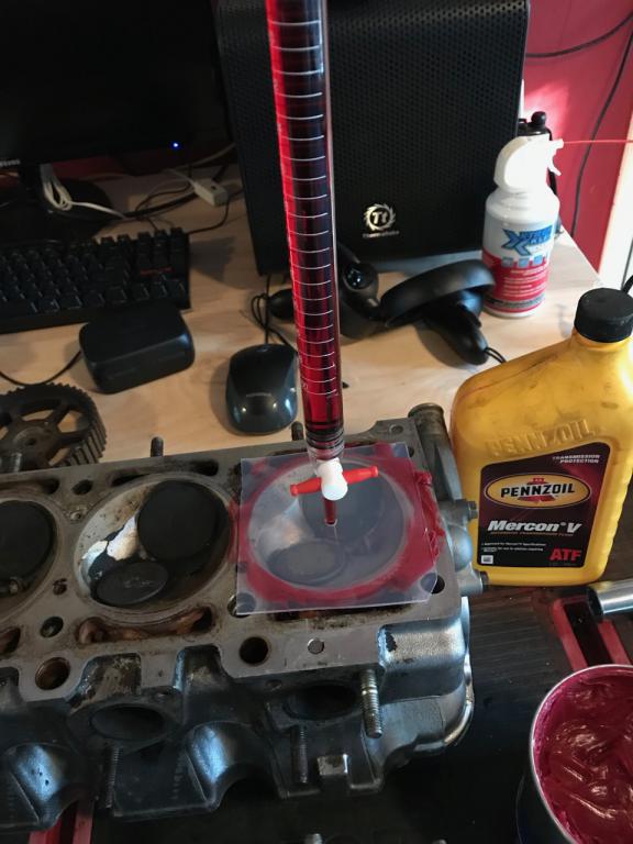

                                Now, let's cc the head. To do so, you need a buret. It's that miserable tool you used in college when you were a pre-med student struggling through Organic Chemistry. Used to have horrible memories associated with it. But I last used this piece of scientific glassware to cc the head of my Alfa's race engine about 5 years ago. So, gradually changing the buret's association to better memories.
                                I used ATF because it's easy to read, runny enough but won't seep through potentially leaky valves. Close off the chamber with a plastic plate sealed with grease.
                                Looks like a 1mm shave results in a 4.2cc reduction of combustion chamber volume in an e30 head. This information may be useful to a handful of engine builders in this country.
