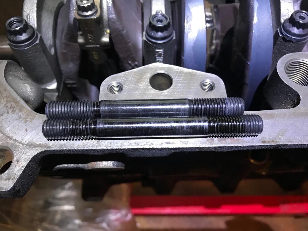

    Now, back to my bored/stroked (like a teenage boy?) engine project. Frustrated by the specced ARP main cap stud fitment, which is too short, I took a chance on another size and I found a winner.
    Specifically, the ARP part number 201-5000 (specced for the M50), which my machine shop directed me to buy, and others have also used in their M20 engine builds, does not fully engage their nuts if the studs are bottomed out in a block whose threads were chased and cleaned. Remember how I did that, and even ground down a tap so it would bottom out correctly? Strange how ARP lists part numbers for other BMW engines, but not the M20. So I took my machine shop's word, which seemed to correlate with others on this site, and I showed (in painful detail?) the results.
    Unsatisfied, I forked over another $130 for the next size up in studs; ARP #201-5002. These are specced for the S54 from the E46 M3. They are the same diameter and thread pitch, but about 6mm longer. Here's a comparison shot of length and fitment. Note, main cap studs in the background show the first one bottomed out, the others backed out of the block to engage most of the nut threads:

    And here are the new ones in-situ. Stud bottomed out in the block, fat-ass washers in use, and two threads protruding beyond the nut. As Archytas of Tarentum and Archimedes intended.

    As for my ongoing project, I spent a few days away from it, stewing over the shallow main bearing stud issue. Strange, because I ordered the specified kit from ARP, according to the machine shop that has built up many of these M20 engines. In my research, though, I can't find formal documentation of the M20-specced part number from ARP.
    It still bugs me that those ARP studs don't protrude from the nuts. This happens when I farm out work; questioning variances like that. The more I think, the more I worry. Then my concern escalates, and I imagine that maybe it's worse that it seems; maybe the studs aren't even bottomed out, and still installed short. Here's a picture of what worried me:
    [ATTACH]125059[/ATTACH]
    So I went back and loosened the main bearing stud nuts (in the correct order), and sure enough, the studs weren't even screwed down all the way. Picture shows the studs fully threaded into the block (that I painstakingly chased and cleaned of gunk in a previous post). One side has the washer, the other doesn't.
    So apparently the studs were backed out of the block enough to thread just the bare minimum nuts, ostensibly to reach acceptable torque. Unacceptable (to me). Must have at least two threads protruding from the nut, while the stud is bottomed out.
    [ATTACH]125060[/ATTACH]
    OTOH, since the main caps are steel, one could use the nuts without the thick washers (as pictured for the top stud/nut above), but even then there's barely full thread coverage. Call me crazy, but when you spend 1/8 of $1K for slightly more than a baker's dozen of some finger-length small caliber studs with washers and nuts, I feel like they should fit as a mechanical engineer intended, including the washers. In this case, backing out the stud to make it fit sacrifices precious block thread real estate, thereby losing out on ultimate stud grippage. I'm sure this setup is fine for 99.9% of users, and that I'm making a big deal for myself out of nothing, but I still find it frustrating, can't let it go, and I'm going to fix it...
