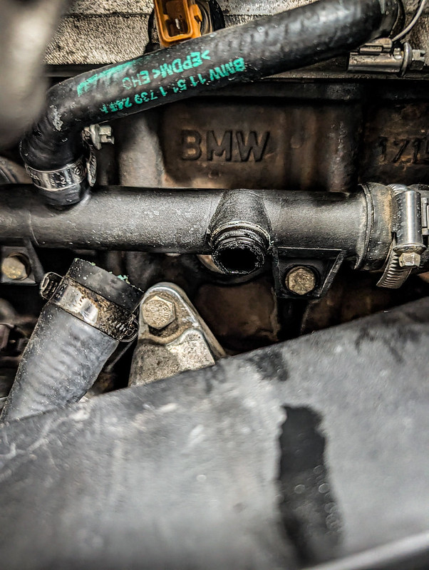

                          After taking my 1991 318is out for some "exercise" last Tuesday, I arrived home to the smell of coolant and a growing puddle of liquid under the car. Not good.
                          I quickly found the culprit, a plastic coolant crossover pipe buried under the intake manifold had cracked. Come to find out later during disassembly, it had actually cracked in three places, but was only leaking from the most recent crack as the hose clamps on the others were performing miracles. I was seriously on borrowed time and this would have left me stranded if it had let go anywhere other than my street.
                          After few hours of disassembly, I raided my E30 parts stash to find that I had everything I needed, including a new coolant crossover pipe, new o-ring, new intake manifold gasket, and new coolant hoses to replace the ~10 year old ones at the back of the head and block. Sometimes I order spares to push me over the $ amount for free shipping when ordering other things, sometimes I'm concerned these parts will stop being produced.
                          Wednesday morning I was up around 4:30AM reassembling everything. Despite having performed similar tasks on this engine numerous times, mistakes were made and it took longer than expected. One step forward, two steps back. I should have gotten more sleep.
                          By 10AM I had the system bled, engine bay rinsed and cleaned, and I was out on a quick 10-mile test drive. I'm thankful to report that the E30 is back in action and ready for an BMW Oktoberfest event this weekend, and an E30-specific event at Dominion Raceway the weekend after that! And I'm doubly thankful that the plastic coolant pipe failed when it did, and not on any of our recent E30 road trips, or the upcoming Oktoberfest events!
