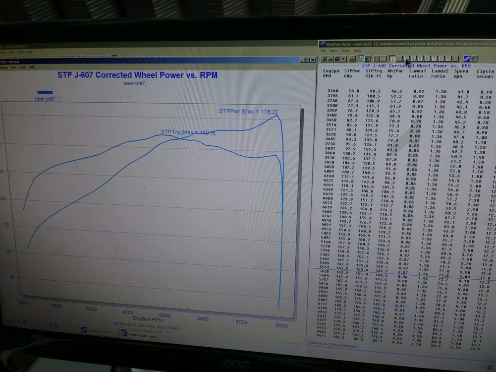

      Dyno Plot with Ignition Missing Issue
      So here is the last dyno pull.
      This is at a mile high near Denver... So the air is thin 20% or so.
      The stock ignition could not drive the high compression motor over 5200rpm or so where is starts missing as the revs grow.
      So the weird dips to the right of 5200rpm is caused by that.
      Also the car pulls hard to over 7krpm now, but the dyno quit at 6500 due to missing...
      New wasted spark ignition is installed and the problem is resolved just need to get back on the dyno for a final tune.

          You are right. Dyno is corrected for baro. So 211 bhp, seems kind of weak.. Let's see what the final tune shows.
          We did have crank sensor issues with the megasquirt early on leading to sync lost errors.
          A used and then a new crank sensor later, the sync lost errors are gone, based on logs from the dyno pulls.
          The wasted spark definitely fixed the missing issues. Pulls hard and smooth to 7krpm+ now on the road. I was confident it was spark since I could adjust the dwell and duration for the stock coil and move the RPM where the missing occured up and down. And also since we are seeing no more sync errors.
          So I need to get back on the dyno and finalize tune and accel enrichment. Should get rolling the last weekend of April...

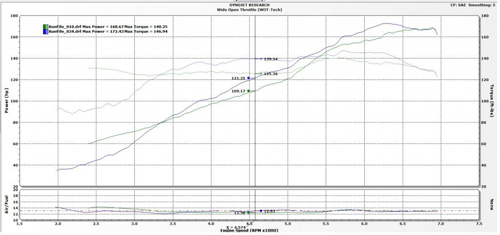

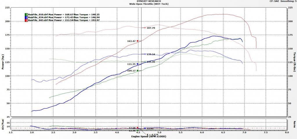

                          I have actually dyno'd Extrudabody and RHD on m20's with 272 cams, and the RHD made more power throughout the band. Extrudabody used 45mm throttles like the DBilas, but no air box, just open trumpets...
Name:	extrudabody vs rhd.jpg
                          Here was the same car with RHD after rebuilding the bottom end to a 2.8 (still using a 272 cam)...
Name:	extrudabody vs rhd vs rhd 2_8.jpg
                          As you can see power started falling off at 6500, the car is coming back this summer to install a 284 cam and swapping out the IE valves for SuperTech with the 6mm stems, plus a little more valve seat work with the new cutters I have been using.

                            Yes there are a number of advantages of the RHD setup as verified by the dyno and really is just fundamental design principles:
                            - The manifold aligns and mates with the cylinder head ports better I think this helps efficiency at high rpm when air speed gets high as it allows the engine to not nose dive at high rpm where the port goes turbulent.
                            - The diameter (of the runner overall not just the throttle blades) is correct for the power levels the m20 is capable of so this maximizes VE. Most use 40mm which is a 20% reduction in area.
                            - The length is suitable for the rpm levels the m20 works at so is in tune, again helping VE. RHD is approx 300mm from the head which is just about the longest that fits with the booster and airbox. The dbilas is around 200-225mm I think so atleast 3” too short
                            - The runners are straighter so you get less losses
                            Short plus large diameter runners kill the midrange, and even hurt hp if you go too far in the wrong direction.
                            If you have larger 45mm diameter runners you can make them longer by 2-3” over and above the RHD length to bring the power and torque back, however on the e30 there isn’t space to do that with a brake booster.

                            On e30tech there was an extrudeabdoy to RHD dyno posted that showed large gains ill see if i can find the image
                            On the south African forums there was a guy who did a dbilas setup and didn’t make any more power than stock and lost a bunch of torque
                            In my build thread there is a dyno graph showing RHD compared to a dbilas style setup was worth about 25bhp. I modified the dbilas using smaller throttles and made the runners a bit longer. The dbilas still made less torque almost everywhere and only eclipsed the stock one in a narrow band at the topend.
                              [ATTACH]127126[/ATTACH]
                              [ATTACH]127127[/ATTACH]
