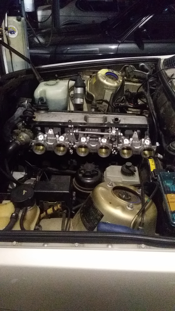

        Progress: New Motor is in...
        Hey People,
        I got the megasquirt running on the stock motor with wideband oxygen sensor and a base (not performance) tune. Let me tell you, a modern ecu running on MAP with wideband O2 absolutely transformed the stock e30... Not joking some experienced guys and myself think based on butt dyno measurements that 10-20 horsepower were added to the stock car. Not joking. Unfortunately I have no real dyno measurements of that setup...
        However here is evidence of progress with the new motor:
        Real Dyno plots and full specs coming soon!

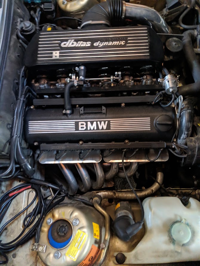

          Hi People,
          This thing is finally running. 2.9 liter m20 stroker, dbilas ITBs, e36 TPS, schrick 288, +1mm intake valves, head work, ireland engineering long tube header, custom dual 2.25" stainless exhaust, megasquirt MS2PNP running on MAP for now, 19.4lb injectors.
          Also put a 2.7 turn lock to lock steering rack from a 1.8liter Z3 to shorten up the steering (from 4 turns lock to lock).
          Right now we finally resolved how to get the MAP signal from the ITB setup in a happy fashion. More on that later.
          It is heading for the dyno next week. Right now, we seem to be fuel starved at 5krpm WOT. This is interesting, as S52B32 uses 21.5lb injectors and can produce 300whp without an injector change... Does this mean I am approaching ~270whp and then running out of injector? Hopefully!
          Well, don't worry, I will have a real dyno tune and measurements done. No guessing or arguing, just the facts.
          Stay tuned.

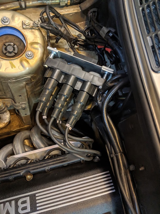

                      Hi People,
                      Sorry long delay. It turns out the stock ignition couldn't drive the high compression at high rpm.
                      So I went wasted spark like this:
                      I will post some photos, I was able to assemble it and mount it without drilling any holes in the car!
                      BTW the car makes 180hp at the wheels right now, pulls hard to 7krpm and beyond, I am at 5300 feet above sea level, so I think this is about 250 crank hp?
                      I still need a final tune now that the ignition is fixed, cross your fingers.

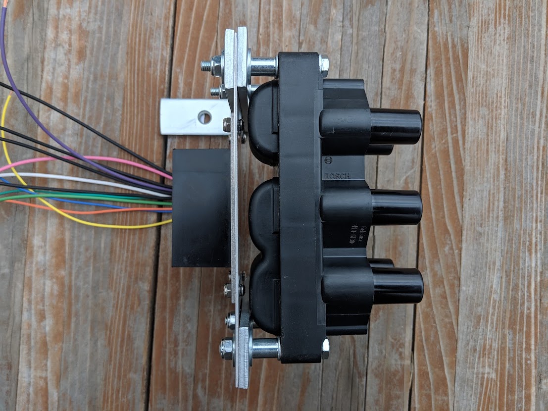

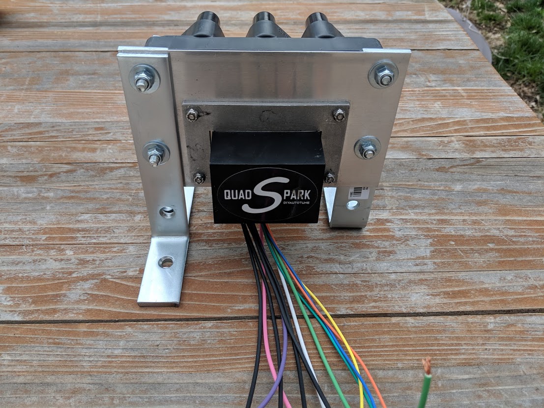

                        Here is how I built the wasted spark setup.
                        I used the stock wires and just reversed the loom.
                        One thing that is slightly unnerving is that the bracket is very close to the 12v battery terminal.... Probably like 1" metal to metal. There is of course the stock plastic battery bus cover....
                        The mounting is really solid. However in a real emergency situation, there is a slight chance the coil mount could be driven into the battery terminal...
                        I think I will mount some polycarbonate or similar plastic sheet between the battery terminals and the coil mounting bracket at some point.

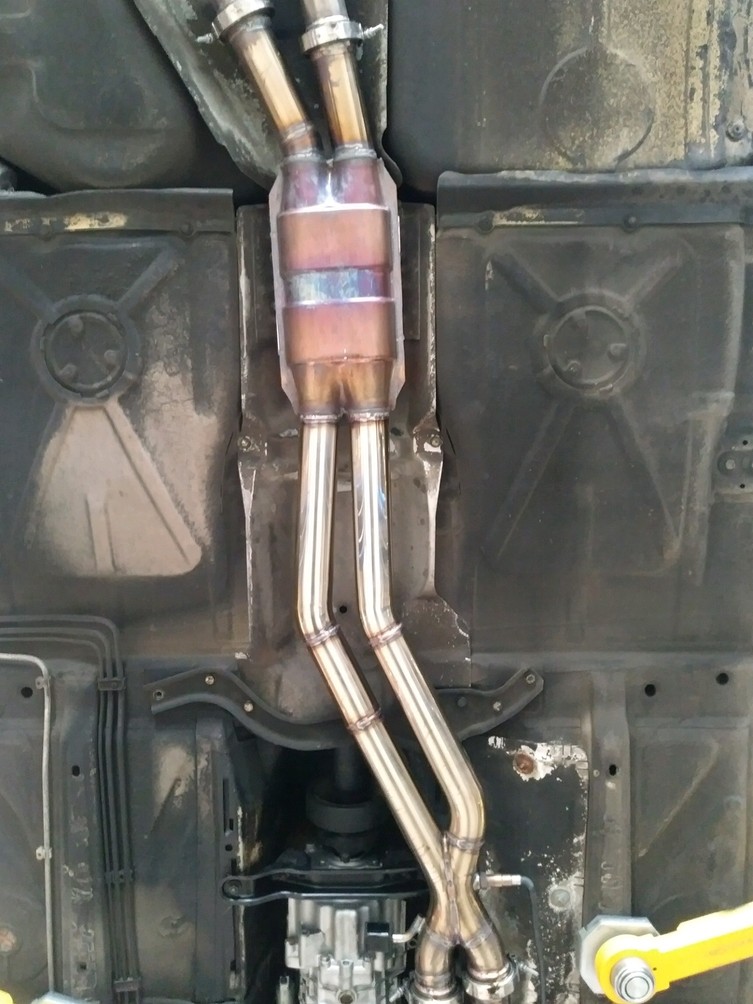

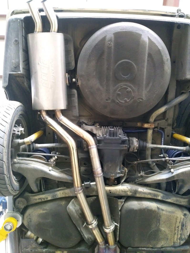

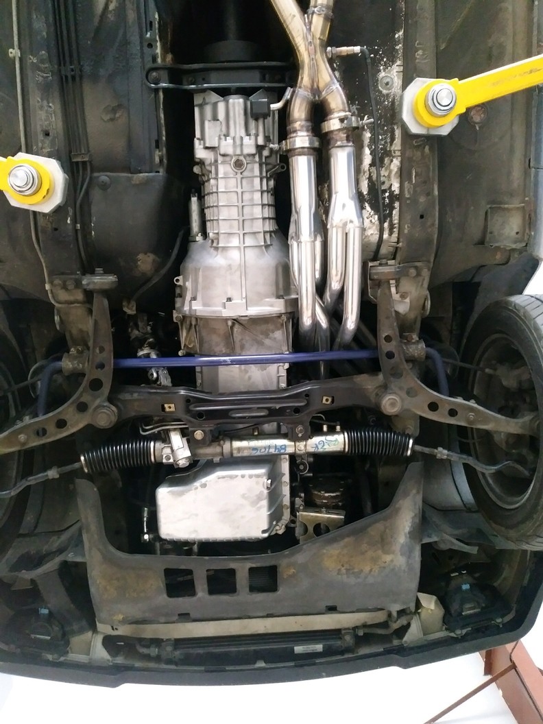

                          Here is the current exhaust:
