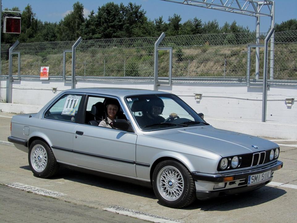

    Originally posted by Aufbau Principle
    The one you have is the 85 and below lip. It would let you run the 'Pfeba' lip. I had one before I found the Jimmy Hill. It's also a nice look:
    Hmmm... I don't see the fog light mounts on that valence like mine has. But I think you're right. I was trying to get the valence that my 323i had (but got mangled) so I suppose it makes sense it was the 84-85 valence since my 323i was an '85. My 325 is production date 03/86. You sure that the lips aren't compatible for all early valences?

      The valance in that picture is just the US one, the difference b/w them is that the Euro one has cutouts for fog lights and doesn't have the cutouts for some of the diving board one. I'm pretty sure the lips aren't going to interchange nicely without some hackery. I took off the pfeba lip and put the Jimmy Hill in front of the car when I got it, it's like a quarter inch or so longer on the sides because the later valence is more squared off compared to the early one that slopes inward. The early lip with the brake ducts also follows the slope of the valance whereas the later ones stick out out kind of like how the M3 has it.
      Compare the two versions here:
      Early early
      Late early
