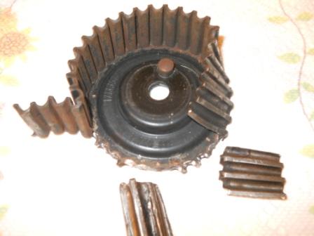

      It looks like you have the stamped timing sprocket, not the cast one. The stamped steel sprockets are a known failure item and it should have been replaced. My timing belt came off but didn't brake but the timing belt sprocket got destroyed, see attached photo. It's now in three pieces. This caused the 4 rocker arms to brake off.
      • betz
        • May 2016
        • 317
        #48
        Oh shit. Thanks for the heads up. Is the timing sprocket that attaches to the cam also prone to failure? I'm assuming the one that goes at the end of the crank is okay, it looks super beefy.
        I will def be buying a new IMS sprocket, at $35 its a no brainer.
                Get the cam gear and int gear sintered versions
