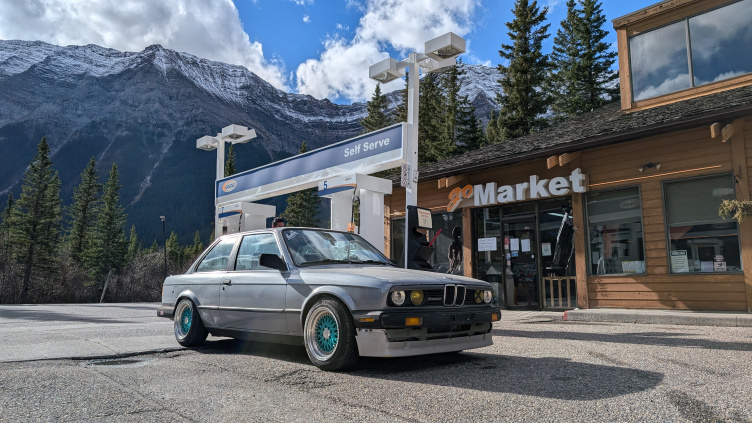

                Weirdly, I am back in action just 7 years later. I ended up getting the car back early this fall. It's was a daily driver for those 7 years and it really shows. That being said I'm excited to pick back up where I left off!
Name:	Starboy Kananaskis Centex.jpg
                Anyone have 325e exhaust recommendations?

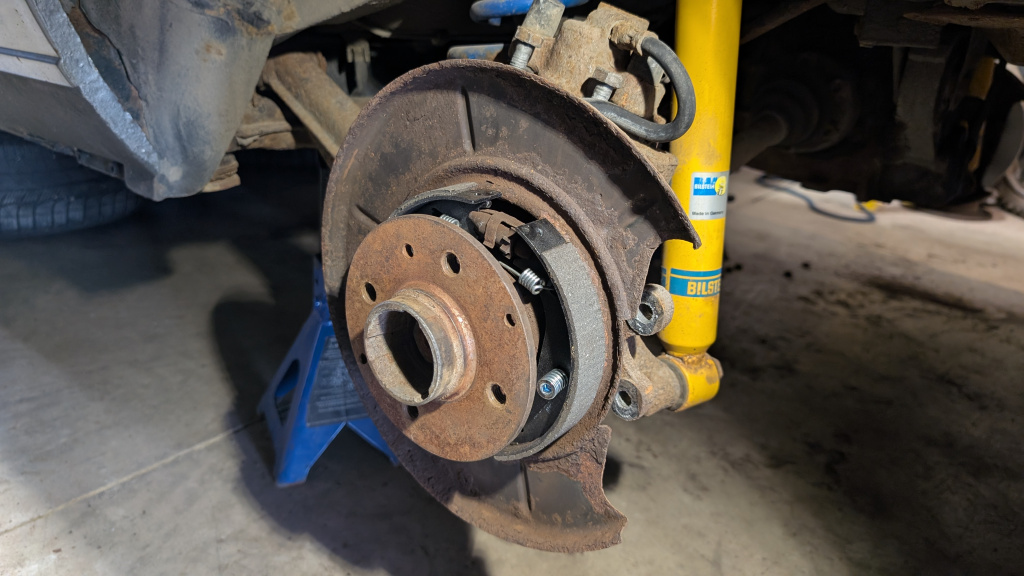

                          Starting with the brakes, I replaced all the pads, rotors, parking brake shoes, cables, hardware etc.

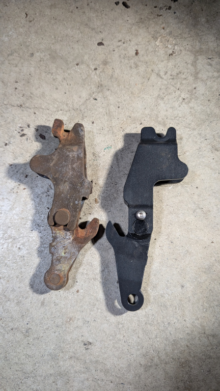

                          I even went as far as to install these fancy billet lever arms on the parking brake. having now driven the car, I can confirm they're fantastic at exactly nothing.

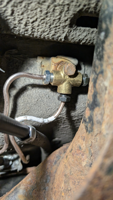

                          I also went and installed all stainless steel braided lines from turner / ECS. In the process of doing that, I found all of the hard lines were in terrifying shape, so I went and replaced them. The long one between the master cylinder and the rear brake tee fitting was a journey I hope to never repeat.

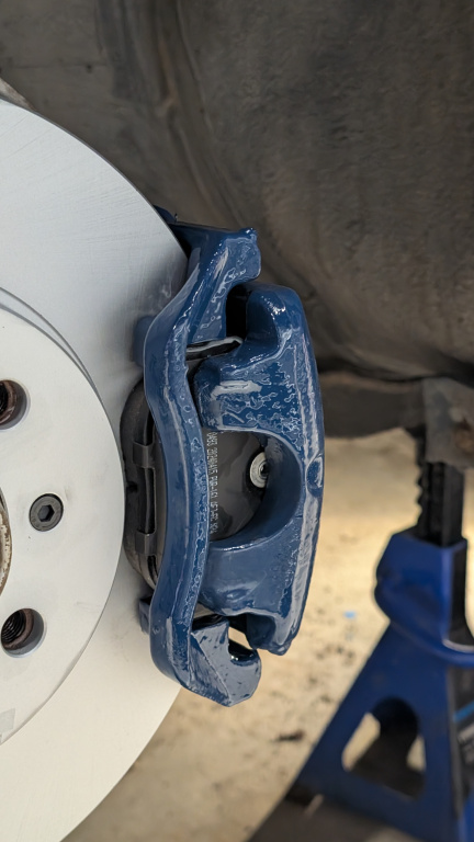

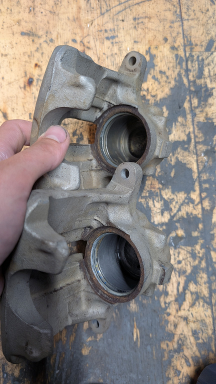

                          In addition to all that, I for some reason decided to swap to an E32 master cylinder because the internet said it was worth it. That was dumb on my part as the rest of my brakes are still stock. I did however nicely sandblast the calipers and recoat them prior to rebuildng them. (Turns out; this does not improve stopping performance.)
Name:	sandblasted calipers.jpg
Name:	Painted calipers.jpg

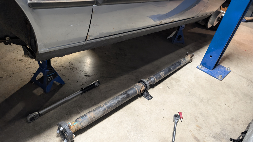

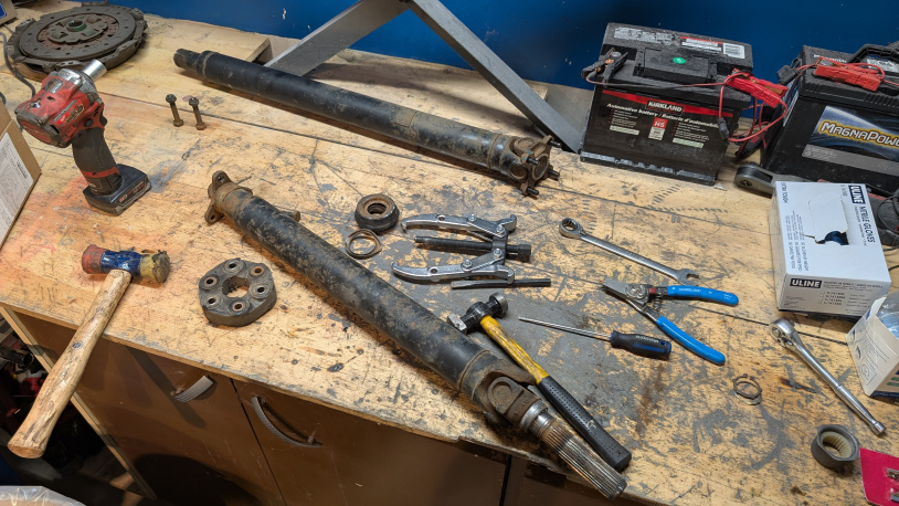

                            Moving on from that, I found the driveshaft center bearing had left the chat. So the only rational thing to do was to rebuild the entire driveshaft:

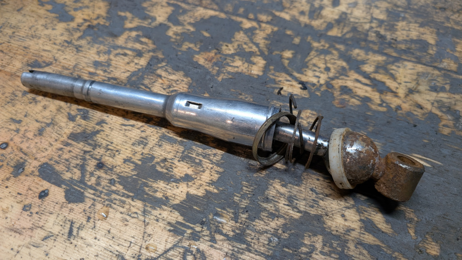

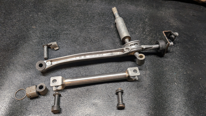

                            While I was all up in there, I found my shifter was cosplaying as the Edmund Fitzgerald:
Name:	OG shift rod.jpg
                            As that was simply not it, I was lucky enough to find a complete DSSR kit locallly. This also gave me the chance to update from the early model sheet metal plate style shifter to the cast aluminium bar style shifter:

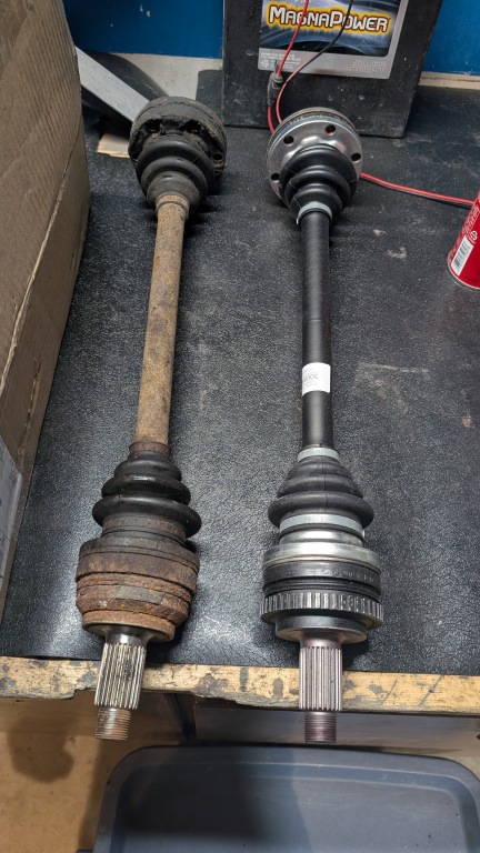

                              Two days after it finally emerged into the wild, the outer CV in the drivers side axle exited stage left, which called for a prompt axle replacement. I learned real quick that the ABS tone ring has to be bashed off on non ABS cars.
