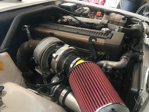

                #172
                Did a thing
                470HP & 354Tq
                VIDEO -

                  #173
                  Nice, that is a lot of power. Power to weight ratio has to be on par with a C6 Z06, assuming the car weighs close to 3,000lbs. How's the traction?
                  IG @turbovarg
                  '91 318is, M20 turbo
                  • e30mclow
                    • Jun 2010
                    • 198
                    #174
                    Me + Full Tank + Full Interior =
                    Spins 4th no problem.
                    I'll be upgrading wheels this winter to try and fit 245s.

                            Here is a photo dump of progress:
                            2.93 LSD Fitted
                            Burned off all available tires before the snow hit
                            Tucked it in beside the Pajero Evo for the winter
                            Finally found an immaculate carpet to replace the terrible one that's in it
                            Bought a terrible winter car while the Evo is being kept safe
                            Converted the front core support to a removable setup
                            Now the engine and trans can come out in about 40mins from start to finish
                            Replaced the decimated throw out bearing
                            Soundproofed/Heat shielded the tunnel and bay
                            Deleted any unnecessary wiring now that the ABS & Airbag are gone
                            Did the timing belt, water pump, tensioner and a few other things to the 1JZ
                            Chopped out any unnecessary bracketry in the bay
                            Started looking at clocking my BC top plates to gain more caster without changing the wheel position
                            I'm going to re-drill the stud locations to rotate the plate 30degrees, which will increase caster about 20mm and keep the strut towers untouched.
                            Made a rather large purchase - BBS RSs
                            16x8 et11 Front
                            16x8.5 et5 Rear
                            Perfect for my suspension setup!

                                More photo dumpage
                                Launch control mawfakers....
                                Micro momentary switch
                                All wired up with a quick disconnect in case I need to pull the trans
                                I made a neoprene sleeve to keep the wiring semi-clean at least
                                I could have easily worked it off of the clutch switch, but this is just so much more of a cool gimmick.
                                My new carpet is in, which meant sacrilegiously cutting it up to fit the modified tunnel.
                                Redid all of the crusty in-bay loom
                                Sharpie'd by cluster and polished the screen to a near new finish
                                The interior is now ready for some serious ripping this summer
                                Fitted the ultra-rare SedanKing Heckblende
                                I'm finishing up a neat license plate holder, as this one was just for mockup.
                                Next up is a deep clean, then she's back on the road this weekend!
