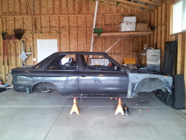

        Originally posted by DEV0 E30
        I didn't know you had another M3, (please tell me that is yours) all is right in the world if so. ( I remember what happened to your last one. :/ )
        Well...
        Here is how it sat yesterday

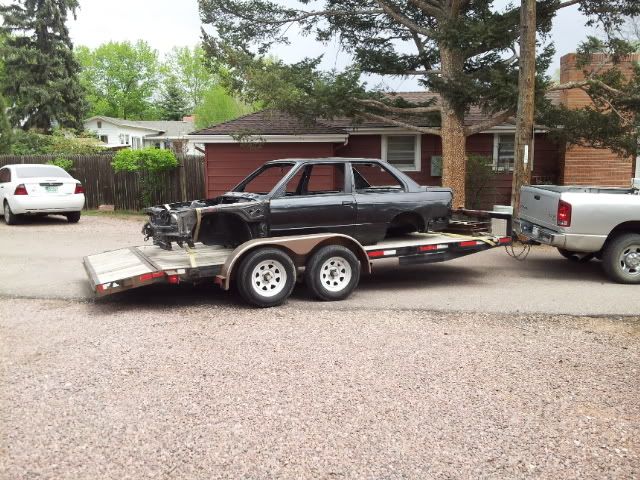

        Today The M3 shell was loaded up and is on it's way to Tennessee.
        My wife was actually pretty bummed when I bought the shell, because she had planned on buying me one for some kind of big event, like 10th wedding anniversary, finally finishing college after 20 years or something like that. My plan was to make the shell look like this after doing a proper roll cage (I was planning on a DTM replica cage) then transferring all the cool bits on the white car into the new shell
        She has already mentioned this evening that now she can carry through with her original plan.:bow:

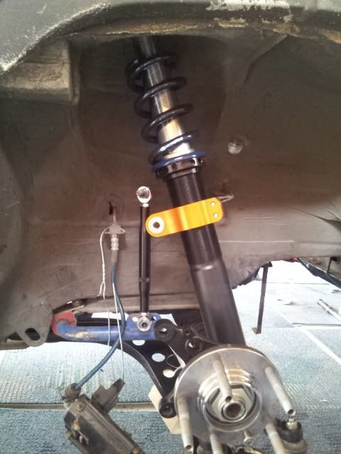

        I must have been drunk when I measured these for correct fitment.
        Still rubbing the strut with 35mm of spacers stacked.
        The good news is that they don't bother any sheet metal at the moment... but that could be as wrong as my measuring tape skills. I also swapped the anckerman arms around on the bottom and reset the front toe to an eyeball adjustment.
        Newest little problem are these very nicely made sway bar endlinks from bimmerworld are too long. These are the shortest ones bimmerworld sells (9-10.5) so I'm going to shoot them an email and see if they would one off a set of shorter ones. I can adjust the orange tab up a bit, bot not enough to make the sway bar happy and also to not rub the wheels.

            I'll trade you for my shorter ones

              details?

                  The center link is 5.5". Total center to center compress is 7.13"

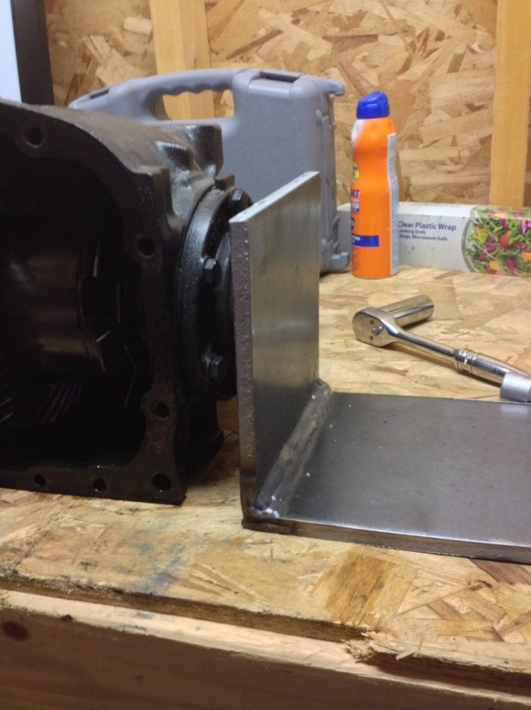

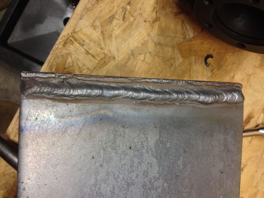

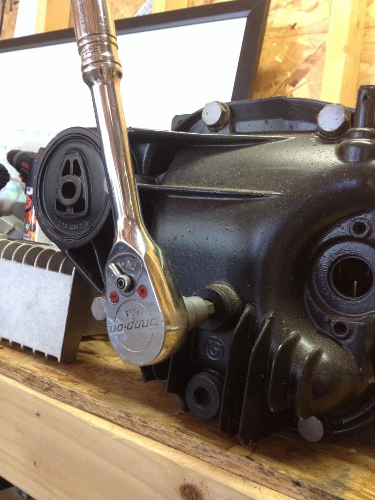

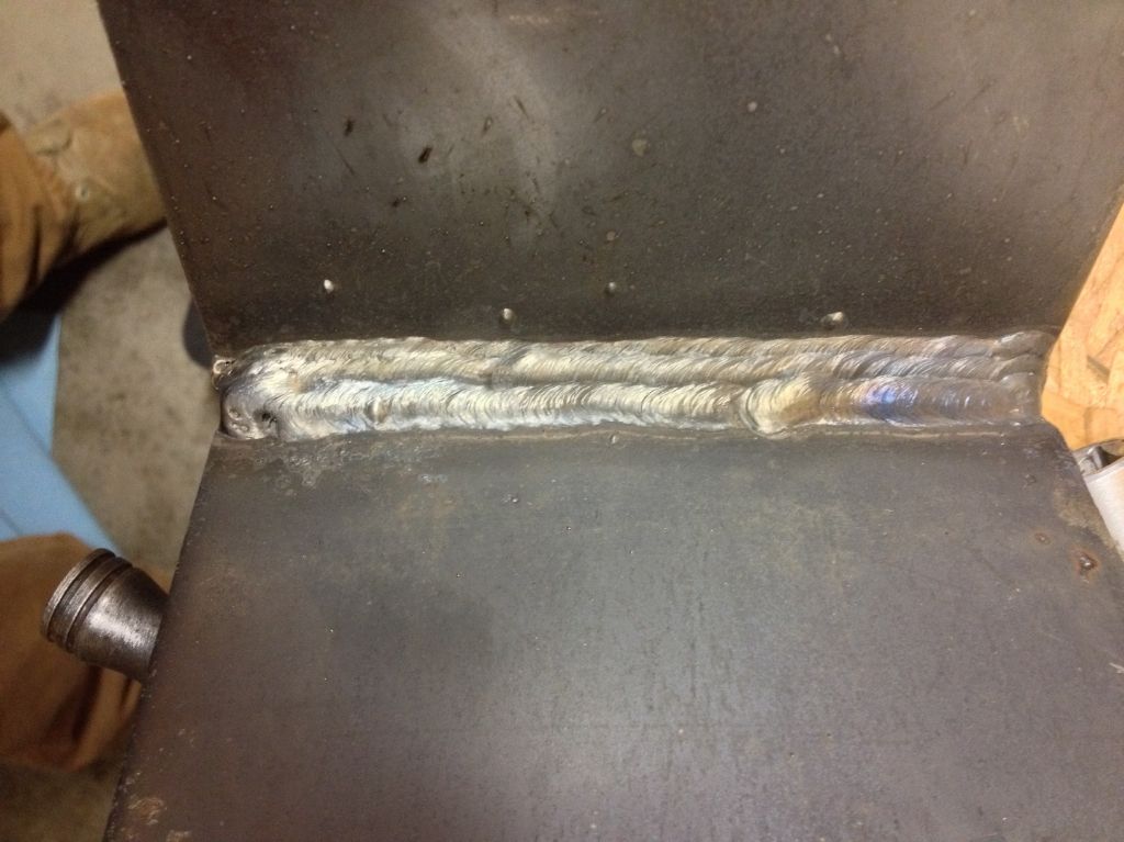

                    As for the workings of the diff, I couldn't turn the two axles by hand, so that's a plus! I wanted to make sure it's in good shape before installing everything, so I welded up a quick tool to hold one axle in place, and applied torque to the other.
                    I've been taking night classes in welding, and been having a lot of fun learning a new skill!
                    Basic idea. Simple yes, but after doing some searching, I saw some rather creative ways to lock the axle in place! After drilling 2 holes, I bolted the plate on.
                    Old RS3's on 16x8 style5's work well as anvils.
                    In the picture above, you'll notice that I just screwed a bolt into one of the axle hub's holes. This means that the torque applied is either multiplied or divided by a certain percentage depending on the length from the center of the axle to the bolt, and the angle of the torque wrench from center. I didn't feel like doing the math, so this afternoon I drilled a couple of holes in some scrap metal and put a bolt in the middle. The torque wrench broke away at 41ft/lbs, but turned the clutch packs at 42ft/lbs. I found a good bit of info on the spece30 site for what the value should be, and kept seeing 40-65fl/lbs. So my new diff is right at the bottom of acceptable.
