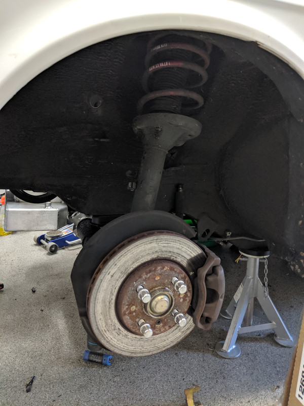

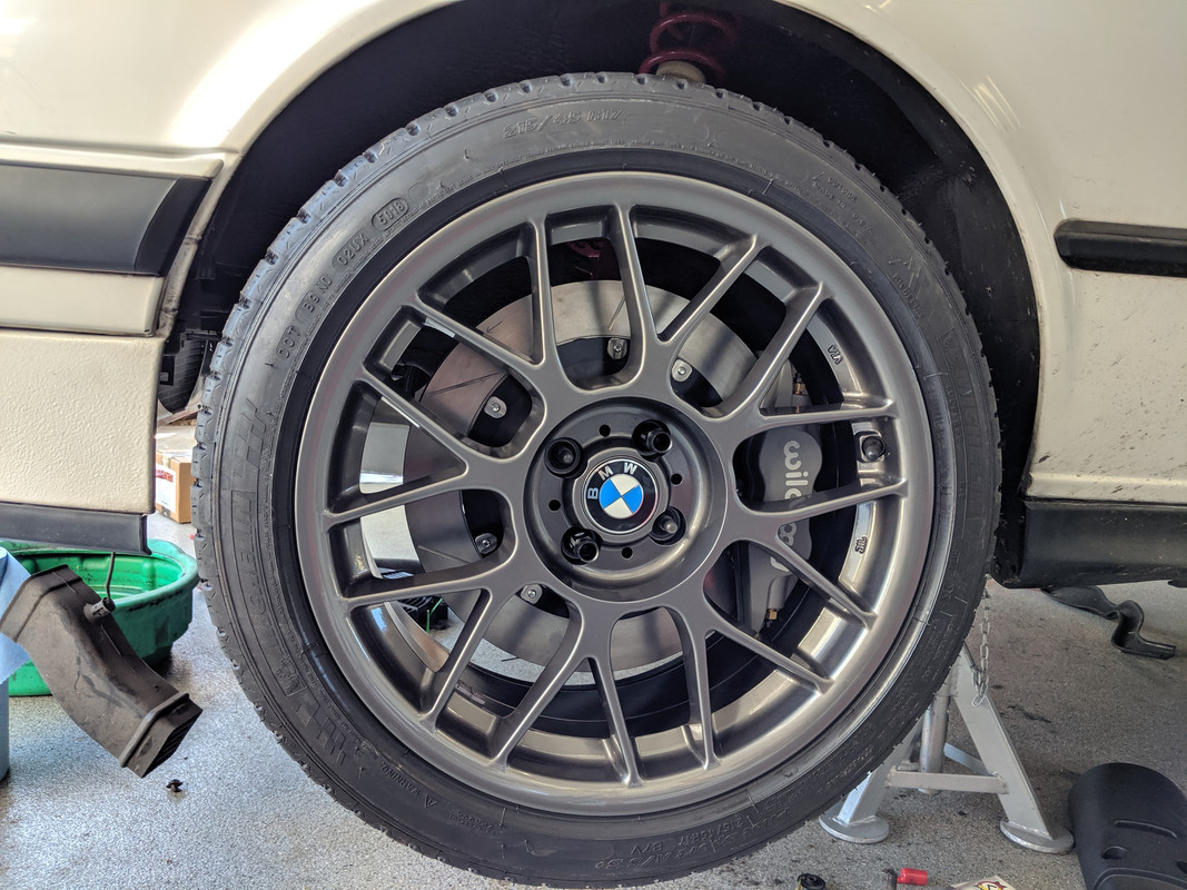

      I've been traveling a lot for work, so progress is slow right now. Last time I worked on the car I got distracted and jumped on the front suspension and brakes.
      GC fabricated strut coilovers, fresh hubs with long studs,Massive 332x32 kit, Wilwood slotted rotors with Superlite calipers (1.75" pistons front and 1.25" pistons rear)

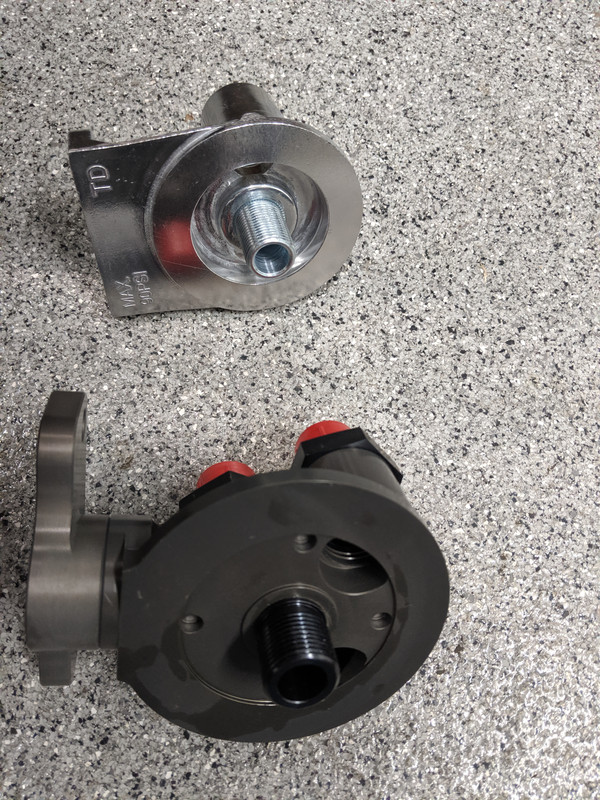

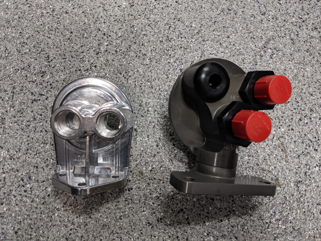

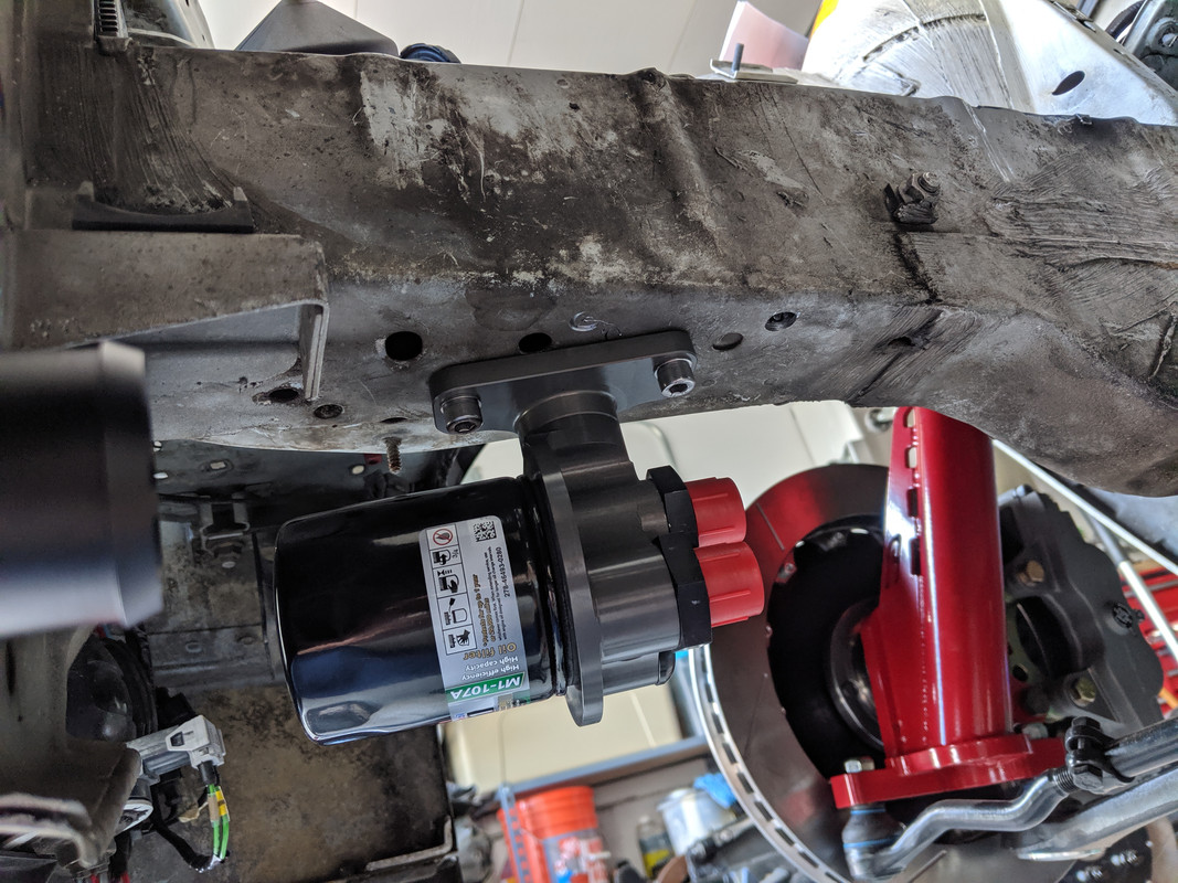

              The Sikky kit came with a remote mount oil filter setup, but it felt and looked a little cheap. I ended up getting a Peterson mount with a 360 degree swivel base to replace it. It's mount it up under the front frame rail right behind the front valance.

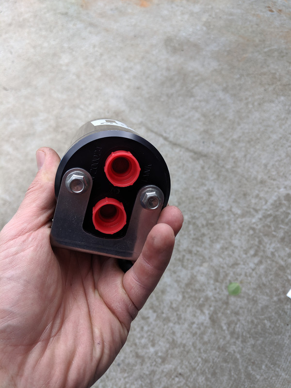

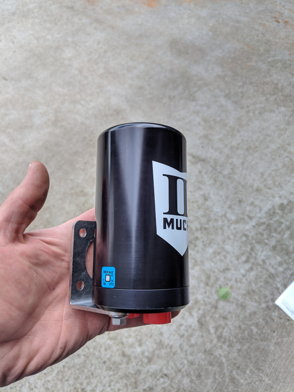

              Next item was the fuel vapor vent canister. The unit is from II Much. It has -6 port for the line from the fuel tank, and a -6 bronze filter for the vent side. There happened to be a vertical bracket where the fuel pump relay use to live, so I made a few holes and bolted it on. You can also see the chase bays power steering reservoir mounted in the stock location.

                Are you running those new accel ceramic booted wires? I picked a set of those up for my trans am, haven't put them on yet though.
                Your swap looks great, any reason you didn't mount the filter in a spot to keep it vertical?

                  They are the ceramic booted wires. I'm a little annoyed with how sloppy the long angled boots make the wire routing, but I'll run them for now.
                  The filter mounting came down to packaging. I wanted it out of sight and in a place where I could easily route hoses to. I also need to allow room for the headers to be placed. It was the most convenient spot I could find.

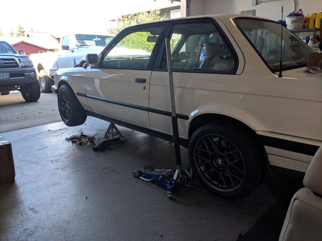

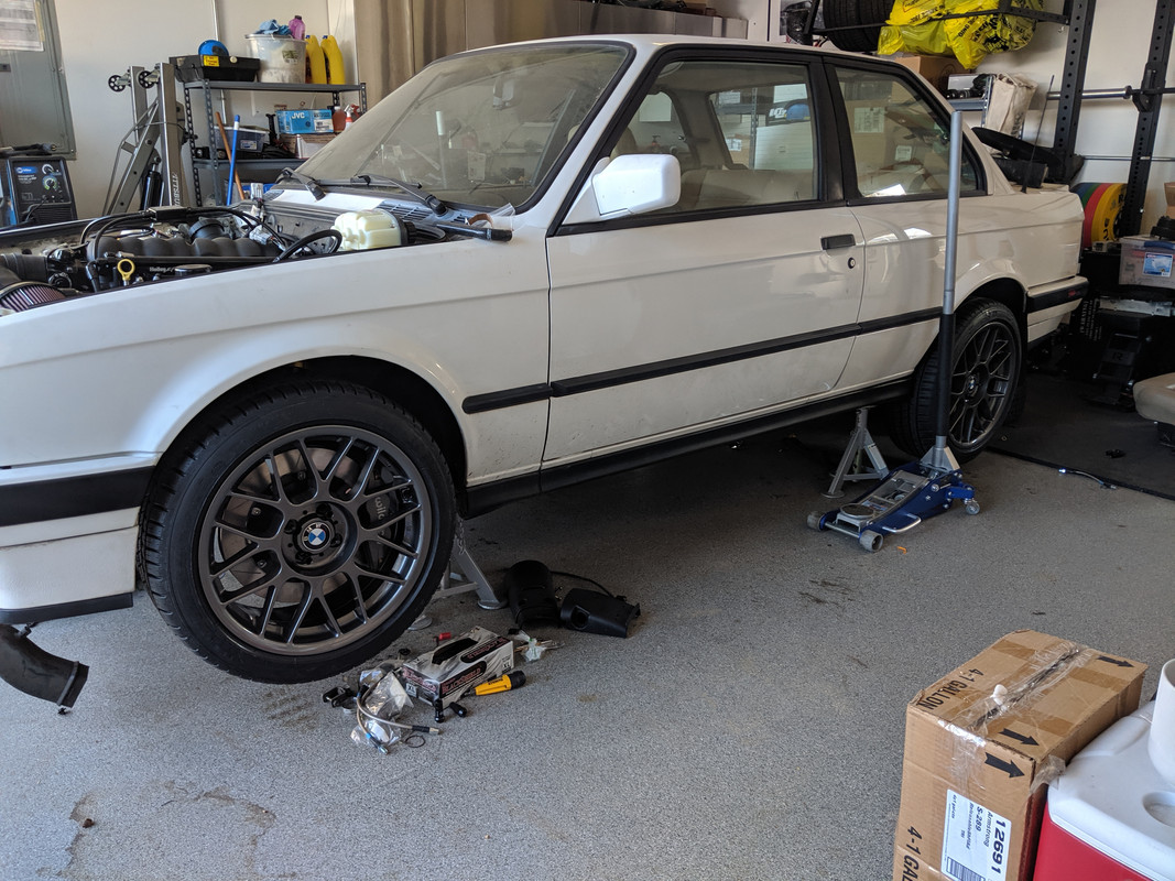

                    I've been traveling non-stop for work, so progress has been pretty much at a stand still. I took half of July off, so hopefully some more progress can be made.
                    I did get wheels and tires delivered and mounted. The Arc-8s cleared the brakes, but were almost touching the struts. I ended up with 8mm spacers in front. Everything looks like it should clear now...

                      Looks good man. Cant wait to hear this thing fire up.

                        Nice brakes!!
                        I love my Wildwoods.

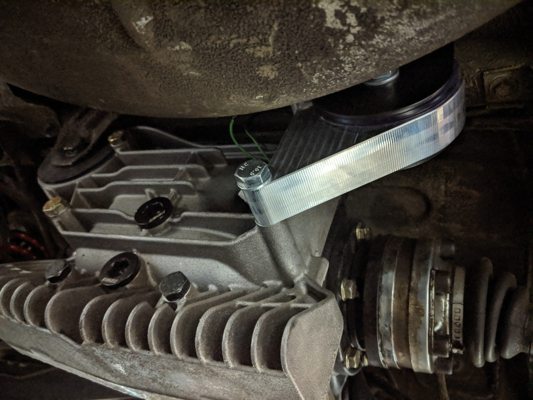

                            #43
                            Good to hear positive feedback on the Wilwoods. I foresee much fussing with the manual brake setup to get everything playing nicely...

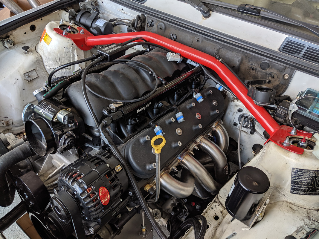

                            I started in on the car this weekend.

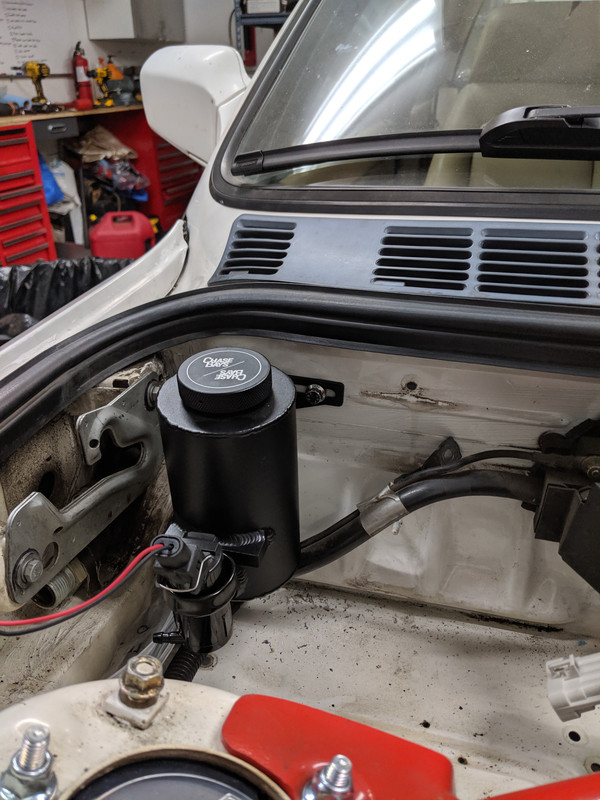

                            Modified the core support for radiator cap clearance and radiator overflow mounting. After I clearanced everything, I went back and put panel bond between the sections where spot welds were removed.
                            Installed the washer fluid reservoir. Its pretty diminutive, but it should get me by. I'll just have to keep up on topping it off.

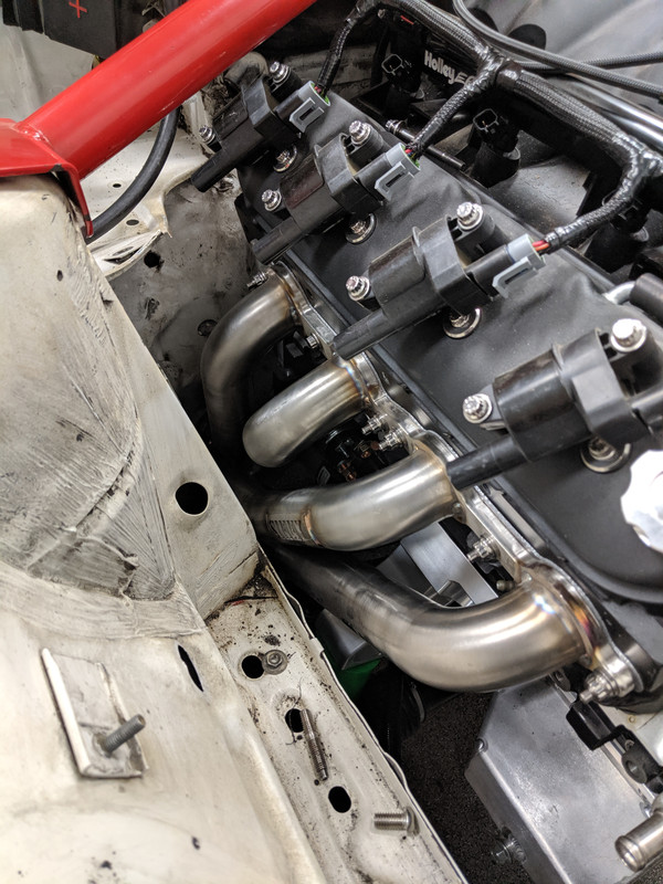

                            Got the headers installed. In order to get them in, I had to balance the motor/trans assembly on a couple of jacks and pull out the motor mounts. This allowed me to rock everything side to side to get them in.
                            I also installed the secondary diff mount. This turned out to be more annoying than I had anticipated. The clearance between the Z3 diff cover and the spare tire well didn't allow for removal of one of the diff cover bolts. I had to drop the diff to do the install. There was also little-to-no room for drill bit access. Oh well ... it's in and ready to go.
                            • Pootis
                              • 636
                              #44
                              I feel your pain on the headers mine were a paint to get in

                                Looks like it’s coming along nicely, I’m going to steal the chasebay washer mounting location I’m ordering one for mine shortly
