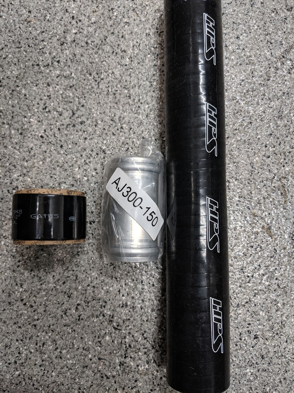

                                Originally posted by z28
                                Nice, I was thinking of getting the same radiator and some hood pins. Please get some good pics of the hood pin setup. What kind of hoses are you gonna go with?
                                I'm cobbling together my radiator hoses with HPS silicon bends, aluminum internal couplers, and Gates heat shrink clamps. It's been a bit of a pain, and they will probably end up being the worlds most expensive radiator hoses. I'm hoping they work out. I plan to have them completed this weekend.
                                I took a quick look at the hood pins and noticed an unused hole in the core support that is the perfect size for the bolt. Fingers crossed it doesn't land in a weird spot on the hood. I'm lazy, and not drilling a set of holes would make me very happy. Here are a few quick images. The last one showing how much articulation the ball and socket design allows on these hood pins.
