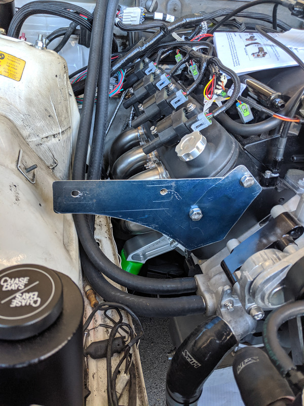

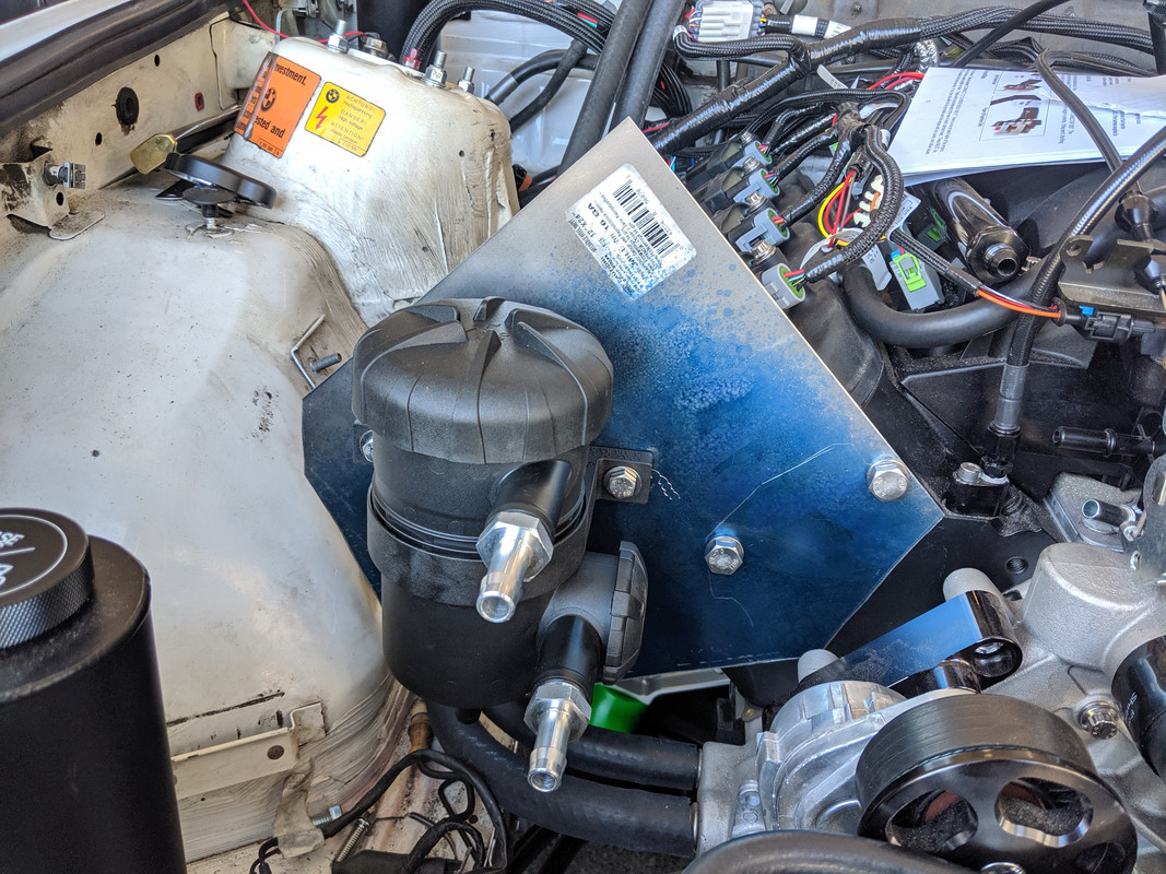

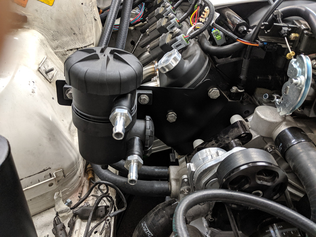

                      #55
                      I have a long term plan to mount the pcv breather. I'll be getting a license for Creo through work soon. The plan is to design a nice solid mounting bracket that I'll either print or have machined. In the interim, I made a quick and dirty mount to keep things moving.
