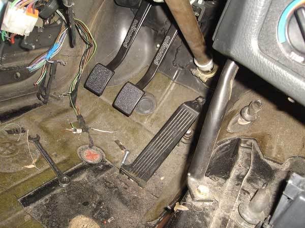

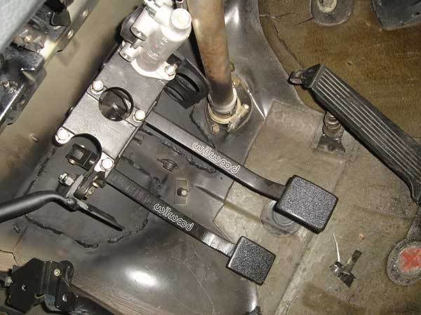

            I got the pedals.

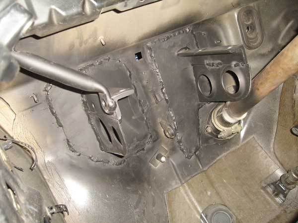

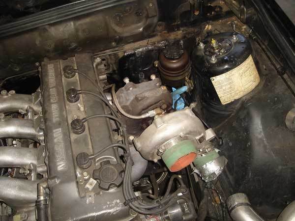

            A custom bracket was made, then reinforced and then welded up to the firewall. Firewalls arn't flat so this is not really that easy.

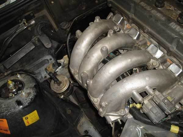

            Funny enough the stock BMW banjo from the highpressure power steering line fits reasonably well over the KA24DE PS pump (needed to be drilled out slightly) with some crushwashers.

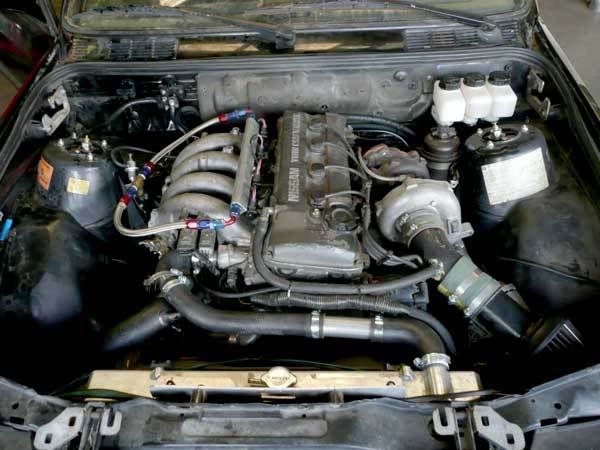

                                It runs. Right now its rigged up just to see if it runs or not. I still haven't cleaned up the engine bay yet.

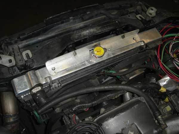

                                SWITCH RADIATORS(Neck on the left side instead of right & ditch the ghetto hose)

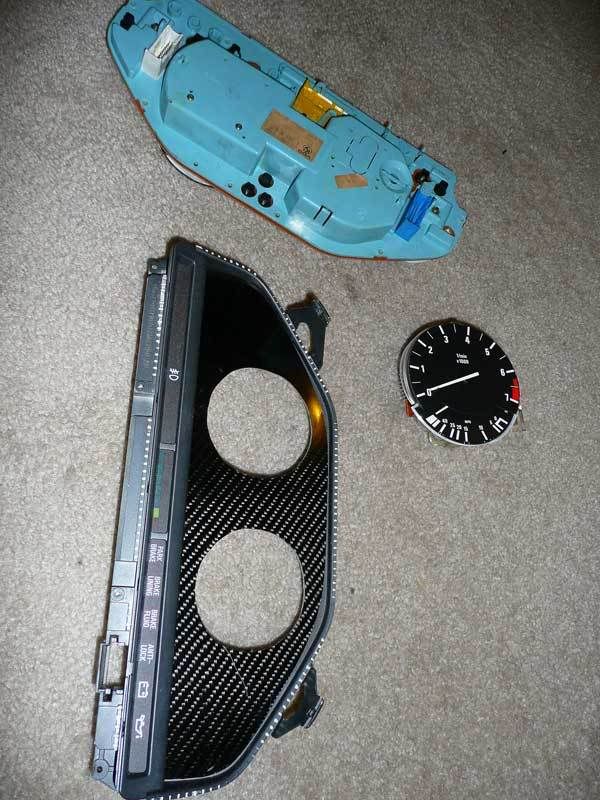

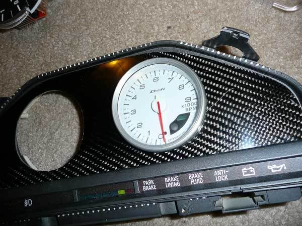

                                I built a new cluster since I won't be using any of the stock BMW sensors or even ECU. There is a Defi HUD for my speedo, water temp, oil temp, & oil pressure.
                                I borrowed my roommates white face tach to test. The unit is actually finished with black face 92mm tach and boost. I also borrowed the carbon from a hood. ;)
