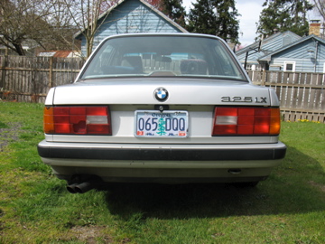

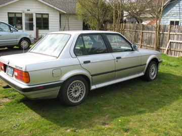

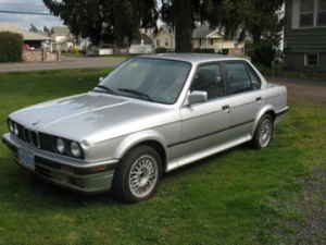

    New E30 325ix got ideas
    i got a new e30 325ix just recently for $3000 i sold my Honda to get it. it needs new front shocks but other than that not much what do you guys think i should do with this I'm open for ideas.....

            NICE! Definitely PM Neil (TurboRefriculator). His car is the one pictured. I'm sure he can steer you in the right direction as he has learned quite a bit about the IX. Enjoy it, they are awesome cars!

                          Awesome car take care of it! That silver Ix have blacked out lights to give it that look? And lowered with what?
