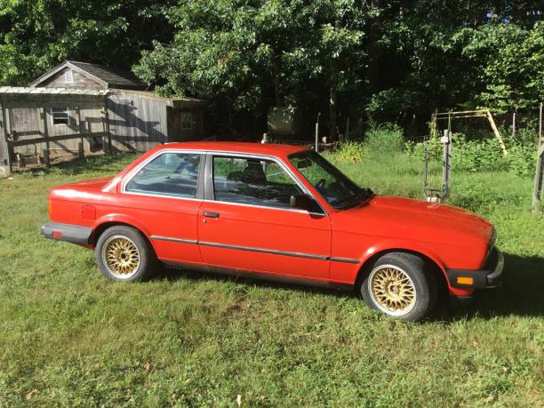

                  After getting redirected to complete some “high priority” honey-do home project over the last month, I was able to get back to the car and complete reassembly of the last few components. The car’s last state inspection was in 2007. So last Friday, with fingers crossed, I took it in for an inspection and it passed. There were still a few gremlins to address (intermittently functioning speedometer and a drivers window that lowers but won’t raise) and some sorting of the adjustable shocks. I notice that the clutch slips if I gun the engine climbing a hill, which is a problem since I live at the top of a hill.
                  So after some work I now have a speedometer that works most of the time. Still need to replace the melted odometer gears. I pulled the door card, window and window track and cleaned and lubed it. I bought a $12 switch and it functions like new. The HVAC fan only worked on high, so I bought a new fan resistor. Once it arrived I opened the access panel in the engine compartment and cleaned out a massive rodent nest. Turns out the replacement resistor was cars manufactured from 9/84 and wasn’t going to work with my 8/84 manufactured 318i. So I sprayed the old resistor with electrical contact cleaner and compressed air and reinstalled it. Success.
                  Today I had a chance to try and clean up the car some. I don’t want to get too aggressive so I did a little work by hand. Not too bad for a 36 year old. I have a new clutch kit and will try to attack it in the next few weeks. Right now I just want to get a few summer drives in.
