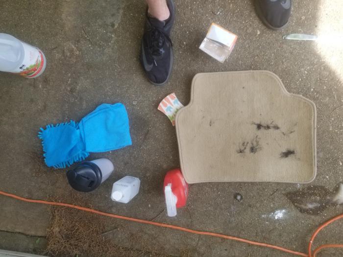

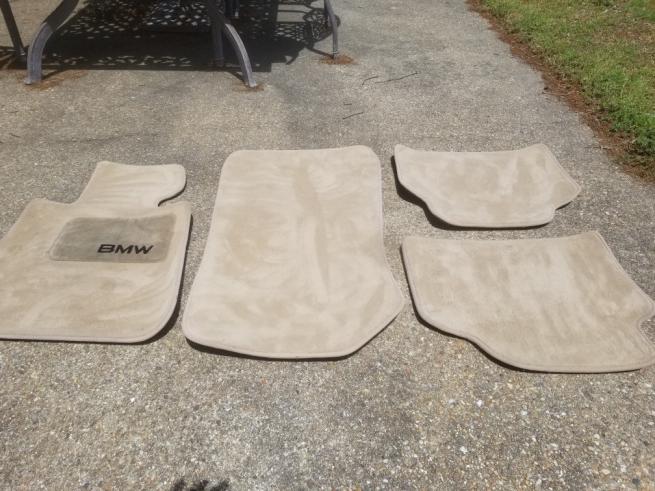

      Took advantage of the nice weather and pulled the floormats out and gave the carpet and mats a good cleaning. Didnt think of getting many before pics but I'm happy with the way it all turned out. Click image for larger version

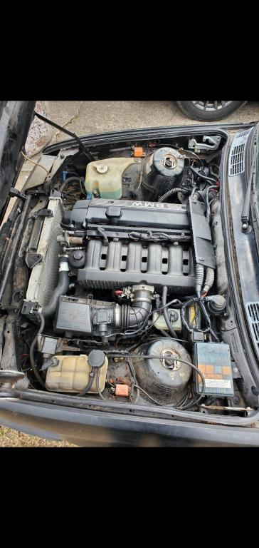

                    After the swap was in and running. I originally had the m20 airbox as my airlifter but opted for a cone filter in the end. Have spent some time trying to tidy up under the hood. Plan on eventually removing ABS and cleaning things up on that side of the bay as well.

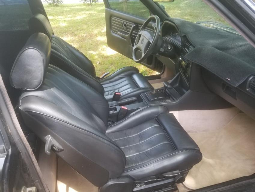

                        For the interior I have fixed some things like the glove box latch, replaced the hood release latch, and replaced the cluster plastic. Replaced the airbag steering, got a stich boots boot, and condor shift knob. Dash capped my straight up CRACKED dash.
                        Picked up a set of black OEM floor mats, and some black footwell speaker covers. I am eventually trying to transition everything over to black on the interior.
