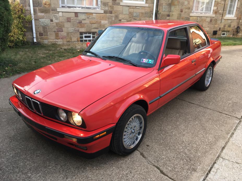

    I've had a bunch of people ask me to make one of these threads, so here goes.
    Background:
    I've spent the last 4 years traveling the world, living out of a backpack. In early 2020, I was looking to move overseas permanently and had $30k saved to make the move. 2 days before my flight, all international flights were canceled indefinitely due to Covid. I knew lockdown would be more than 2 weeks, so I decided to pick up a good driver's car instead.
    I knew I wanted something analog and fun, and eventually knocked my list down to an E30 318is, a 944 S2, or a Miata. Since I wanted a car that could still do car things, that knocked the Miata off the list. And I happened to find a good E30 before a good 944.
    I bought this car April 1st 2020 with 95,6XX (correct) miles and zero rust. The cylinder head was cracked, the tach was wrong, and the exhaust was soaked with oil. But overall, it ran okay. The engine was kind of glued together with silicone, so I didn't know about the cylinder head at first. It had a wood shift knob but was otherwise totally stock. The car was owned by a doctor in Charleston, South Carolina, and left in storage from 2002 until I bought it. Upon taking it out of storage, I drove it home 1,915 miles with zero preparation.

      Looks great! That cluster is super cool. Any shots of the interior?
      • Vantablack
        • Feb 2020
        • 30
        The interior is mint perfect but I hate it. It's that weird 20 years of nicotine stained walls color, and the pleather turned alligator skin material. I will take some pictures this week.
        There's one exception- I was reading about solitions for the cracked dash somewhere, and I saw a forum post that said something like "it's not a real E30 unless the dash is cracked". And I kind of like that, so I might just leave it that way as a sign of affection.
